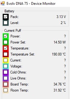

alfie Posted August 13, 2016 Author Report Posted August 13, 2016 Hi allI noticed my device is taking my battery down to 3.1V - my understanding was that it's a bad idea to take it below 3.2V. First question..... is that correct?second question..... (assuming draining it this low is a bad idea) how do I prevent it from draining so far?I can see there is a soft cut of and the device came with this set at 2.75v; i thought this was more to do with battery sag when firing rather than the point when it will stop working altogether.Any ideas please?Thank

alfie Posted August 13, 2016 Author Report Posted August 13, 2016 it drains whilst in use. I haven't looked to see if it goes even lower while not being usedthat screenshot was while idlingI'm not sure how that is relevant to whether draining an 18650 is harmful to it or not - but I'm happy to answer questions that might get us there

dwcraig1 Posted August 13, 2016 Report Posted August 13, 2016 In EScribe under the screen tab you can set it to show pack voltage.Perhaps increase your cell soft cut off.
alfie Posted August 13, 2016 Author Report Posted August 13, 2016 I let it charge a bit and then played aroundseems I have to set the soft cut off to 3.1 to prevent it going below 3.2 when idling.I'm hoping that doesn't cause too many problems.the only other alternative is to monitor it to see what percentage charge equates to 3.2 and keep an eye on that reading.thanks for your input - it's gratefully received
