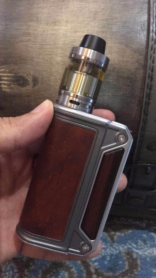

meso Posted September 9, 2016 Author Report Posted September 9, 2016 HelloThank beginningI have some questions :1. How to tell two updated through the device ?2. Is it possible to know the power voltage ? and how's that ?3. preferred battery of the device ?Is it possible to upgrade the machine for more than 75 watts ?Knowing that it is two : DN75 And you Thanks again
awsum140 Posted September 10, 2016 Report Posted September 10, 2016 I'll give these a try -1. To find the version use eScribe software on a PC with the device connected to the PC, of course.2. To find the voltage, current and every statistic you could ever want from a mod use Device Monitor which is a feature of eScribe software. Realtime graphing of all parameters. Inside eScribe you can customize the device to display power, voltage, current and so on.3. I stick to good, name brand, batteries that are capable of at least 25 amp continuous output. In reality, a 10 amp battery can work IF you don't push the mod over 30 watts or so. Personally, I use LG HD2 batteries in my DNA75s and get reasonable time between charges from them.4. The chipset is limited and can't go beyond 75 watts. I really don't believe a mod that is initially designed to max at a specific power can be modified through firmware to produce more power than the components on the board, doing the work, are capable of producing.
