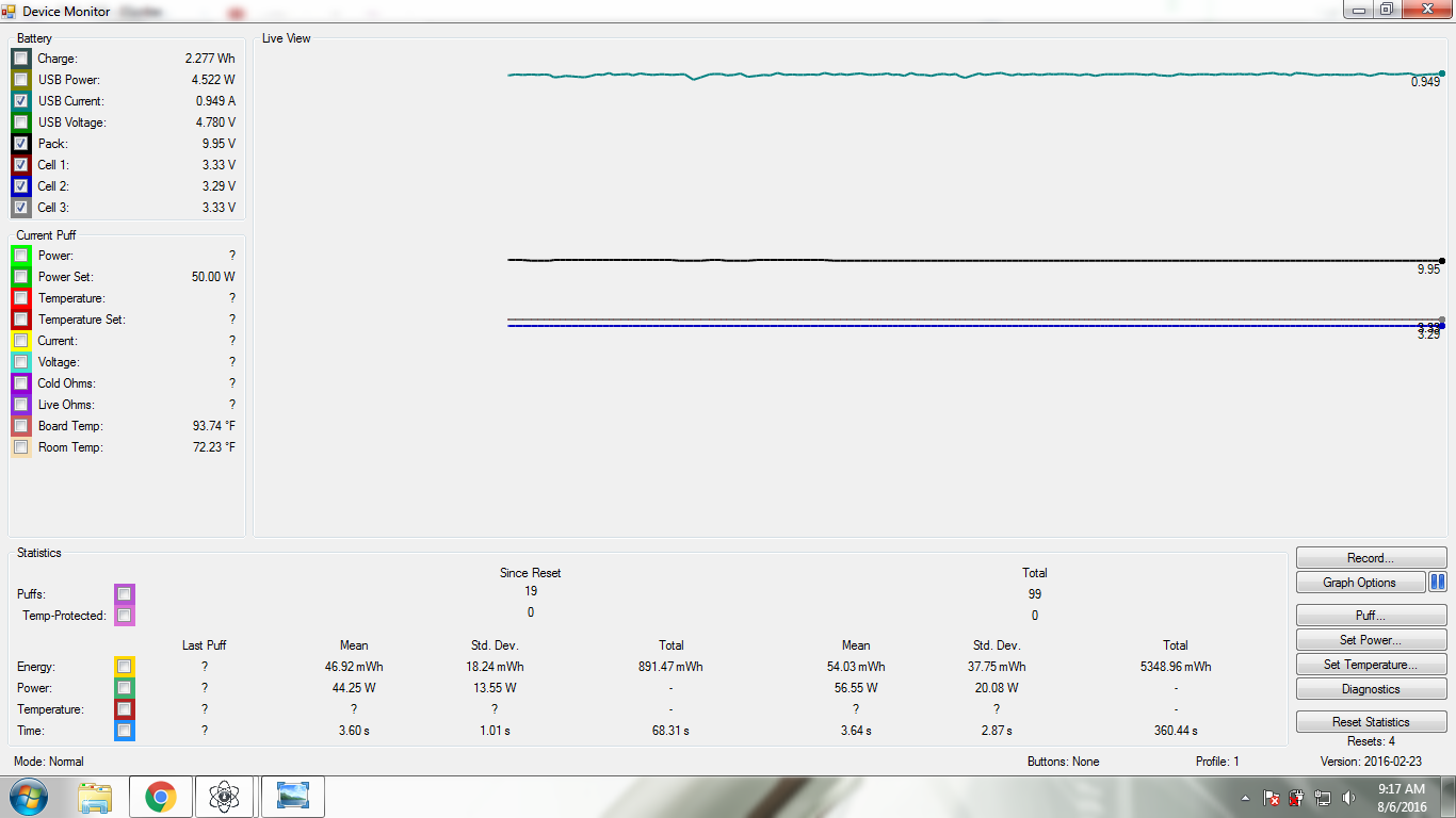

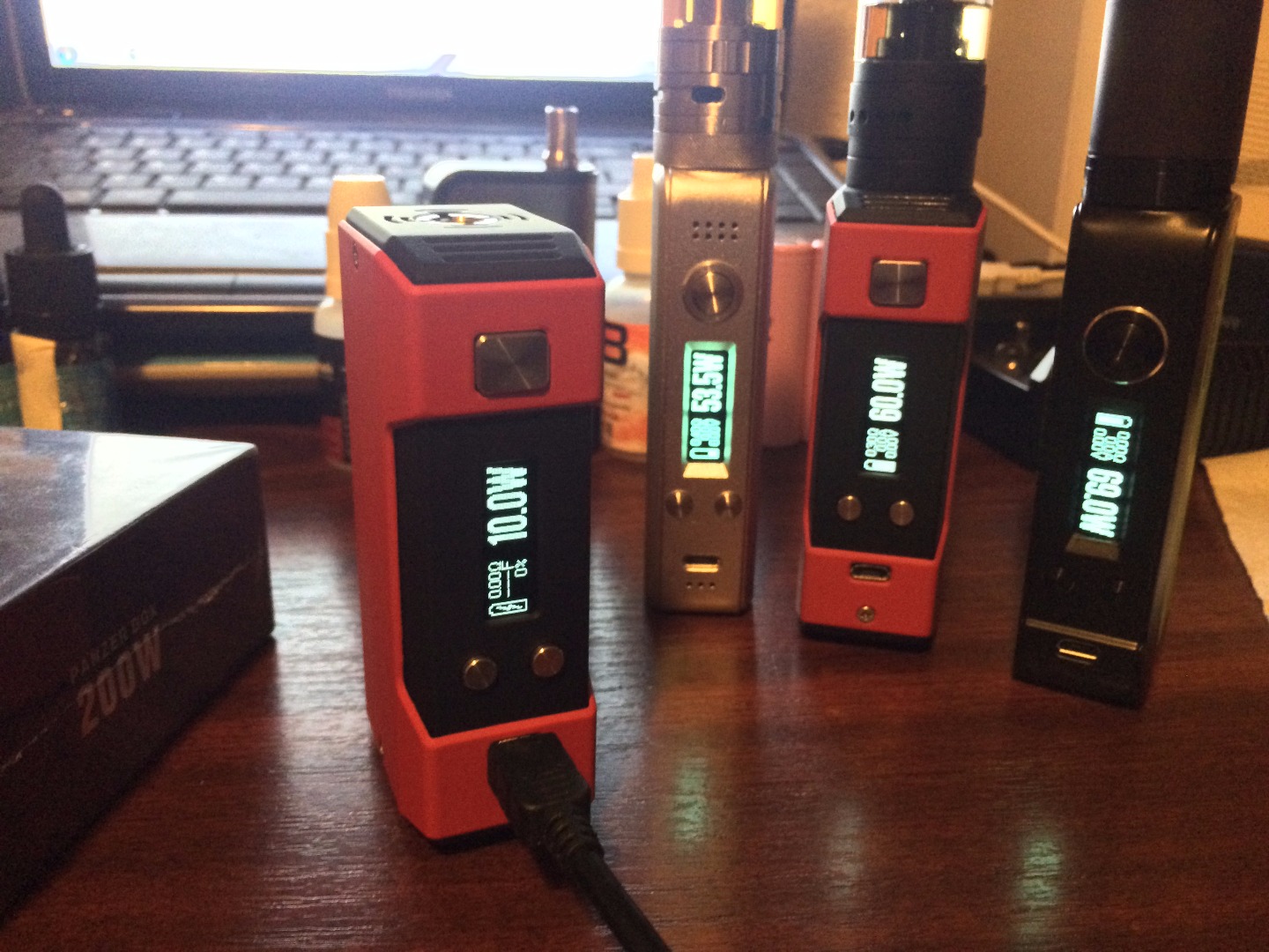

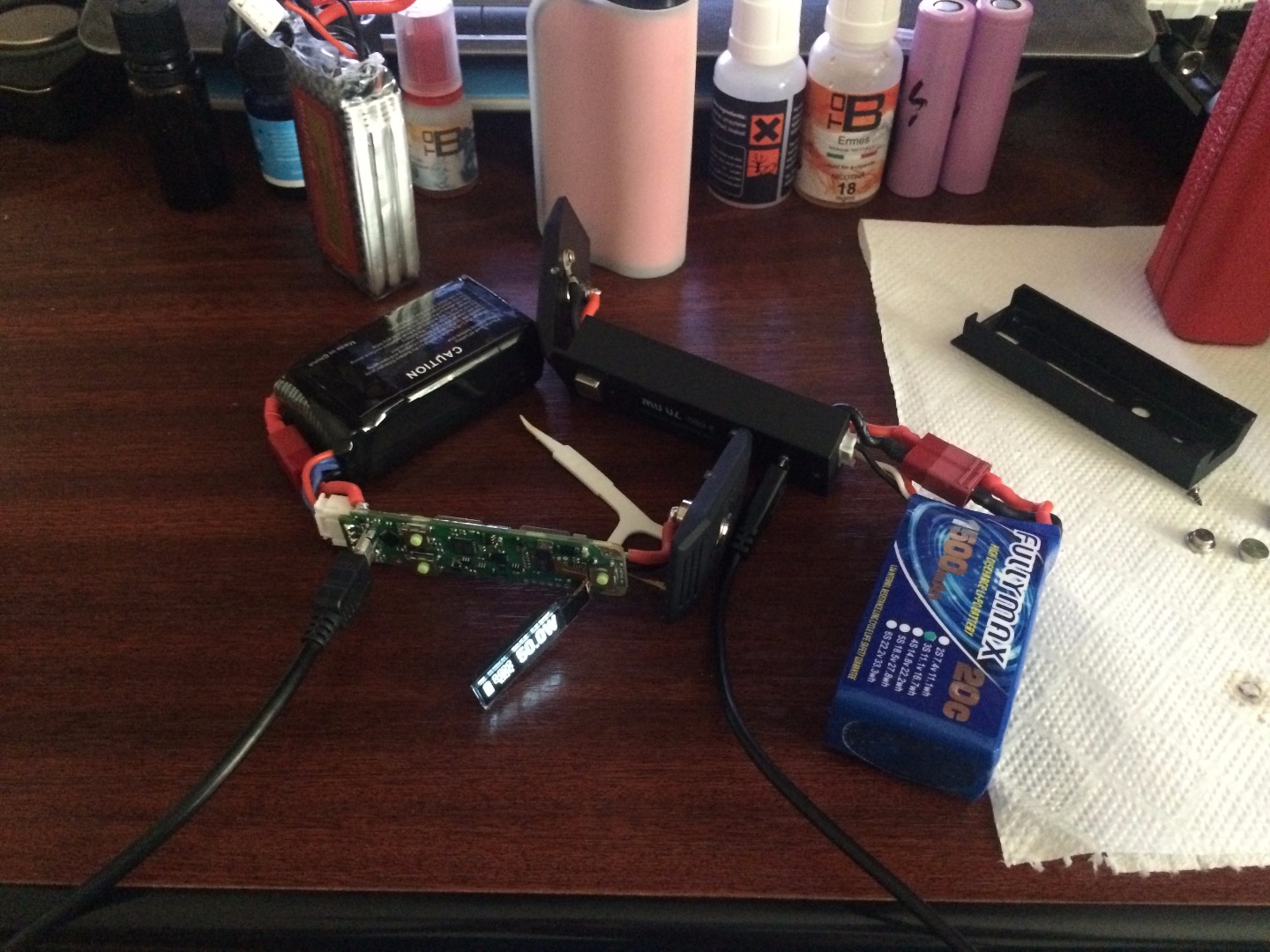

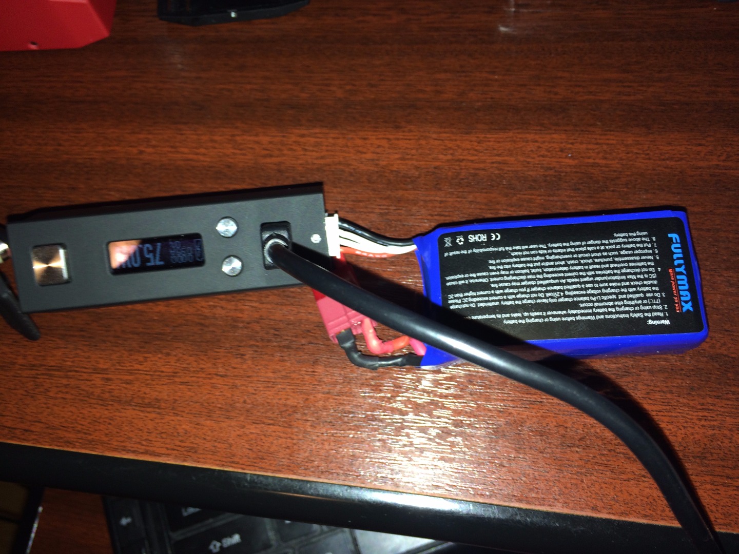

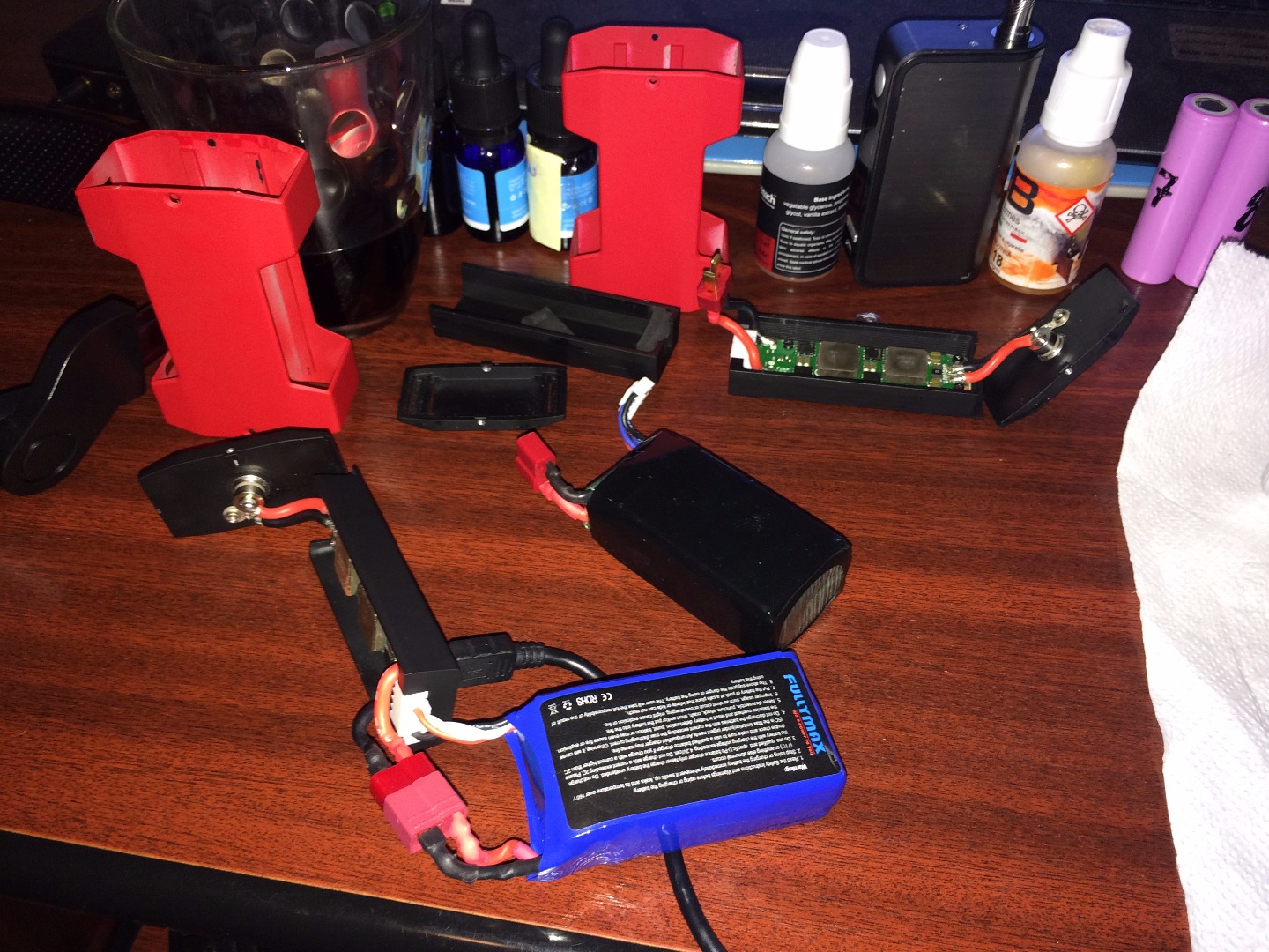

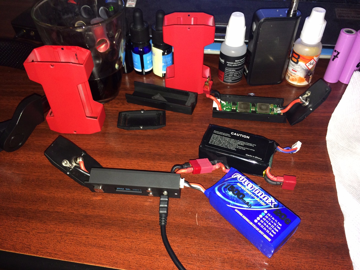

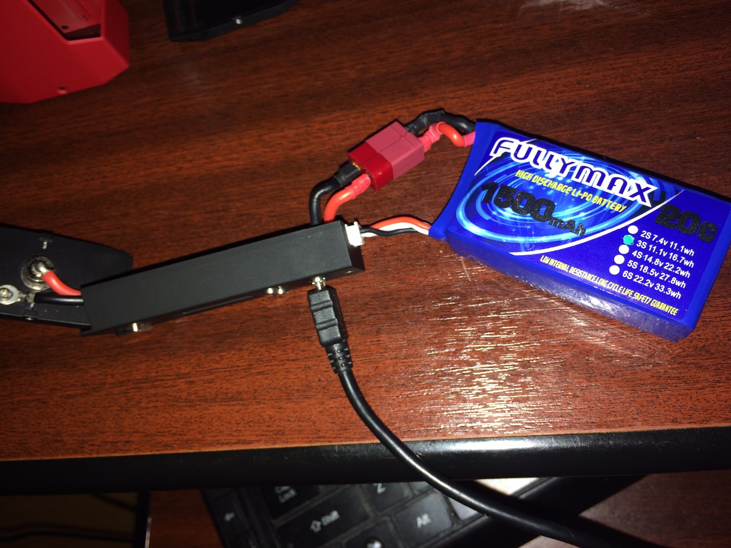

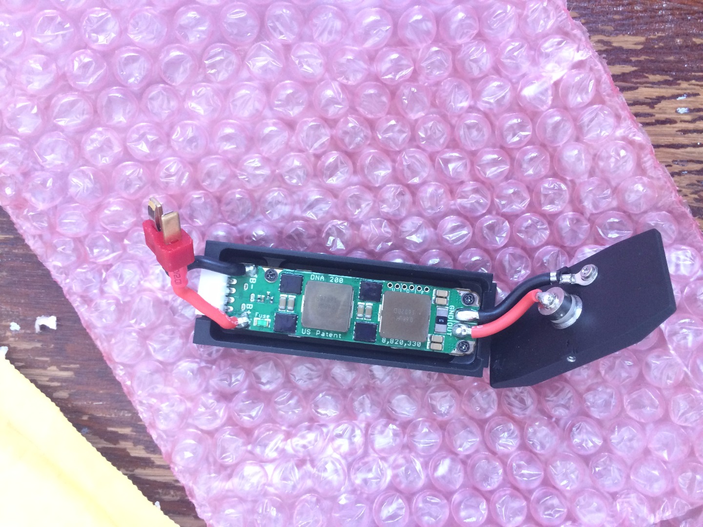

RedLabel Posted August 6, 2016 Author Report Share Posted August 6, 2016 Hello,I bought my second Panzer Box DNA200 from Gearbest with serial VBNGZARWGKVZ of the DNA board.With this second one i have a problem with the board. It doesn`t charging.My first Panzer box came with original Lipo but this second one has a Fullymax 1500mah 3S 20C Lipo.When it arrived, the battery was drained, i tried to charge but nothing. I changed with another Lipo and it doesn`t charge. After that i charged that Lipo on a Lipo charger and is OK now. All my Lipo batteries are OK now.I connected on Escribe and on my laptop USB it shows 0.95A charging but the voltage it is the same. I changed a lot of USB cable, i tried USB recovery charge .... Still the same.... The 3 battery voltage has not increased.I can charge my Lipo batteries only with other DNA board or Lipo chargers.I`m attaching you some photos with the board, Lipo and Escribe device monitor where it shows that is charging 0.95A from a laptop USB (where it should be max 0.5A)Please help me.Thank you. Link to comment Share on other sites More sharing options...

Spector NS5 RD Posted September 2, 2016 Report Share Posted September 2, 2016 can you charge the lipo up with your lipo charger (make sure all 3 cells are fully charged and BALANCED), then take that fully charged lipo, reconnect it to your panzer mod and go into escribe - mod tab- input 16.65 for the watt hour (capacity). make sure it is set to 3 cell/lithium polymer with a cell soft cutoff of no less than 3 volts.....upload to your panzer. vape the mod for while then reconnect to escribe/device monitor and take another screenshot of the mod charging (or not charging). check all boxes under the battery section of DM for the screenshot. Link to comment Share on other sites More sharing options...
RedLabel Posted September 3, 2016 Author Report Share Posted September 3, 2016 Thanks guys ... Eric from Evolv contacted me and helped me with this DNA board ... i sent board to USA for changing it ... now i`m waitting it.Evolv = Great products.... Great services....Great People ! Link to comment Share on other sites More sharing options...
RedLabel Posted September 17, 2016 Author Report Share Posted September 17, 2016 Evolv helped me and changed my DNA200 board!Thank you very much Evolv !!!Great company, great people, great products! Link to comment Share on other sites More sharing options...
