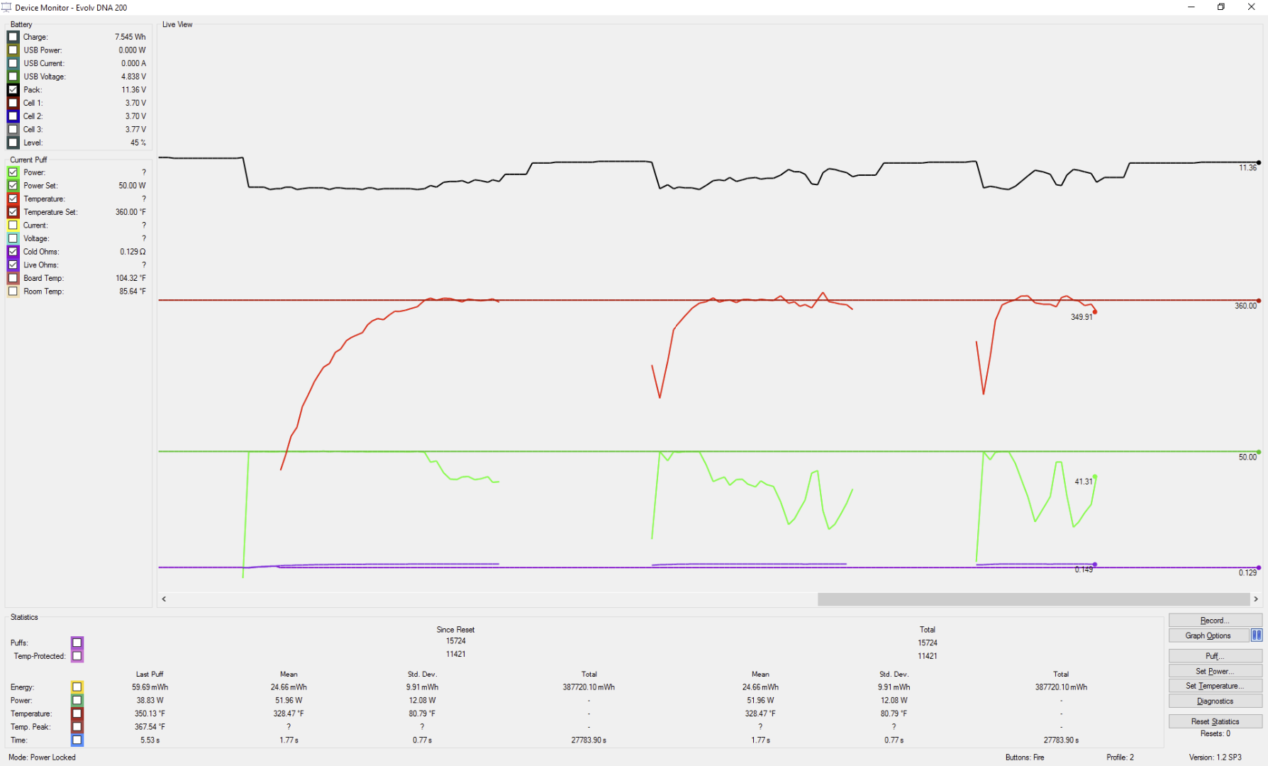

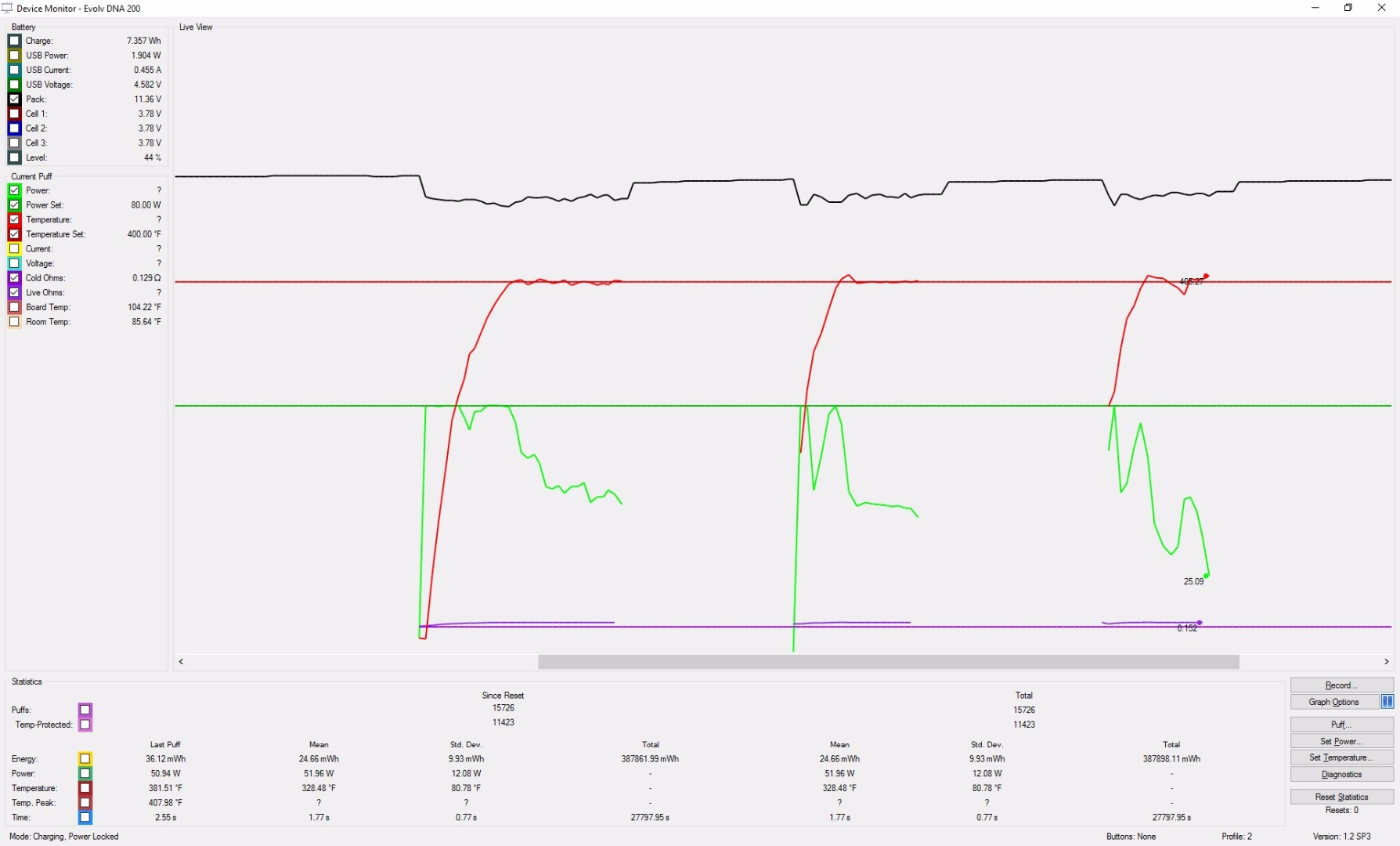

mater546 Posted September 21, 2016 Author Report Posted September 21, 2016 Hi, thank you for the response first of all. so Here is the test, setting the internal to 0.002 and connected I have a dual coil SS 316L reading at rest at 0.130 ohms with wire from advancedvapesupply.com. The 510 on bot the device and the atomizer is clean. I cleaned both with isopropyl alcohol. the profile I'm using is the 316L from steam engine. Temperature set to 350F power 50w, preheat to 40w, punch to 1, time 0s. Then I set the power to 80w and temp to 400F and it was very warm, almost too much. Now maybe there isn't a problem and it's just me, but I never experience such hot vape at 400F.... thank you anyway
