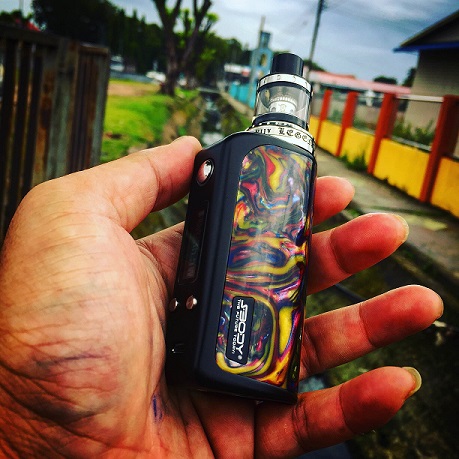

diagonal Posted September 21, 2016 Author Report Posted September 21, 2016 Please excuse my bad Enlisch!I have my first DNA 75 Mod (S-Body Legend).I have brand new 26650 batteries High drain 35A.Setting: Power Mode (Watts) 50W at 0,29Ohm. It does a few moves beautifully. Then very little steam or power when firing. The battery icon flashes when any fires. If I change the Atomizer again it's back ?! Incidentally, regardless of evaporator or how much Ohm.
Spector NS5 RD Posted September 21, 2016 Report Posted September 21, 2016 hi diagonal. sounds to me like the 26650 battery you are using is not strong enough. there is a lot of voltage sag with 26650's. you can see this if you watch in device monitor. either buy a better 26650 or a good 18650 if the sbody legend is designed to be used with both. 26650's are not the best for vaping at 50w or above.
semangka Posted October 8, 2016 Report Posted October 8, 2016 Was having this issue as well on my Legend. front panel at +-button near the micro usb heats up and screen shows Battery Weak. and then the device shutdown itself when the battery power was around 51% left.update your firmware to 2016-06-05 through escribe. there should be a notification asking you to upgrade it, or you can update it by using Tools->Update Firmware. everything settled, problem solved.
