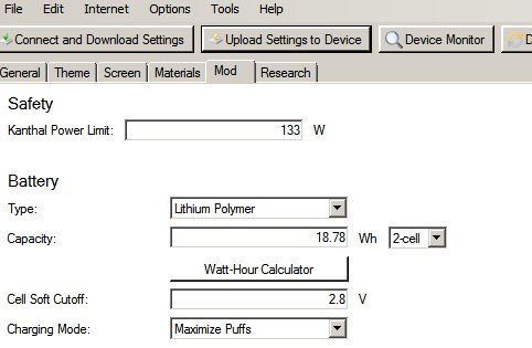

Spector NS5 RD Posted October 9, 2016 Report Share Posted October 9, 2016 welcome to forum Bloppyboy. you need to set the capacity of your batteries into escribe. there is a watt hour calculator you can use to get the calculated capacity of your batts. go into escribe, under the "Mod" tab you'll see these fields...(my screenshot is set up for 2S (just an example) in your situation it would need to be set to "3 cell" for your reuleaux) let's say you're using 3 18650's at 3000mah a piece (3000mah*11.1v/1000=33.3wh's). your watt hours would be 33.3, you would input that value for the "capacity" this should make your battery meter more accurate. the most accurate way is to run "battery analyzer" to acquire the actual usable capacity but using the calculated value is fine. Link to comment Share on other sites More sharing options...
