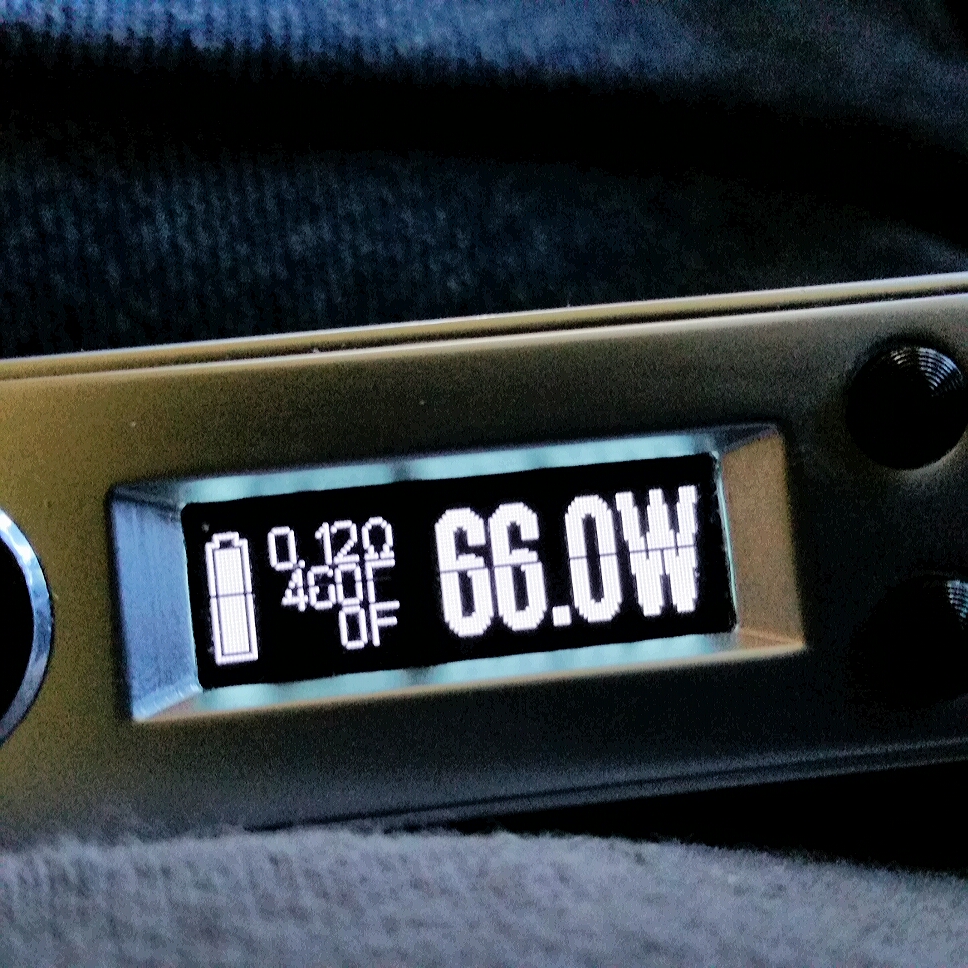

TorturedZen Posted October 21, 2016 Author Report Posted October 21, 2016 Greetings fellow DNAr's. My Hcigar VT133, purchased back in July, has developed this annoying line that spans the entire length of the screen. It has not affected the functionality of the device and appears to be only aesthetic at this point. Has anyone else encountered this anomaly? And is there an easy fix, or am I looking at replacing the display?Thanx in advance!
Spector NS5 RD Posted October 21, 2016 Report Posted October 21, 2016 the ribbon cable could be loose inside the ZIF connector located on the board or the screen itself is damaged and needs to be replaced. you can purchase new OLED screens from evolv and a few other online stores.
TorturedZen Posted October 21, 2016 Author Report Posted October 21, 2016 Thanks for replying. The last time I worked with a ZIF socket was putting CPUs onto PC motherboards. What's the difficulty level should I have to replace the screen?
