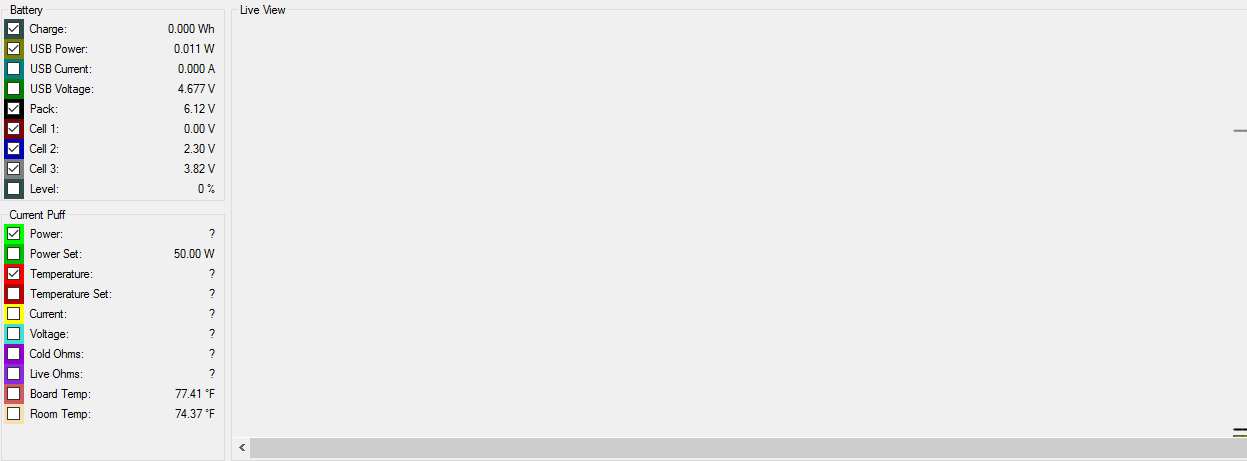

NetworkKingPin Posted November 17, 2016 Author Report Posted November 17, 2016 Got this off a buddy of mine to repair possibly.Here are some details the board looks fine I can add a picture. But here is the Device manager as of now can someone tell me for sure if the battery just needs replaced. I scanned over the Board. As I used to be a Analysis and Repair Tech for BMW circuit boards in radios and the board seems to have no blown fuses like others have suggested. If you need any more details please ask and i will provide the information needed.
VapingBad Posted November 17, 2016 Report Posted November 17, 2016 Just measure the cell voltages via the balance lead, each adjacent pair are one cell, if they match what EScribe says it is the battery.
