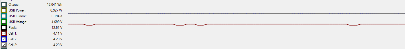

swize82 Posted October 31, 2016 Author Report Posted October 31, 2016 Hey all , my vt200 is not charging fully atm (maxed out at 79%) . USB current is hovering around 0.05-0.06 Amp . Cell 1 (4.20v) Cell 2 (4.02v) Cell 3 (4.20v) . On the device monitor , Cell 2 sometimes has an error flash . I suspect cell 2 is going bad . The battery level seems to drop slowly the longer i charge (now at 75%). Is there anything i can do to rectify this without changing the lipos ? . Thanks All this happened after I updated to sp3.UPDATE : After hard reboot , battery jumped up to 80% . Weird

swize82 Posted November 1, 2016 Author Report Posted November 1, 2016 I left the mod to charge overnight . The charge still maxed out at around 77 - 79 % . Cell 1 & 3 fully charged at 4.20v and Cell 2 at 4.0v and it wouldn't go any higher . looks like i need to change the lipo i guess .
Spector NS5 RD Posted November 1, 2016 Report Posted November 1, 2016 swize82 said:I left the mod to charge overnight . The charge still maxed out at around 77 - 79 % . Cell 1 & 3 fully charged at 4.20v and Cell 2 at 4.0v and it wouldn't go any higher . looks like i need to change the lipo i guess .correct, easiest way to fix your problem would be to replace the lipo. vt200 lipos are still available.here's some links.....http://sweet-vapes.com/hcigar-vt200-replacement-lipo-battery.htmlhttps://www.fasttech.com/product/5088900-authentic-hcigar-vt200-replacement-1300mah-li-powhen you left the mod on charge overnight was there USB current still being drawn? even if it was 0.09 it was trying to balance. you could drain the battery all the way down by vaping then put it back on usb to charge. i have seen that work to correct discrepancies in cell voltages. it could take a few discharges and recharges to get it balanced again, just know that.
