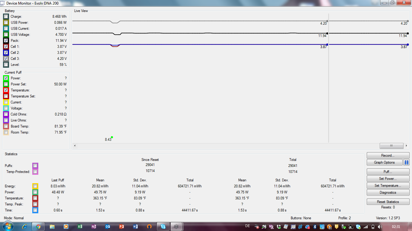

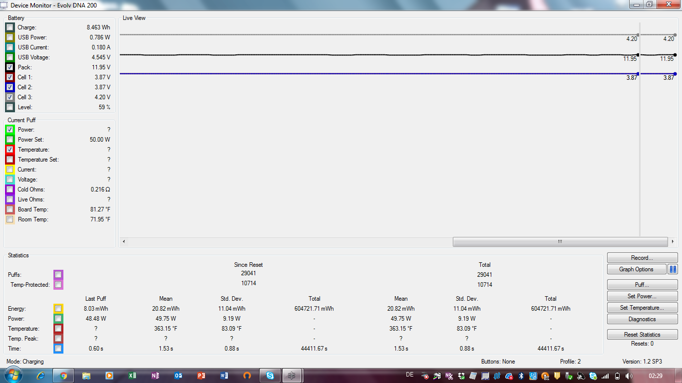

Bandog23 Posted December 24, 2016 Author Report Posted December 24, 2016 Hi folks,I am having a few issues lately with my lavabox. Two months ago i noticed that the cells were inbalanced, not much.A few weeks ago i was not able to charge the battery (Cell 1 and 2 had about =.49V, Cell3 was still at 3,5V). So Battery dead and i got a new Fullymax 900. Within a few hours the same issue. Now i got myself the 1300mah kit and it is not charging it also.Maybe you have an idea how to fix this problem.Bye

Bandog23 Posted December 24, 2016 Author Report Posted December 24, 2016 Hi,I could measure the cells indvidual, till now i was trusting the device monitor.The actual pack is the forth Lipo pak for the last month.In the meanwhile i recognized the board itself has an issue. The question is if it is a minor failure, like fuses or caps i could replace myself or ist it a bigger issue.My Cell soft cutoff is at 3.2VEdit:I have cleaned the DNA200, the balancer connector was quite dirty with black tarnish. Now i am charging the battery and all three cells are charging equally until the highest cell reaches 4.2V.When draining also all three cells are drained equally. This means balancing on my board is not functioning how it should and maybe i could fix it when i drain the highest cell only until it reaches same voltage as the ore two cells.
