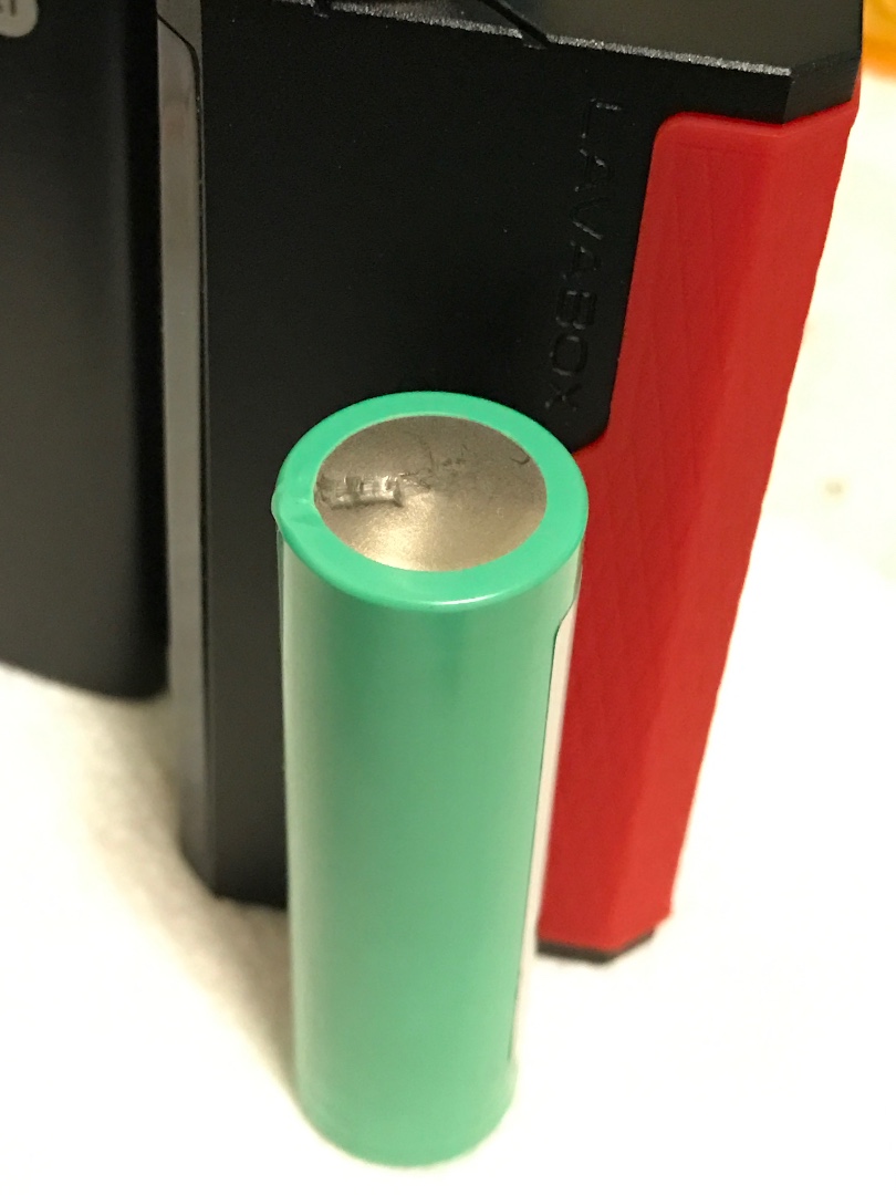

WiSCBlizzard Posted January 4, 2017 Author Report Posted January 4, 2017 Yesterday I purchased my first DNA mod, a Lavabox M DNA75. I purchased 2 genuine Samsung 25r (green) batteries to use in this mod. I noticed that the battery fit very tightly in the battery compartment. This device has a solid positive terminal, and a spring negative terminal. After removing the battery I noticed that there is a slight indentation on the bottom negative terminal of the battery. I'll attach a photo. I'm guessing this isn't normal and I've contacted Volcano and am awaiting response. Is this battery still safe to use? I researched battery sizes, and the 25r (green) has a height of 65.00 +- 0.15. Other battery options:Efest 18650 3000maH Flat top height is 65.02mmLG HG2 3000maH 20A Flat top height is 65.00 +- 0.2mm
Spector NS5 RD Posted January 5, 2017 Report Posted January 5, 2017 if you want to be 100% safe, i would ditch that cell. dents on the bottom of cell are actually more dangerous than dents along the sides, because of the way the cell is manufactured. the layers.
