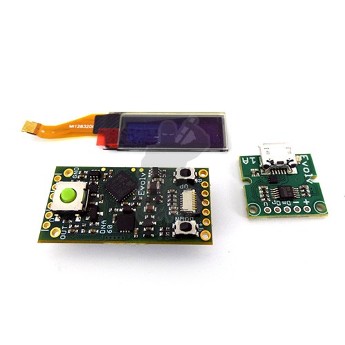

So you have a DNA60 board and the new charge/data board from Evolv?  Compare this picture to your boards.  DNA60 data sheet link also given here so you can see the wiring pin out for the DNA60 board (I think page 11) of the data sheet.
Data sheet:
https://downloads.evolvapor.com/dna60.pdf
Photo of boards:

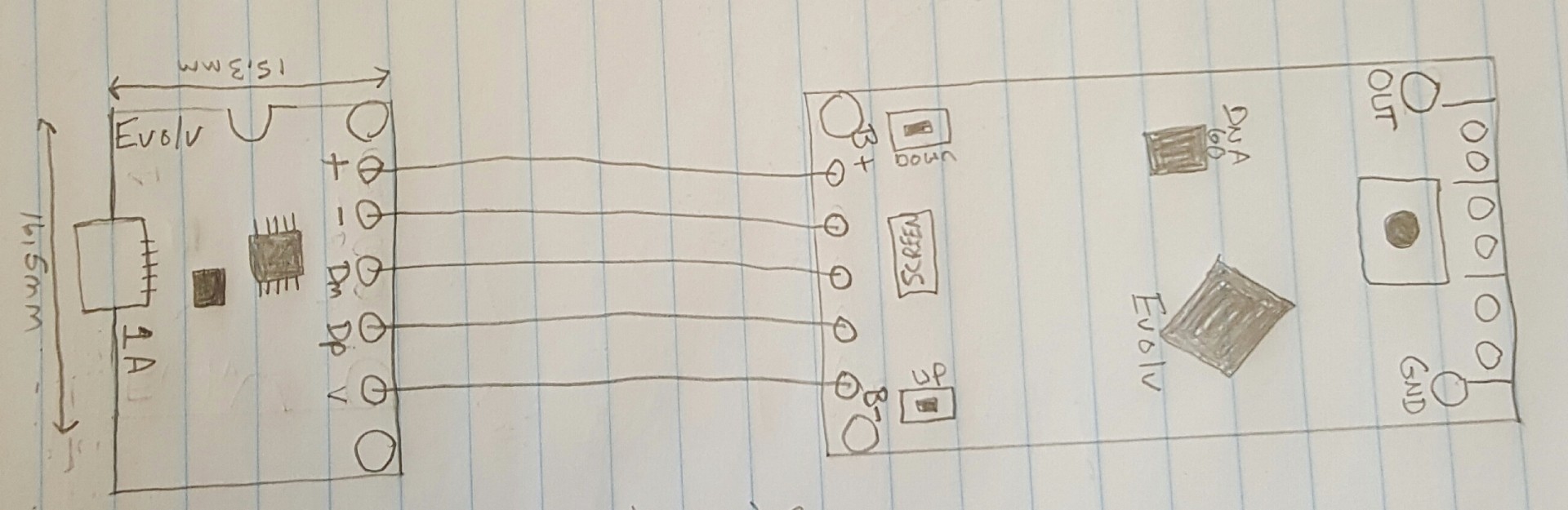

Yes i have this .pdf. What i need is a specific diagram of the USB board with the wiring chart showing the new chip with the PC connection wiring. Preferably a diagram similar to the 60 board diagram that shows a breakdown of each connection . Thanksfor your help.
Posted
I have no diagram but the pdf shows pin numbers on the DNA board (pin numbers 11 thru 15) and tells you what pin on the charger it connects to. The pins are marked on the charge board.  You might just draw your own diagram.
Someone else here may have a diagram...  :)
