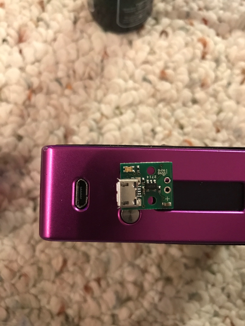

Would this replacement micro USB that I ordered work to fix my lost vape Efusion I doesn't look like it. Is the right shape for my DNA chip my mod isn't the duo or the mini I've have it since April. I think it's past warranty but it also says warranty service on the screen as it's shutting offit might just be the battery or something I don't know

that USB charger you bought will not work with the DNA 200 board. The DNA 200's USB is installed directly onto the main PCB. It's not a separate board. What you have looks to be a 500mah micro USB charging board that was used for the DNA 20 / 30 /40.
Open a repair ticket with Lost Vape's warranty repair center. the link is in the bottom of my signature>>>>>>>
if it still connects to EScribe, you can post a screenshot of device monitor with the battery option boxes ticked.
