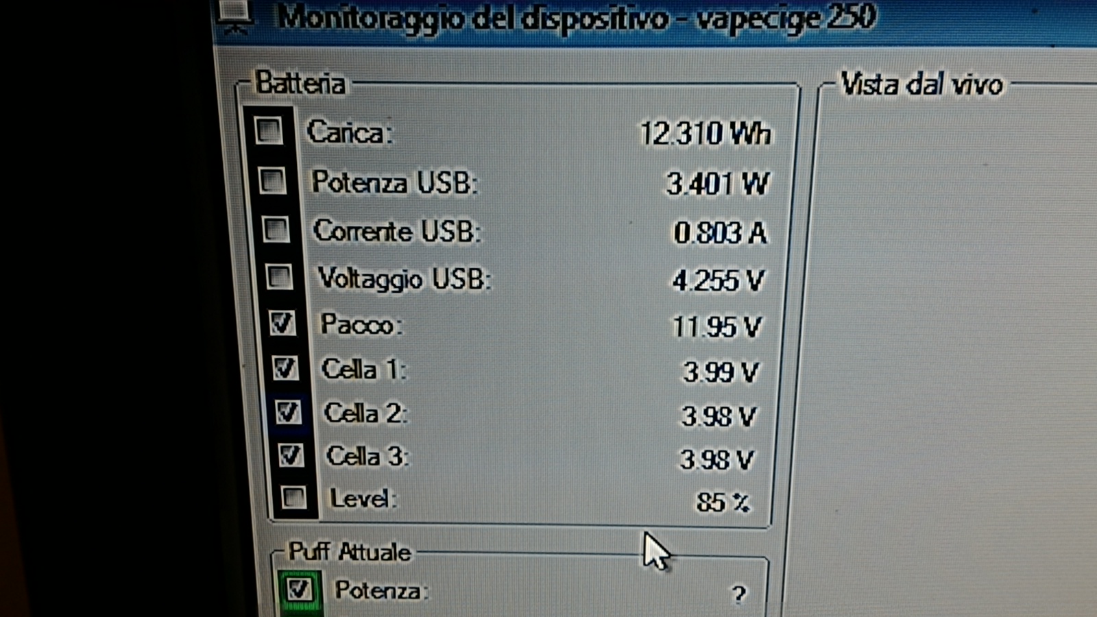

Pekkio82 Posted February 7, 2017 Author Report Posted February 7, 2017 Today, shorted message is here: https://www.dropbox.com/s/xxt8j48muxtd8hz/V_20170207_103007_LL.mp4?dl=0 Connected to escribe, and all come back to normal work, here some screen and csv: Resistance analyzer: https://www.dropbox.com/s/20ji6nvc7dyzkre/V_20170207_111051_LL.mp4?dl=0 Battery and monitor csv on attachments, plus photo on battery values. battery.csvgraph.csv
Spector NS5 RD Posted February 7, 2017 Report Posted February 7, 2017 i would contact the vendor you purchased the VTBox250 from and ask about a return. i doubt it's anything the average user can fix. if the vendor gives you a hard time you can always open a help ticket through Evolv. Evolv may or may not ask you to to send in only the board, for replacement.
Pekkio82 Posted February 7, 2017 Author Report Posted February 7, 2017 @ChunkyButt200 Thanks, for replacement from the vendor it will cost almost as a new mod because of shipping cost, the seller is chinese. I will try something, or contact evolv. Have you noticed something strange in csv files?
