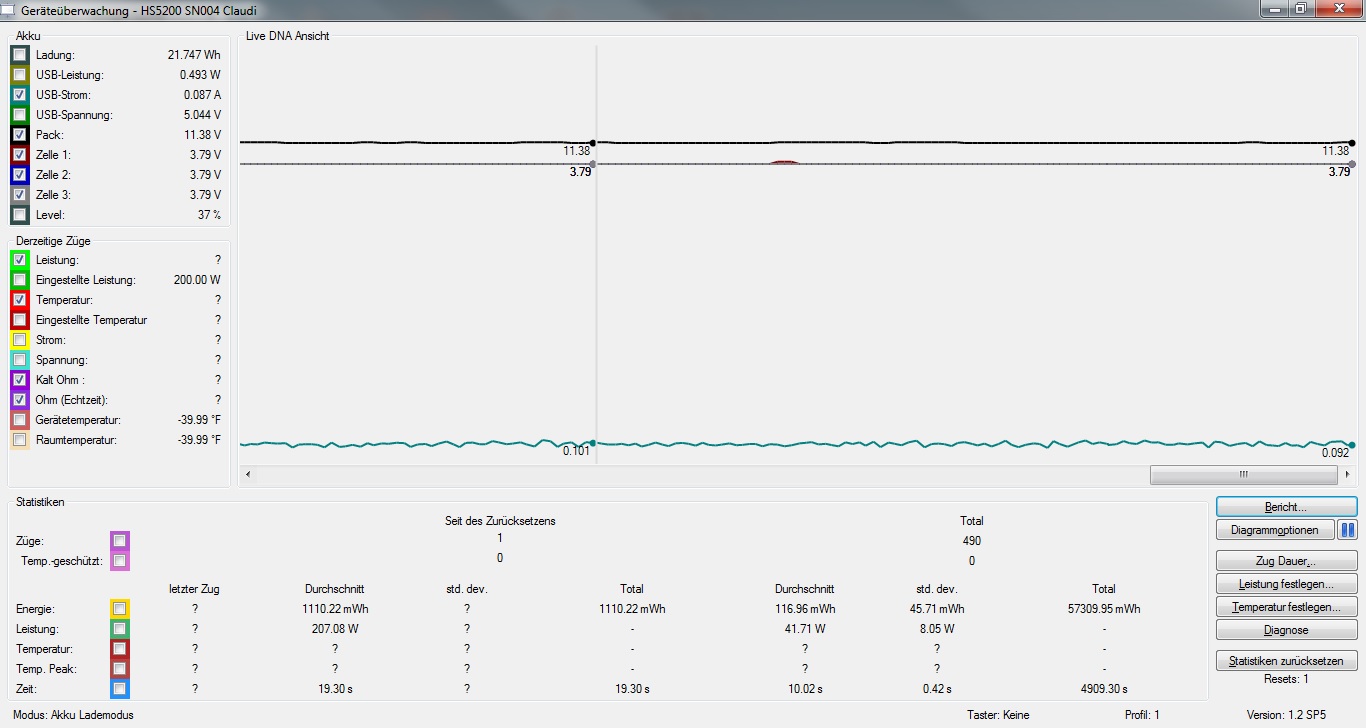

hs107 Posted February 4, 2017 Author Report Posted February 4, 2017 Hello,have a problem on one of my DNA250´s it charge only with 0.1A testet out diffrent Lipo´s, cables and PSU nothing change. Can someone help me?

VapingBad Posted February 5, 2017 Report Posted February 5, 2017 A long shot, is the board temp showing a high value, occasionally the thermistor fails and false high temp reading would reduce charge current.
VapingBad Posted February 7, 2017 Report Posted February 7, 2017 Looks like a bad thermistor unless it is really -40 F where you are, if so the board needs replacing, as it a 250 it will be under warranty.
