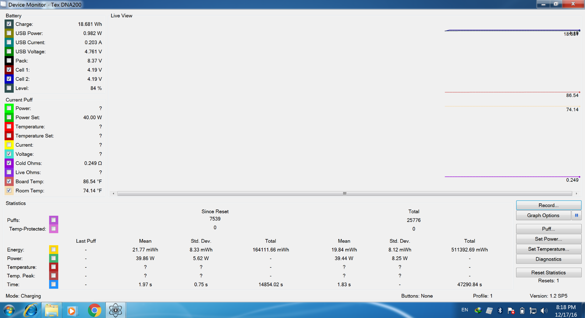

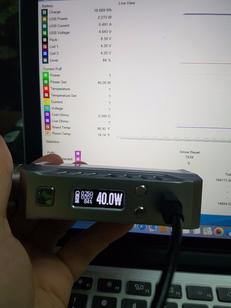

tarekelsakka Posted December 17, 2016 Author Report Posted December 17, 2016 I am using a Finder 133 with DNA200 chip. I have set the correct watt hours and everything but for some reason the battery meter is wrong.As you can see from the screenshots below, both batteries (LGH2) are fully charged but the mod still reads them as 85%.That is probably the first time I've seen this and I have been using this mod for about two weeks now.I charge my batteries using a Nitecore i2 charger (the old 500mAh) one but I sometimes use a Xiaomi Power Bank with an output of 1A when I am on-the-go and my batteries are low.On a side note, I never fire while it is charging because I feel like it is unsafe, so I let it go up to 50 - 60%, for instance, then take the charging cable off and start vaping. Please help because this is truly annoying. Thanks!
dwcraig1 Posted December 17, 2016 Report Posted December 17, 2016 If it were mine I'd lower the watt hours by 15 - 20% and see how that goes, battery performance won't be affected.
tarekelsakka Posted December 17, 2016 Author Report Posted December 17, 2016 I used the calculator and it set it to 22.2 watt hours. What should I set it to then?EDIT: You're right. I lowered it by 10% at first but it read the batteries at 90%, then I lowered by 20% (18watt hours) and now it reads 99% so I am guessing that's the most accurate number, correct?
