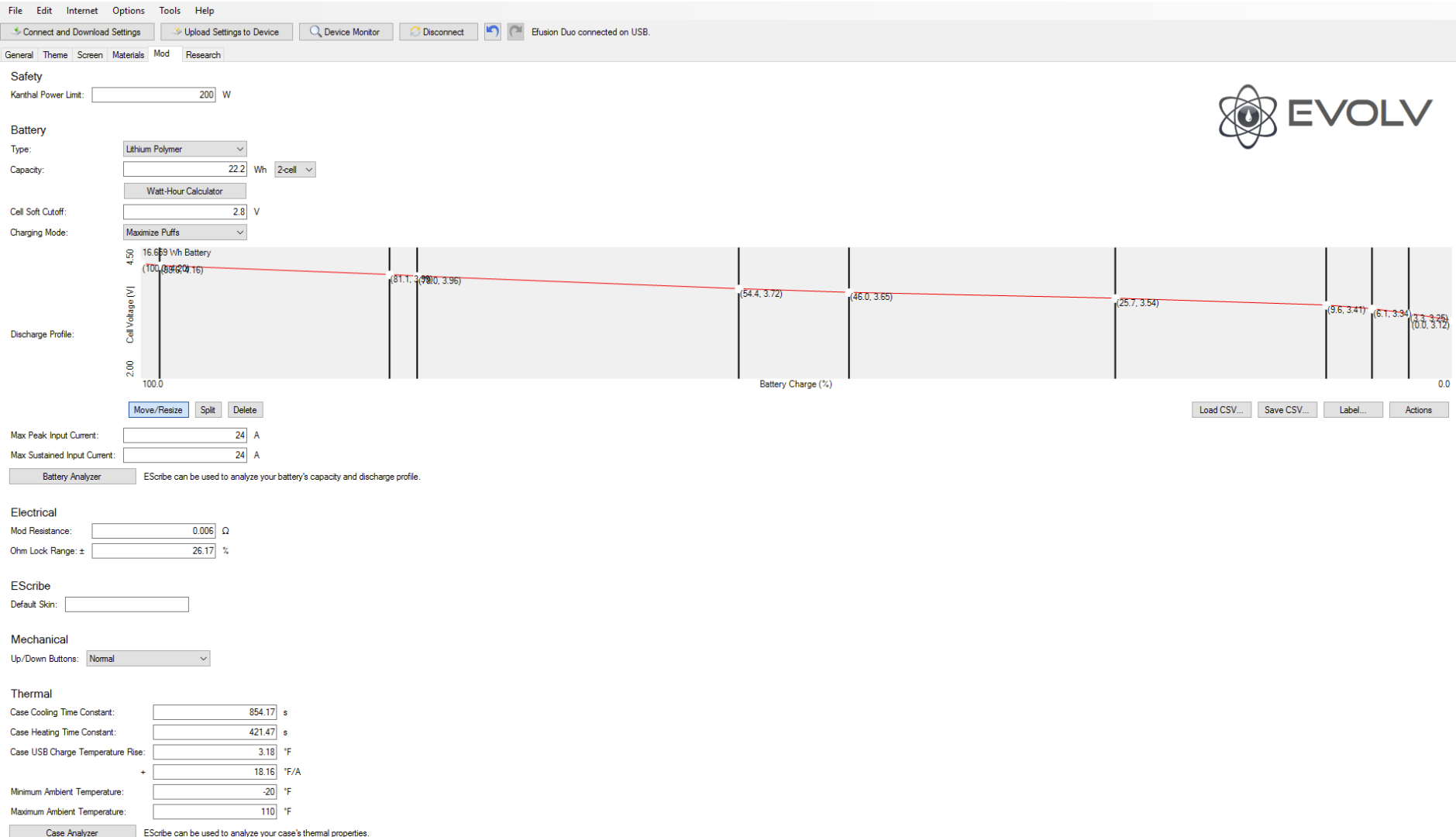

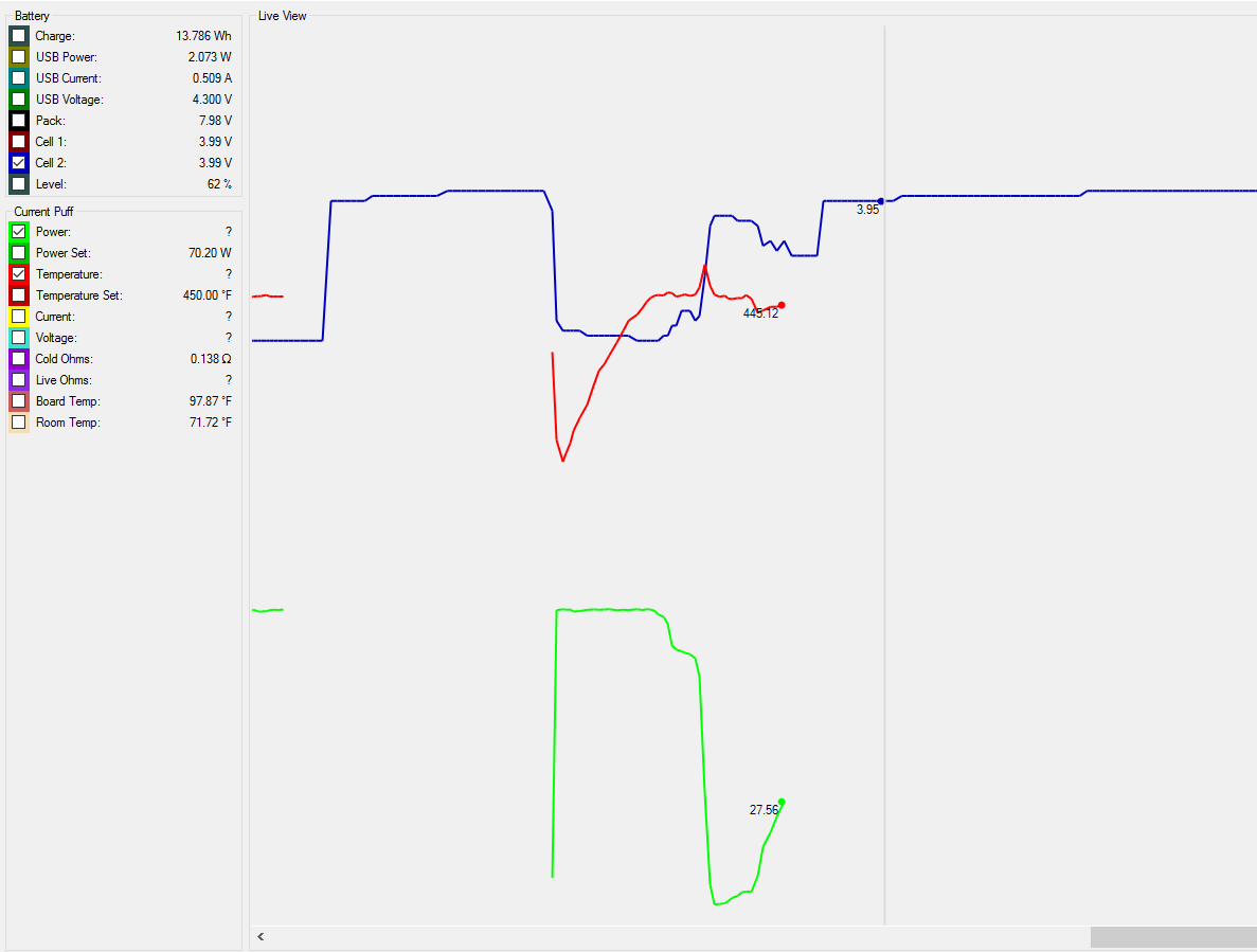

giz_60 Posted March 9, 2017 Report Posted March 9, 2017 First, check all your connection & make sure everything is clean & tight...maybe try the Steam Engine 316L .csv...Edit: Can you post a screen shot of Device Manager while firing? What is your 'Mod Resistance' set at under the 'Mod' tab? SS316L can be a bit tricky if your mod isn't set up properly...Edit Edit: And maybe even a screen shot of your profile settings & 'Mod' tab... as much info as possible is very helpful

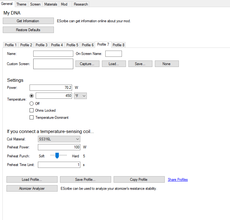

Markez79 Posted March 10, 2017 Author Report Posted March 10, 2017 Many thanks for getting back to me. I have attached some files. Hope these help as im very new to DNA mods - usually use mechancials but wanted to use temp control.Thanks.Mark
giz_60 Posted March 10, 2017 Report Posted March 10, 2017 You have the power in your profile set at 70.20 watts...that is limiting the board to only 70.2 watts...raise that value up to 100 or 150 watts & try again...Edit: The board will throttle back the wattage once it reaches temp...Edit Edit: And if you want to see the temp on the device's display, check the 'Temperature-Dominate' box & be sure to upload to device!!
