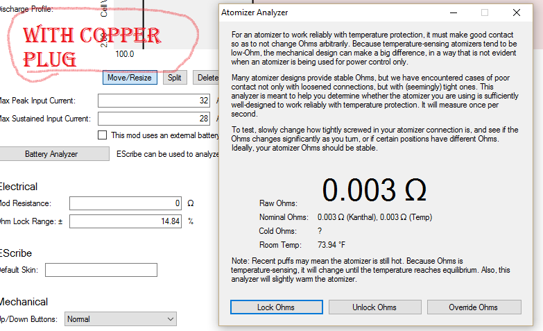

giz_60 Posted March 10, 2017 Report Posted March 10, 2017 Well, I have a Triade & the resistance on it came out to .003Edit: And the Therion 166... .004

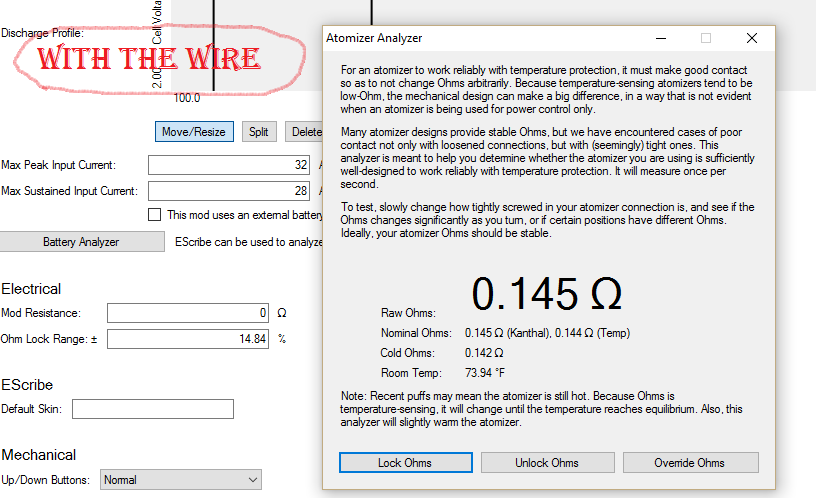

jarred.sayles Posted March 10, 2017 Report Posted March 10, 2017 giz_60 said:Great tool to have...but you are going to probably going to have an issue on the 250...IIRC, they don't read dead short below .007...found a quazi work around for it...you can read about it here...https://forum.evolvapor.com/topic/65594-topic/?do=findComment&comment=886264....starts on page 5, post #75 on...basically you set your mod resistance to 0 & upload to device. Install a coil of know resistance, pulse the fire button to set the resistance in the device & then run the analyzer...you will probably have to let the coil cool for a bit first...and it will help if you set you pre-heat, power, etc. as low as possible to prevent the coil from getting to warm...not an exact science, but it works...you will see in the photosGot to thinking. If I use the copper tool before updating the software it should work right? I haven't updated since February 2016.

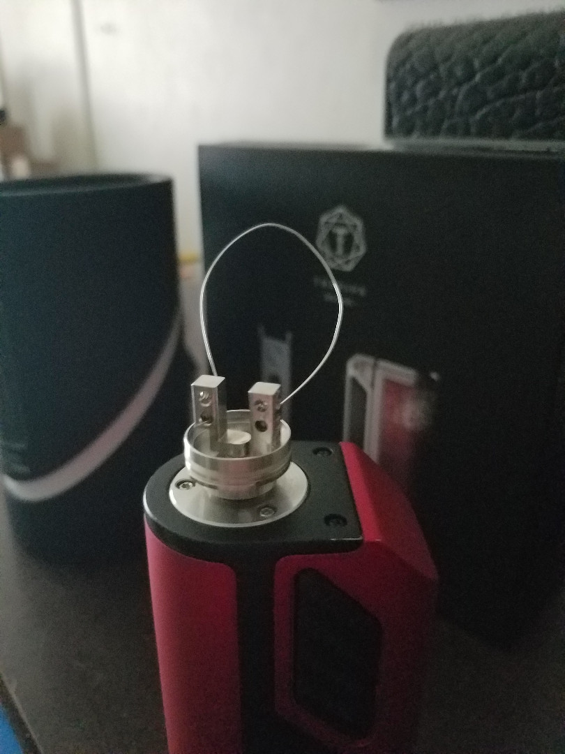

giz_60 Posted March 10, 2017 Report Posted March 10, 2017 And you have everything tight on the build? 510 pin is clean & tight? Try taking just a short piece of wire (not coil) & wire it across the deck...then try the test again...here is what I got doing this (just now)...had to use my 75 to use the plug, but the results should be the same on your 250...

giz_60 Posted March 11, 2017 Report Posted March 11, 2017 On my 250, I can get it down to .008 before I get the ?. Set up with a small piece of Ti. Run analyzer. Open Mod tab. Overlay the analyzer window on the mod tab, take a screen shot & post it. The Max Peak & Sustained Input are in the screen shots I posted...Edit: Put the mod in TC mode

giz_60 Posted March 11, 2017 Report Posted March 11, 2017 Screen shot of the 'Mod' tab & Atomizer Analyzer...
