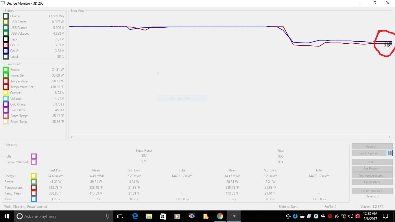

dedasik Posted March 8, 2017 Author Report Share Posted March 8, 2017 ?????? ????? ???? ??? ??? ?? ????, ??? ??? ????? ?? ?????? ??????, ? ?????? ????? ???? ????. ???????? ??? ? ???: ???? ?????????? ??????????? therion 166, ? ??? ? ??? ??????????, ??? ??????? ?????? ?????? ????? 50% ??? ????? chek battary, ????? ?????, ?????????? ??? ??? ????? ????????????, ? ??????? ????? ???????? ?????????.???? ????????????? ???????. Link to comment Share on other sites More sharing options...

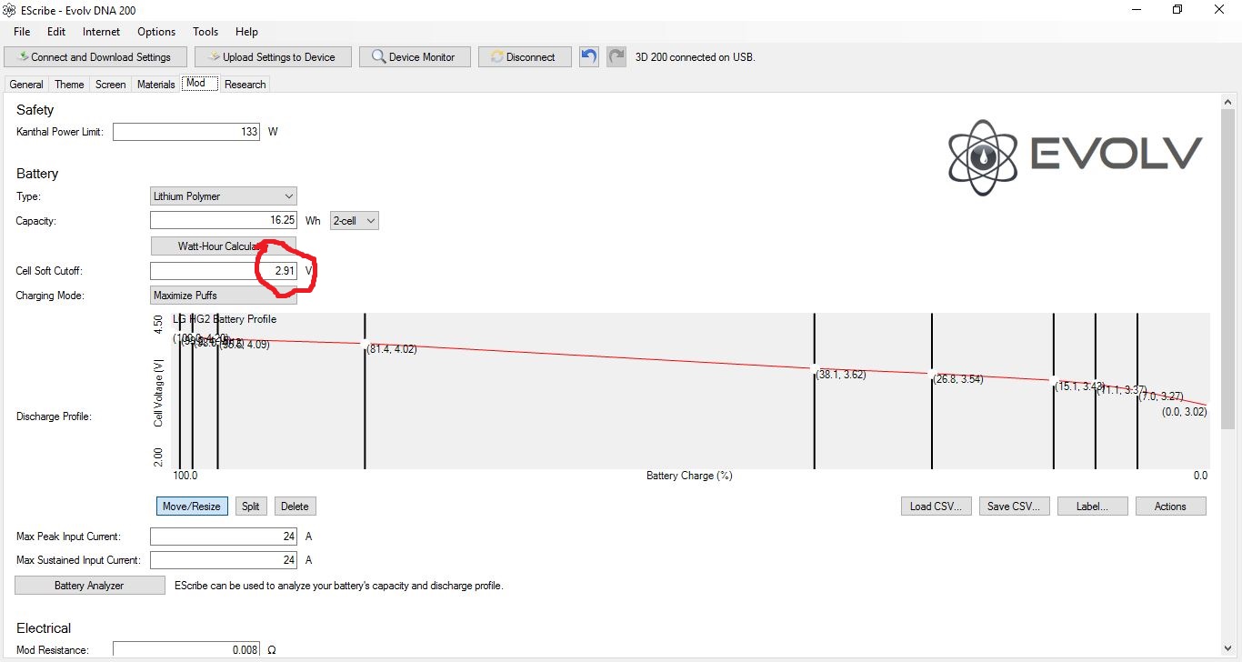

dwcraig1 Posted March 8, 2017 Report Share Posted March 8, 2017 Check cell soft cutoffIn device monitor check voltage drop under load (firing), see if one or both cells drop below cell soft cutoff.Make sure battery connection are clean, even if they look clean. 1 Link to comment Share on other sites More sharing options...
dedasik Posted March 8, 2017 Author Report Share Posted March 8, 2017 ??????? ?? ????? ??? ?????? ?????? ???????, ????? ?? ?????????, ?????? ?? ????? ?? ???? ???? ?????????. ??????? Link to comment Share on other sites More sharing options...

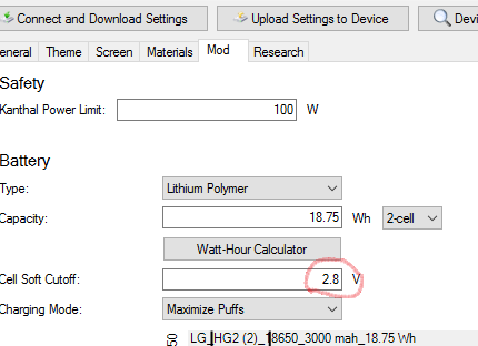

dwcraig1 Posted March 8, 2017 Report Share Posted March 8, 2017 Interesting: note on my snip my cell soft cutoff is 2.91.I was setting it to 2.85 and upon upload it would change to 2.91.I now set it to 2.8 and it stayed at 2.8.I hope the OP got it sorted 1 Link to comment Share on other sites More sharing options...
giz_60 Posted March 8, 2017 Report Share Posted March 8, 2017 dwcraig1 said:Interesting: note on my snip my cell soft cutoff is 2.91.I was setting it to 2.85 and upon upload it would change to 2.91.I now set it to 2.8 and it stayed at 2.8.I hope the OP got it sortedI've noticed that on other parameters as well...seems to round to a different value......(dw corrected dw's spelling) Link to comment Share on other sites More sharing options...
dedasik Posted March 9, 2017 Author Report Share Posted March 9, 2017 ?????? ???????, ???????? ?????? ???????? 2.91 ? ??? ????? ??????, ?? ????????? ?????? ????????, ??? ??????? ?????? ??????? 50% ???? ????? ??????? ????????, ???? ?? 115Watt, ? ????????? ?? 85watt, ??? ????? ??? ?? ???????? ??? ?????? ???????? Link to comment Share on other sites More sharing options...
giz_60 Posted March 9, 2017 Report Share Posted March 9, 2017 ??????? ?? - ???? ??????? Link to comment Share on other sites More sharing options...
dedasik Posted March 9, 2017 Author Report Share Posted March 9, 2017 0,13 Link to comment Share on other sites More sharing options...
giz_60 Posted March 9, 2017 Report Share Posted March 9, 2017 .13 ?? ??? 115 ???? = 4.1v ... ???????? ?????? ???????...?????????? ????? ????? Link to comment Share on other sites More sharing options...
