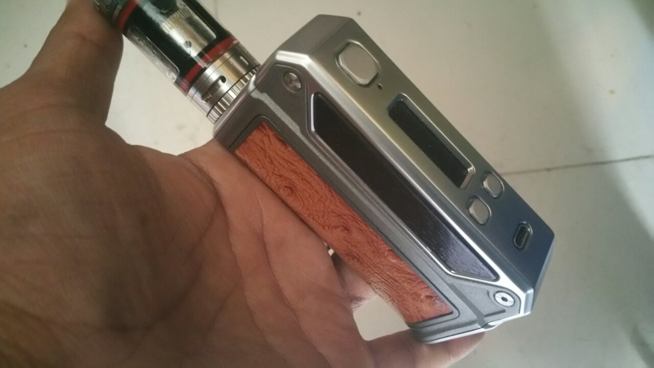

Neloy Posted March 17, 2017 Author Report Posted March 17, 2017 My recently bought Therion 133 has stopped working. it's display is showing CHEECK BATTERY and a display with watt volt, empty battery along with o amp..... what should i do????

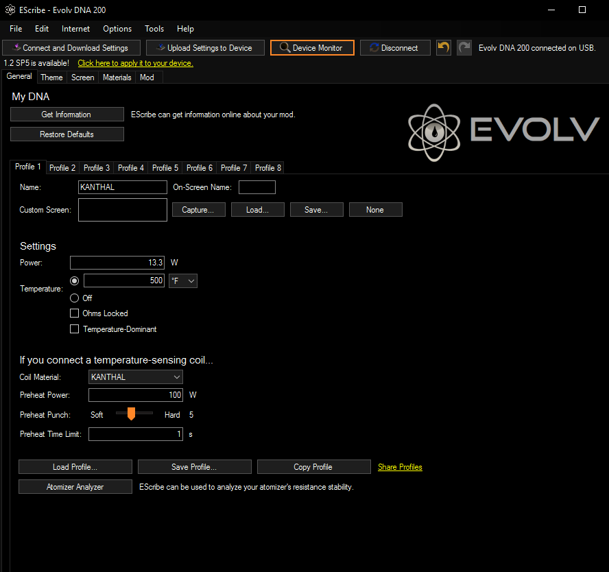

giz_60 Posted March 17, 2017 Report Posted March 17, 2017 Could post a screen shot of the 'Mod' tab & Device Monitor?

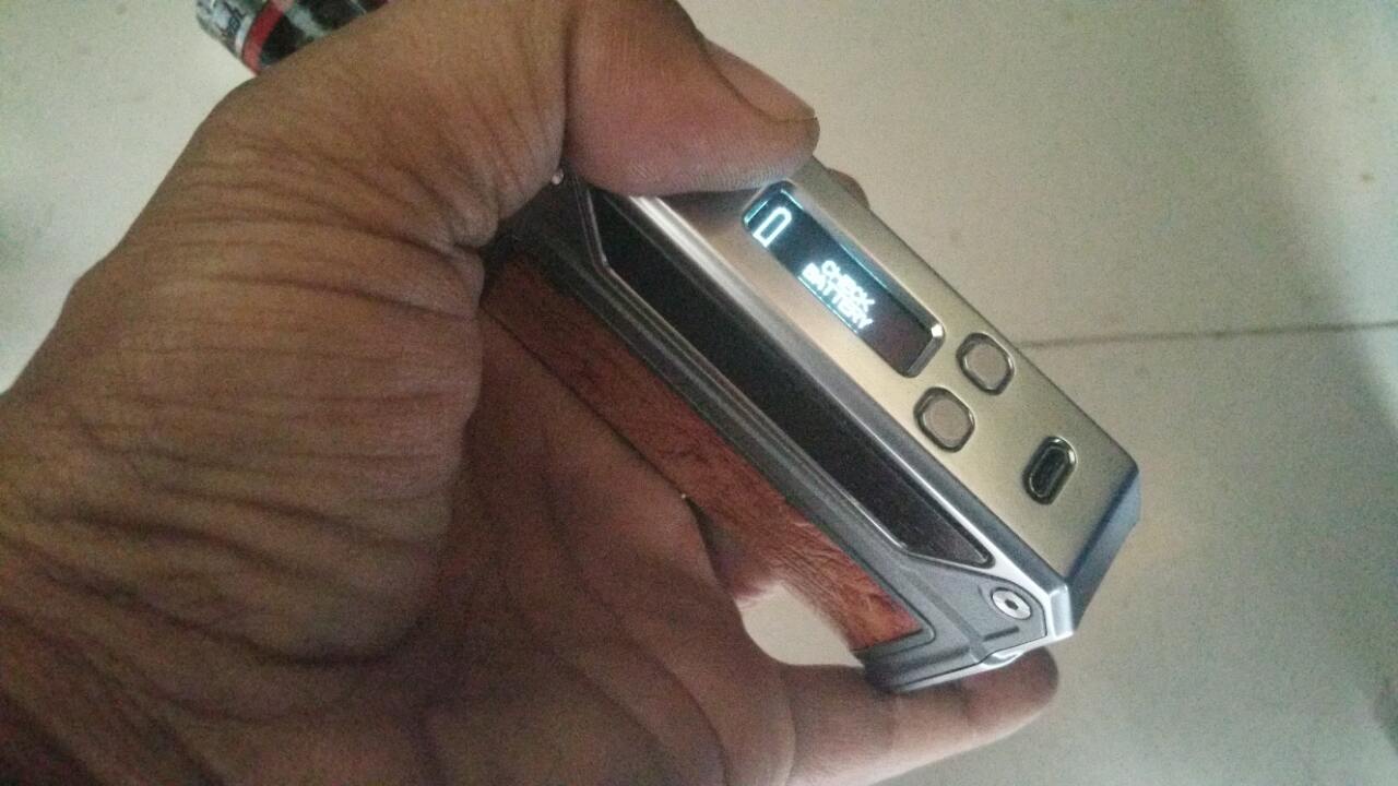

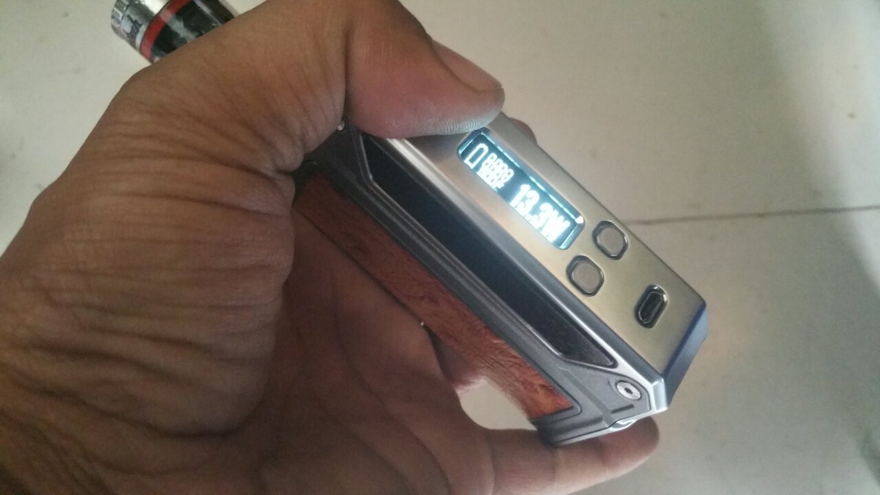

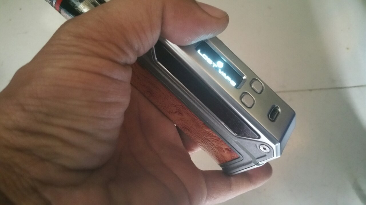

Neloy Posted March 19, 2017 Author Report Posted March 19, 2017 It's so nice of u giz_60, thanks for your reply.....When pressing the fire button it shows the logo, press released and it gets black again, but if u hold the button for long, right after a few seconds... the second ant third (from top) image appears repeatedly until the fire button is released....Batteries are new and perfectly aligned inside. these works in other mods perfectly. Changed the batteries, no improvement.changed four tanks and rda's, it responds the same way.

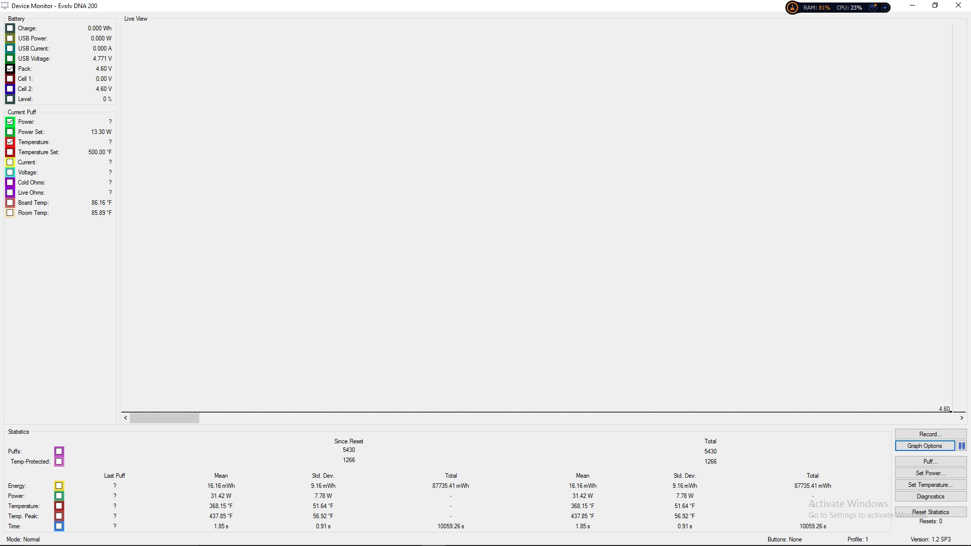

Spector NS5 RD Posted March 19, 2017 Report Posted March 19, 2017 contact the vendor about a replacement. what would be really great is if you can find out what cell 1-2 are reading in Device Monitor. that would tell us, for sure, if the board is gone. if one or both cells are reading incorrectly, which i'm guessing is the case, the board needs replacement. edit...evolv warranties the board for 1 year from the date of purchase. there is also a lostvape repair center. both links are in my signature.
giz_60 Posted March 19, 2017 Report Posted March 19, 2017 Neloy said: It's so nice of u giz_60, thanks for your reply.....When pressing the fire button it shows the logo, press released and it gets black again, but if u hold the button for long, right after a few seconds... the second ant third (from top) image appears repeatedly until the fire button is released....Batteries are new and perfectly aligned inside. these works in other mods perfectly. Changed the batteries, no improvement.changed four tanks and rda's, it responds the same way. Expand Can't tell what is going on by your pictures...a screenshot of the 'Device Monitor' in Escribe will give a better insight as to what the problem is!!
Neloy Posted March 20, 2017 Author Report Posted March 20, 2017 giz_60 said: Can't tell what is going on by your pictures...a screenshot of the 'Device Monitor' in Escribe will give a better insight as to what the problem is!! Expand It's not responding to the fire button
giz_60 Posted March 20, 2017 Report Posted March 20, 2017 Thank you, much better info....Anytime you see a cell voltage as high as #2, then there is an issue with the battery management...as @ChunkyButt200 suggested, you need to contact the vendor you purchase the device from about a warranty replacement , or if that fails, Lost Vape at...http://www.lostvaperepaircenter.com.....Lost Vape warranties their mods for 6 months...
