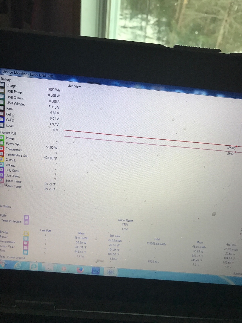

Zaptear Posted March 28, 2017 Author Report Posted March 28, 2017 Got on the 18th this month I was having a problem with the mod it would not get temperature in temperature control can't even get it past 400° decided to run a case analyzer then this happened the store I bought it from is replacing it but did not know if it was a simple reset
giz_60 Posted March 28, 2017 Report Posted March 28, 2017 Zaptear said:Got on the 18th this month I was having a problem with the mod it would not get temperature in temperature control can't even get it past 400° decided to run a case analyzer then this happened the store I bought it from is replacing it but did not know if it was a simple reset Looks like cell #2 is reading 4.97v, indicating a problem...sorry, no simple reset...

Zaptear Posted March 28, 2017 Author Report Posted March 28, 2017 Ya was reading room temp of 90 when it was 74 tc I did not know much because this is my 1st DNA I hope I just got a dud and that I made a good choice upgrading but my 4yo mech still works with out any problems
giz_60 Posted March 28, 2017 Report Posted March 28, 2017 Has nothing to do with the issue you are having. The temp can be gotten closer by running the case analyzer...Those devices come with the Evolv default values...
Zaptear Posted March 28, 2017 Author Report Posted March 28, 2017 But it happened in the middle of running case analyzer
giz_60 Posted March 28, 2017 Report Posted March 28, 2017 Coincidence...it just happened to happen at that time...I have run case analyzer, several times, on all (8) of my devices without an issue...including a Therion 166
