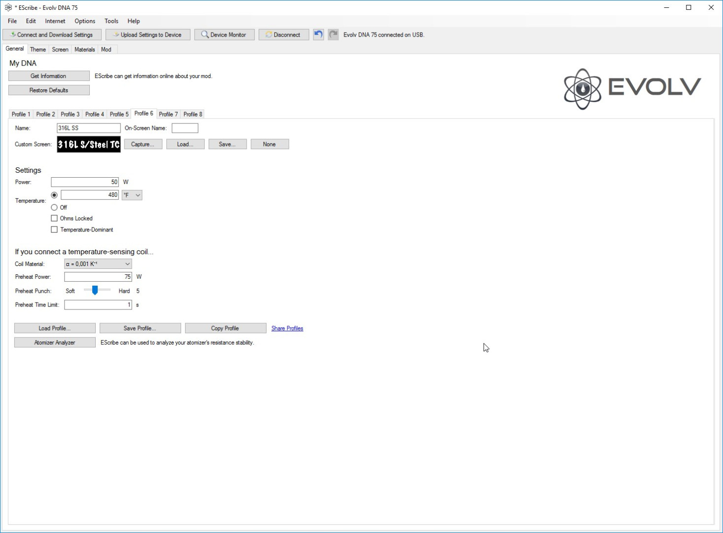

giz_60 Posted March 24, 2017 Report Share Posted March 24, 2017 A screen shot of your wire profile the 'General' tab, 'Mod' tab & Device Monitor, while firing, would be very helpful! Link to comment Share on other sites More sharing options...

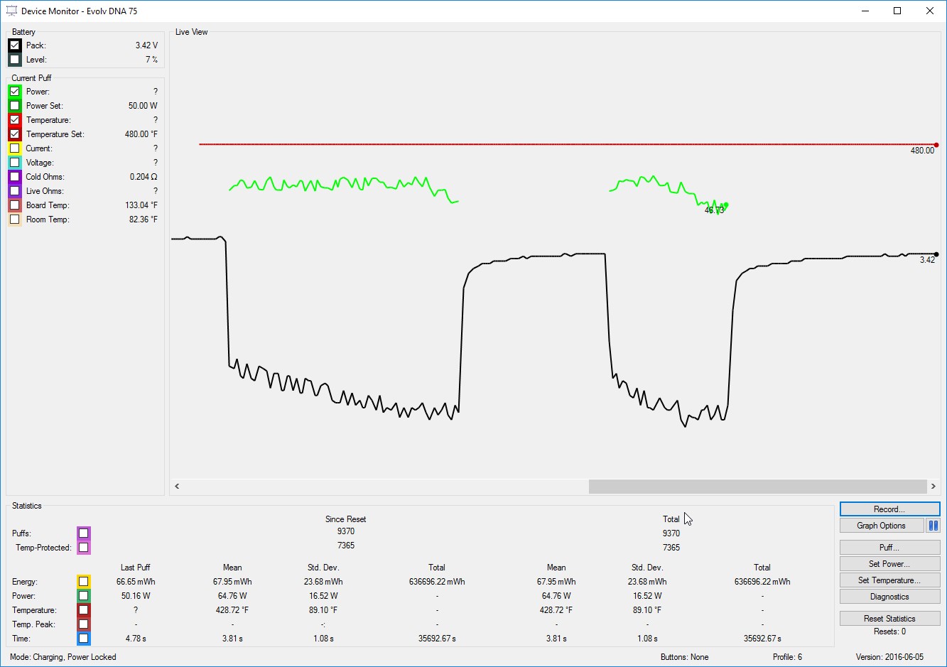

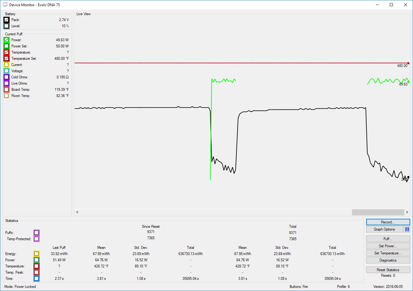

Wicked0ne Posted March 24, 2017 Report Share Posted March 24, 2017 Link to comment Share on other sites More sharing options...
giz_60 Posted March 24, 2017 Report Share Posted March 24, 2017 Ok...can you post another screenshot of Device Monitor with the cold ohms & live ohms selected... Link to comment Share on other sites More sharing options...
Wicked0ne Posted March 24, 2017 Report Share Posted March 24, 2017 Sorry, no idea why they where unchecked. Link to comment Share on other sites More sharing options...

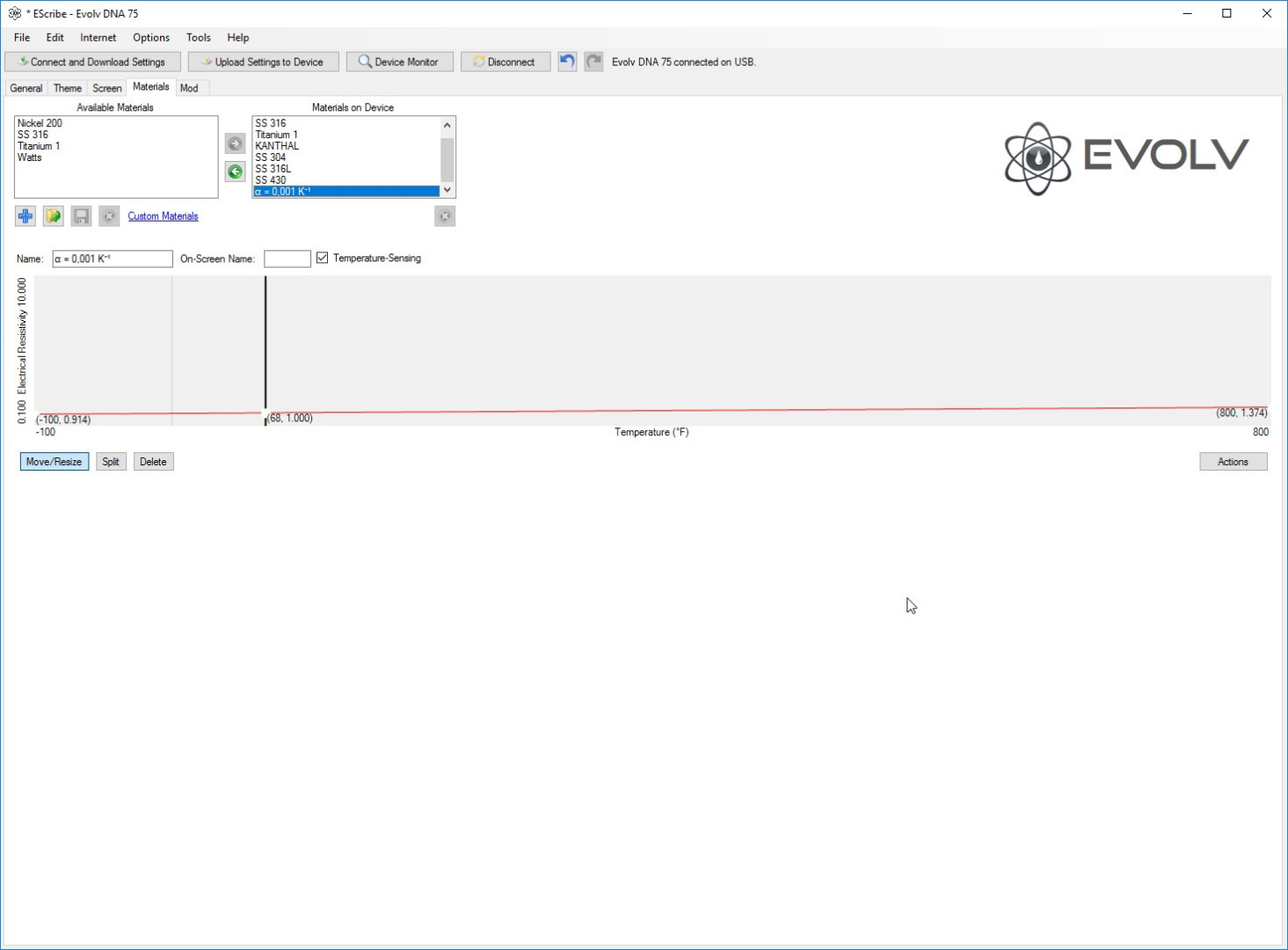

giz_60 Posted March 24, 2017 Report Share Posted March 24, 2017 Also...a screen shot showing that wire setting in the Materials tab... Link to comment Share on other sites More sharing options...

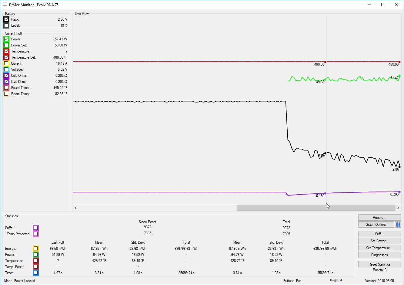

giz_60 Posted March 24, 2017 Report Share Posted March 24, 2017 You must be using a TCR value... .00092...you may have an unstable connection somewhere... I would check all your connections on you atty....deck screws etc...make sure the 510 pin on the atty is good & clean...clean the 510 connection on the device with some iso alcohol & cotton swab... Link to comment Share on other sites More sharing options...
giz_60 Posted March 24, 2017 Report Share Posted March 24, 2017 Hold on...your cold ohs & live ohms are the same...looks like the coil may have been warm when you set the cold ohms into the device...looks like the cold ohms are .180...you can go to the Atomizer Analyzer on the General tab...click override ohms...enter .18...close the analyzer & upload to device...then try it... Link to comment Share on other sites More sharing options...

giz_60 Posted March 24, 2017 Report Share Posted March 24, 2017 If you look at the last Device Monitor screenshot you posted, you will see that your cold ohms were at .203 & when you fired it, the ohms dropped...to the true cold ohms... and slowly rose back up to the .203 ohms again...meaning that your cold ohms in the device were actually set at the hot(max) ohms...you need to get the correct cold ohms into the device, because the device needs to see a rise in resistance that equates to 185f temp rise...with the cold ohms set so high, its never gonna see it...you can try leaving the setup alone for a little while & let the refinement reset the ohms....or remove the atty from the device for a little bit & when you reinstall it, if it ask if it is a new coil, select yes... the coils HAVE to be cold in order to get an accurate reading of the cold ohms Link to comment Share on other sites More sharing options...

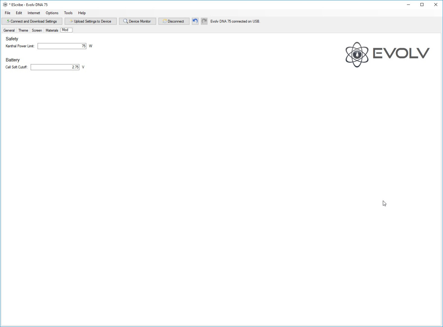

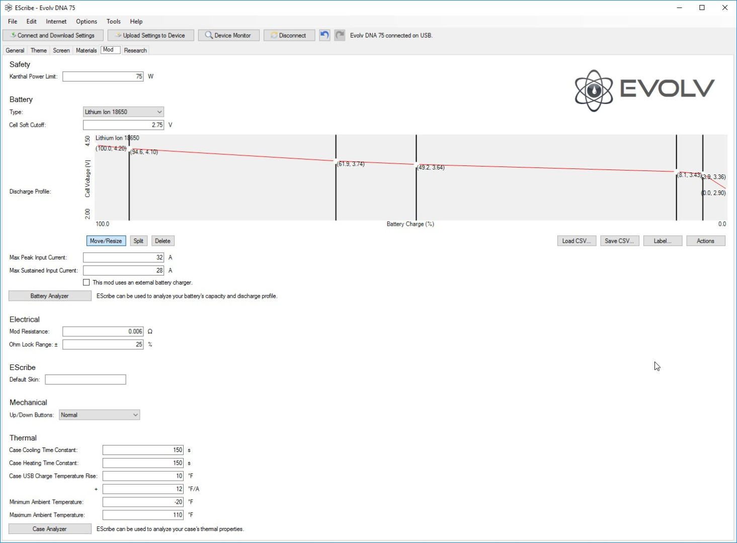

giz_60 Posted March 24, 2017 Report Share Posted March 24, 2017 I was looking over your screen shots & notice that you are using the Advanced User Interface...have you done any calibrations on the device yet? Go to 'Options>User Interface' & select 'Manufacturer' & then post another screenshot of your Mod tab... I don't think LV sends out those mods with the 'Mod Resistance' set & it is really important for proper TC... Link to comment Share on other sites More sharing options...
Wicked0ne Posted March 24, 2017 Report Share Posted March 24, 2017 Sorry about the delay. Link to comment Share on other sites More sharing options...

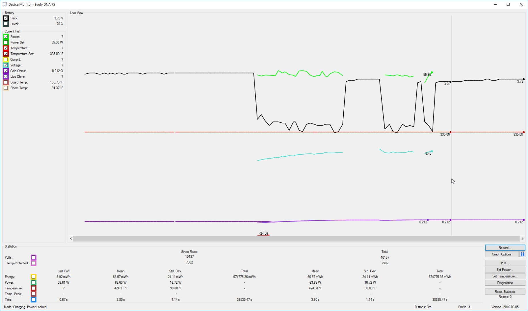

giz_60 Posted March 28, 2017 Report Share Posted March 28, 2017 Can you post a screenshot of device monitor while firing Link to comment Share on other sites More sharing options...
Wicked0ne Posted March 28, 2017 Report Share Posted March 28, 2017 Link to comment Share on other sites More sharing options...
