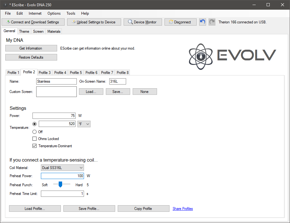

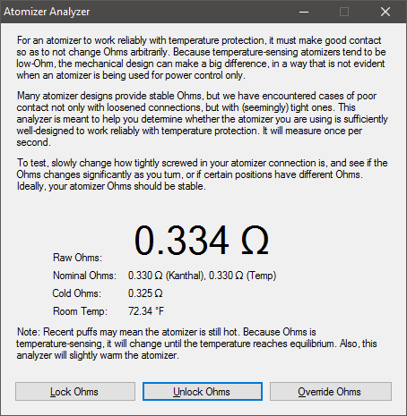

DkPatriots Posted March 31, 2017 Author Report Posted March 31, 2017 I got a Therion 166 earlier in the week, and spent a lot of time over the last two days trying to get TC to work well. My issue is that I'll put a coil on the mod and open the atomizer analyzer. I'll use the values of my current coil in this example, which fluctuated between .333 and .335. The internal resistance is set to .04, so the cold ohms should be read be ~.330, however the mod sets the cold ohms to .323-.325.I do get a consistent vape, but I have to have the temp set for 500-530 or so, instead of the 400-430 I typically use. It isn't "accurate" and that bothers me. Several times I've let the coil cool for half an hour, re-attach it, and the atomizer analyzer still shows .334 give or take .001, and when I fire it the cold ohms get set to .324 give or take .001 .The issue happens consistently with every attempted build, I'm looking to see how I can figure out why. Could anyone point me in the right direction? Thank you!!Tank: OBS EngineWire: Master of Clouds 26g SS316LBuild: Dual 9/10 spacedRegistered Ohms: .334Cold Ohms: Incorrectly get set to .323I used the follow Steam-Engine values:"Temperature (degF)","Electrical Resistivity"-58.0000,0.923064000068.0000,1.0000000000212.0000,1.0800000000302.0000,1.1260000000392.0000,1.1680000000482.0000,1.2070000000572.0000,1.2460000000800.0000,1.3369666667

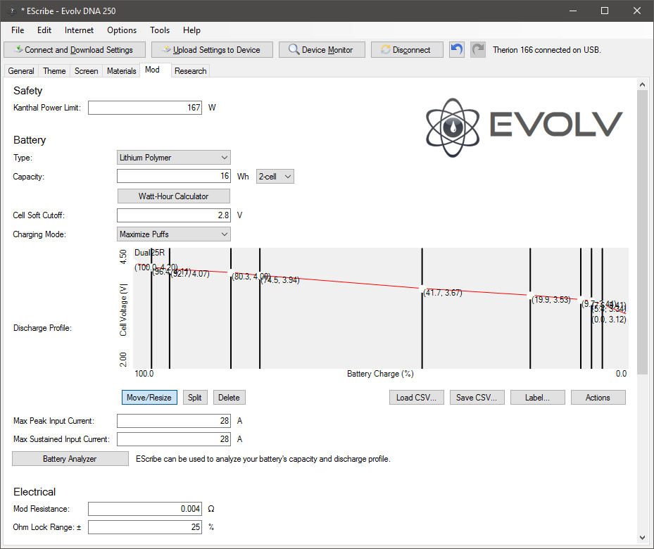

DkPatriots Posted March 31, 2017 Author Report Posted March 31, 2017 @Giz_60Mod Resistance value is set to .004, as shown in the third picture of my original post.The first picture in my original post shows the issue with Raw, Nomimal, and Cold. I took that screenshot after letting the mod sit for 30 minutes while plugged into eScribe running the Atomizer Analyzer. I've entered what is shown in that screenshot below:Mod Resistance: .004Raw Ohms: .334Nominal Ohms: .330 Cold Ohms: .325Raw and Nominal are correct. Cold ohms was set to .325 instead of .330 (to my knowledge cold ohms should be equal to nominal ohms when the coil has cooled to room temp). I've repeated this about 10 times with different builds on different atomizers and each time cold ohms are set lower than nominal ohms.
giz_60 Posted March 31, 2017 Report Posted March 31, 2017 I see the the screenshots above...you are correct...the cold ohms should equal the nominal ohms, if the mod resistance value is correct...where did you get that value?, because if that screen shot is of AA after having let your rig set for 30 min., I am seeing a mod resistance higher than .004...
DkPatriots Posted March 31, 2017 Author Report Posted March 31, 2017 .004 for mod resistance is what the default is. I have not reset this for my mod yet, as I don't know how to get the mod's internal resistance value to put into eScribe. I assume it will be covered in the Evolv Training Course that I'm going through, I just haven't gotten to anything covering that yet.To my knowledge (and I could be wrong here), eScribe and the mod will use the settings provided, so even if .004 is wrong for my internal resistance, it should still set Cold Ohms to Nominal Ohms. So if my internal resistance was .007 but set to .004, the mod should still use .004 for nominal / cold ohms. In my case, Nominal Ohms is always .004 below Raw Ohms (as it should be). But Cold Ohms is always about .005 - .006 below Nominal and I have no idea why.
giz_60 Posted March 31, 2017 Report Posted March 31, 2017 DkPatriots said:.004 for mod resistance is what the default is. I have not reset this for my mod yet, as I don't know how to get the mod's internal resistance value to put into eScribe. I assume it will be covered in the Evolv Training Course that I'm going through, I just haven't gotten to anything covering that yet.I too have a Therion & just checked the factory settings...and that is the factory default, but doesn't mean that is the true mod resistance of your device..DkPatriots said:To my knowledge (and I could be wrong here), eScribe and the mod will use the settings provided, so even if .004 is wrong for my internal resistance, it should still set Cold Ohms to Nominal Ohms. So if my internal resistance was .007 but set to .004, the mod should still use .004 for nominal / cold ohms. In my case, Nominal Ohms is always .004 below Raw Ohms (as it should be). But Cold Ohms is always about .005 - .006 below Nominal and I have no idea why.The Raw ohms in AA is the cold ohms plus the internal resistance added. The nominal ohms is the Raw ohms minus the value set in the mod resistance setting..if the mod resistance value is not correct, the cold ohms & nominal ohms will NEVER be equal...neither Escribe or the mod are going to set the cold ohms to the nominal ohms...in order for those to be equal, the mod resistance has to be correct... judging by the AA screen shot you posted previously, I am seeing a mod resistance higher than .004

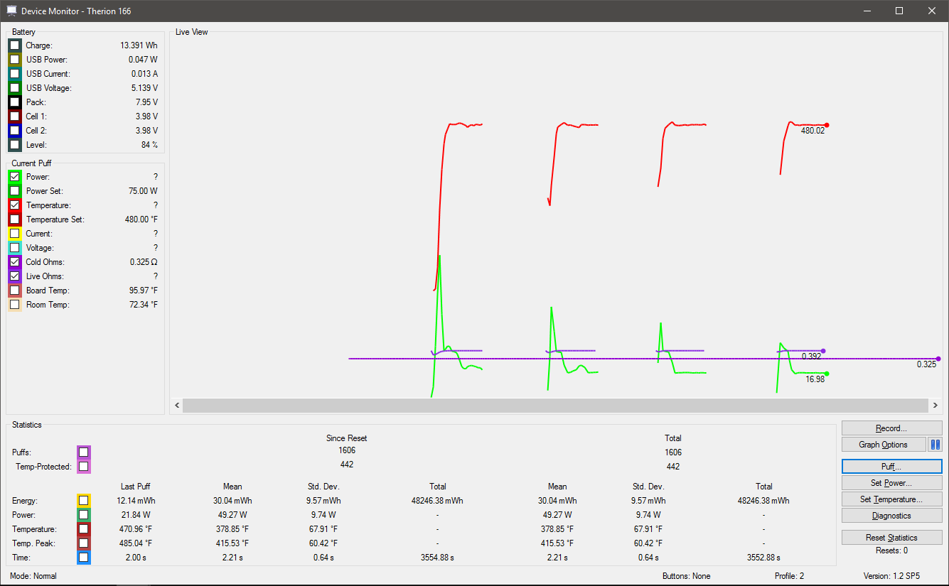

DkPatriots Posted April 1, 2017 Author Report Posted April 1, 2017 Okay I followed your guide and set my internal resistance to .006 in eScribe. The Cold Ohms and now closer to the Raw Ohms, still not matched, but closer. I also did some experimentation using the Device Monitor. I found a wattage in wattage mode that gives me a good vape, then I put the unit into TC mode and set the wattage to the same that I had in wattage mode, and set the temp to 600 so that TC could not kick in. The device monitor showed the temp going up to 500-520 degrees. I've only used the OBS Engine in TC mode on the Therion, but I have used other tanks in TC mode on other mods. The OBS Engine is top airflow while the others I've used in TC mode in the past are bottom airflow. This leads me to believe that top airflow just needs higher temps to get a good vape. This explains the OBS Engine needed TC set to 500-520 vs the typical 400-430 for tank I've used in the past.Does that make sense or am I incorrect in the top airflow requiring higher temps? Unfortunately I do not have a bottom airflow rebuildable Tank to test this on.
Spirometry Posted April 1, 2017 Report Posted April 1, 2017 DkPatriots said:In my case, Nominal Ohms is always .004 below Raw Ohms (as it should be). But Cold Ohms is always about .005 - .006 below Nominal and I have no idea why.Cold Ohms is interpolated to 70° F.If your cold ohms is lower than your nominal ohms, it means that the DNA thinks the room temperature is warmer than 70°.
DkPatriots Posted April 2, 2017 Author Report Posted April 2, 2017 Cold Ohms is interpolated to 70° F.If your cold ohms is lower than your nominal ohms, it means that the DNA thinks the room temperature is warmer than 70°. Thank you for this, it makes a ton of sense. My Therion typically thinks it's warmer than it is by around 10-15 degrees. Currently it thinks that the room temp is 81.3, but the thermostat in this room is set to 68 and is reading 68. I've done the case analyzer which made the mod better at knowing the room temp; the mod does a really good job when it's been sat down for 60+ minutes. After sitting overnight it is typically dead on accurate. However if I'm vaping on it the temp accuracy isn't great. I'm currently playing video games at my PC, and taking a few puffs every 10 minutes or so, and have been for an hour. As I said above, the mod believes the temp is around 13.3 degrees higher than it really is.
Spirometry Posted April 2, 2017 Report Posted April 2, 2017 Refinement is always on the lookout for the lowest calculated resistance for 70°. So if your cold resistance is higher than what it already has locked in, it will just reject it and use the reading it was already using.

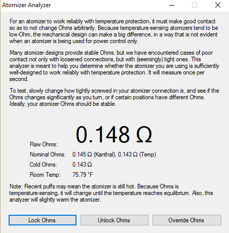

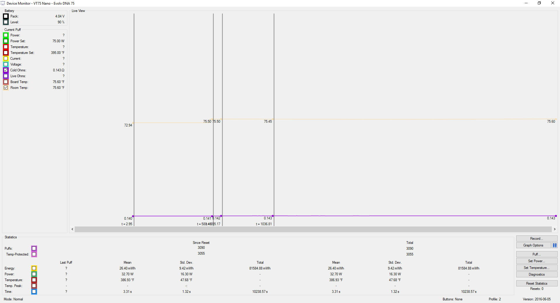

Jolly Rodger Posted April 4, 2017 Report Posted April 4, 2017 Spirometry said:Refinement is always on the lookout for the lowest calculated resistance for 70°. So if your cold resistance is higher than what it already has locked in, it will just reject it and use the reading it was already using. So, does this mean my device is not refining the resistance properly? Device was plugged in & left alone for almost an hour. In about 17 mins, the cold ohms went from .140 to .143...
Spirometry Posted April 5, 2017 Report Posted April 5, 2017 I think it's fine. Leaving it plugged in will heat the board. The dna will have to guess the room temp based of of the case analyzer calculations. Somewhere along the line, there is a time frame that the dna will read the same resistance and room temp and raise your cold ohms value. If you were to unplug it, i'm willing to bet your cold ohms would fall back down to 0.140
