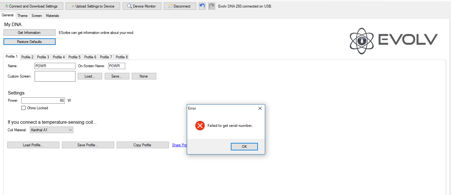

z3r006 Posted April 7, 2017 Author Report Share Posted April 7, 2017 I tried playing with Escribe and under tools>production utility and loaded the incorrect service pack/firmware please help Link to comment Share on other sites More sharing options...
VapingBad Posted April 16, 2017 Report Share Posted April 16, 2017 You should be able to recover by applying service pack, just click through the warnings about not being connected. Link to comment Share on other sites More sharing options...
Jolly Rodger Posted April 16, 2017 Report Share Posted April 16, 2017 I must be missing something cause I don't see a production utility under the 'Tools'...even looked in debug mode as well... Link to comment Share on other sites More sharing options...
VapingBad Posted April 16, 2017 Report Share Posted April 16, 2017 You need to have selected it during install IIRC and have manufacture as the display mode. Link to comment Share on other sites More sharing options...
Jolly Rodger Posted April 16, 2017 Report Share Posted April 16, 2017 VapingBad said: You need to have selected it during install IIRC and have manufacture as the display mode. Expand Got it, thanks! Link to comment Share on other sites More sharing options...
