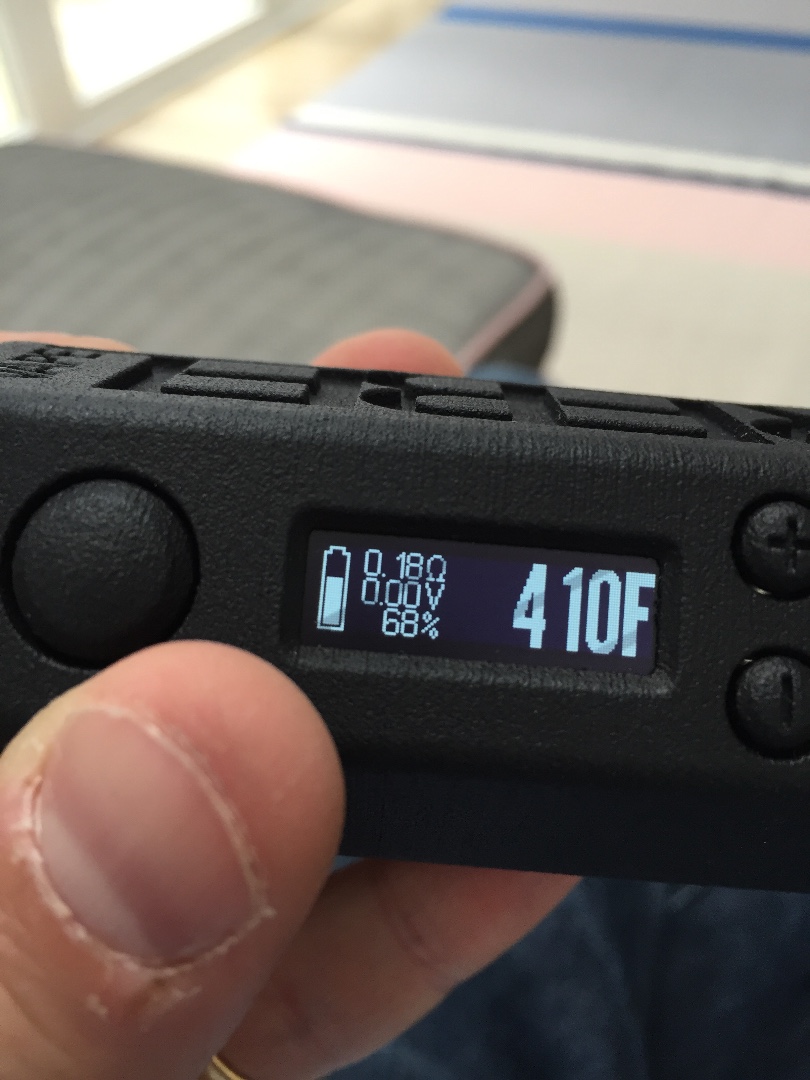

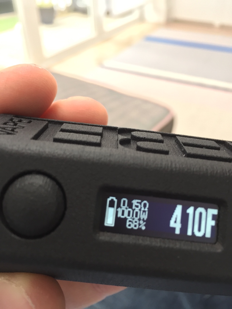

Markez79 Posted April 13, 2017 Author Report Posted April 13, 2017 Hi, I need some help! I have a new DNA250 mod and have the SS316 profile set up. However, when I put my goon on it in temp mode it shows Volts but when I put my Kennedy on it in the same mode it shows Watts....?! Can I change this to show watts for both? I read somewhere I can do this from the mod but can't work it out. Pictures attached. Cheers.

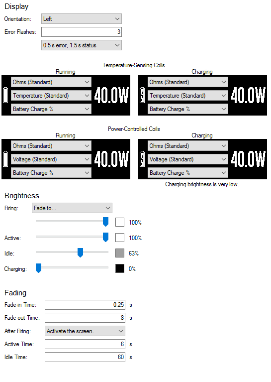

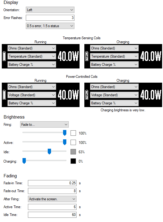

giz_60 Posted April 13, 2017 Report Posted April 13, 2017 The screen fields can only be changed in Escribe...can you post a screenshot of the 'Screen' tab from Escribe...

giz_60 Posted April 13, 2017 Report Posted April 13, 2017 Will need to see a screen shot of your 'Screen' tab, but suspect that the mod is dropping out of TC on one atty...and you are seeing the 'Power' screen field settings...

giz_60 Posted April 13, 2017 Report Posted April 13, 2017 No, just a screenshot of the 'Screen' tab...
giz_60 Posted April 13, 2017 Report Posted April 13, 2017 Ok, with the atty that is showing the volts, the mod appears to be dropping out of TC mode into Power mode. This is usually caused by unstable resistance....screws on build deck not tight enough...atty may need to be disassembled & cleaned, etc...
Markez79 Posted April 13, 2017 Author Report Posted April 13, 2017 Ok - many thanks. I will give it a clean.Thanks again
giz_60 Posted April 13, 2017 Report Posted April 13, 2017 There could also be issues with the settings on the device, but seems how one atty is working in TC, probably an unstable resistance issue...
