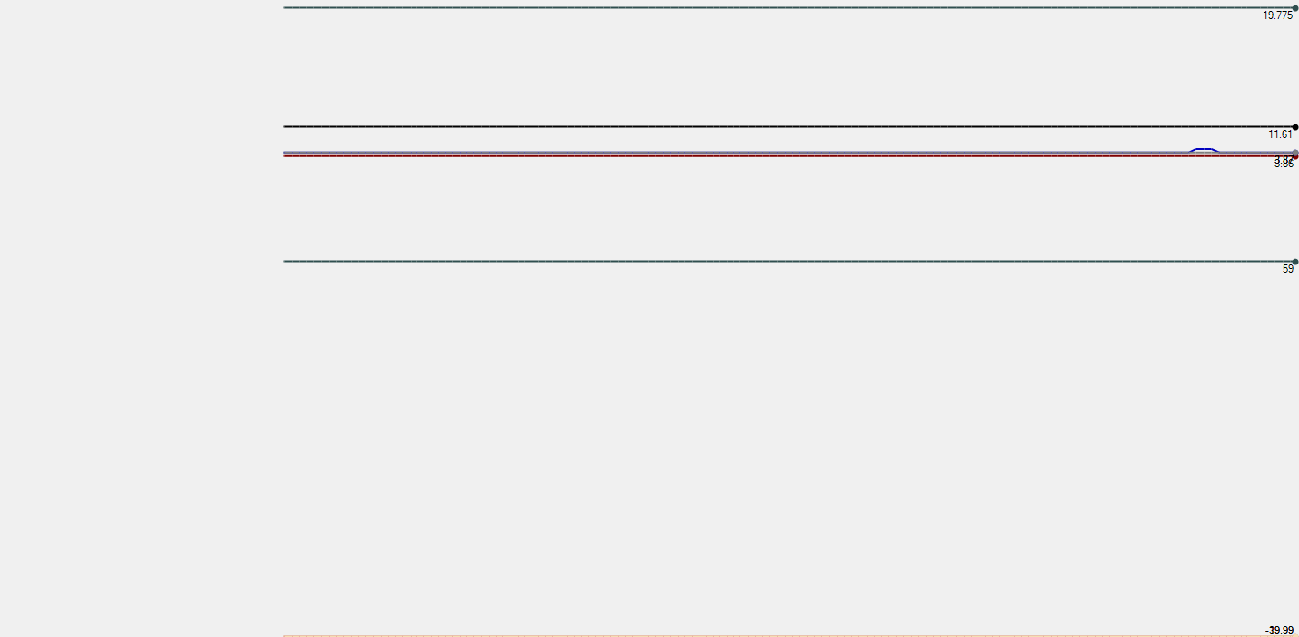

bluntmoment Posted April 21, 2017 Author Report Share Posted April 21, 2017 I have built a mod using the DNA250 screen. everything came out pretty good, solder points look good etc. I have charged this mod once since I have built it. It charged just fine w/o any issues. Now this morning I was at 60% so I figured I would charge it at work. When I first plugged in the usb charger the lightning bolt came on but it started flashing, I have never seen this before. Since then the flashing has stopped however it hasn't charged at all, still on 60% and its been around 40 mins on the charger. I am using a Turnigy Graphene 3000mAh. I have all the settings changed via escribe. The others I have built using this same set up have worked just fine. Now this one is giving me fits lol Link to comment Share on other sites More sharing options...
dwcraig1 Posted April 21, 2017 Report Share Posted April 21, 2017 What does voltages does EScribe say the cells are, a screen of device monitor would be helpful. Link to comment Share on other sites More sharing options...
bluntmoment Posted April 21, 2017 Author Report Share Posted April 21, 2017 for some reason I cannot get a screen shot of device monitor. But I did notice that the Wh keep changing itself from what I had it set up as which is 33.3wh to 19.79wh. The cells are 3.86v, 3.87v. 3.87v., and the room temp states -19.99F, board temp -39.99F Link to comment Share on other sites More sharing options...
bluntmoment Posted April 21, 2017 Author Report Share Posted April 21, 2017 Link to comment Share on other sites More sharing options...
dwcraig1 Posted April 21, 2017 Report Share Posted April 21, 2017 Well the room/board temp is way off. It must think it's too cold to safely charge. Probably you should open a ticket with Evolv. 1 Link to comment Share on other sites More sharing options...
