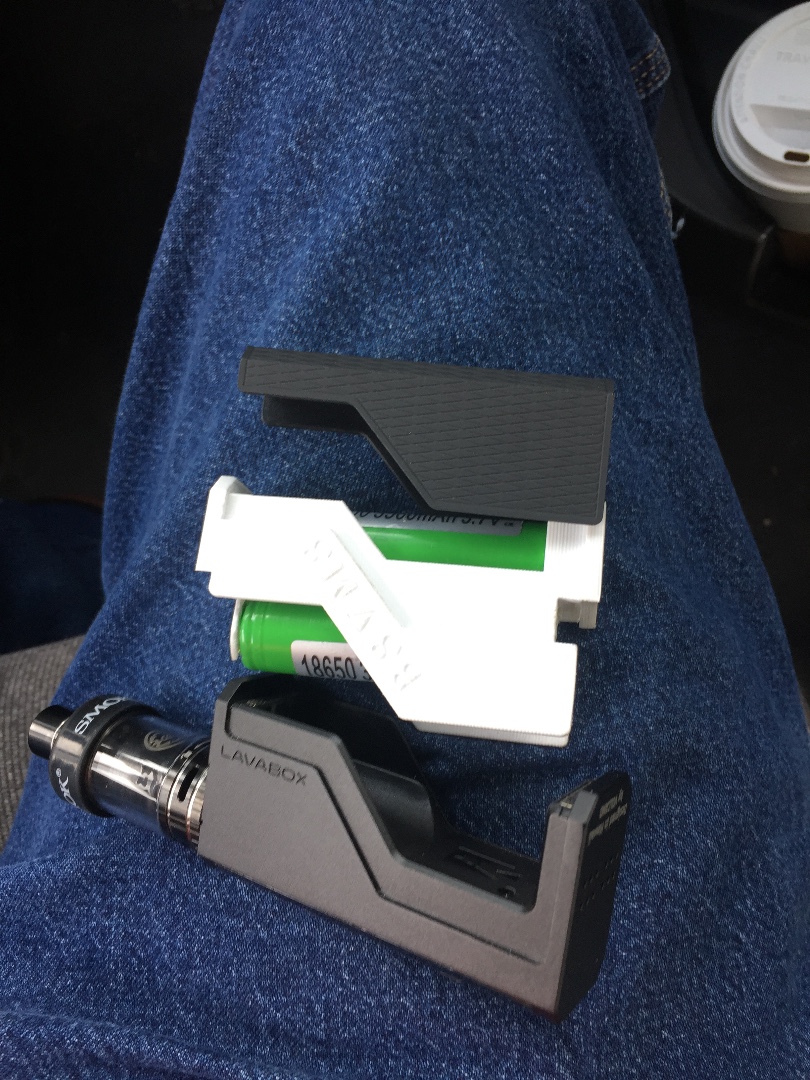

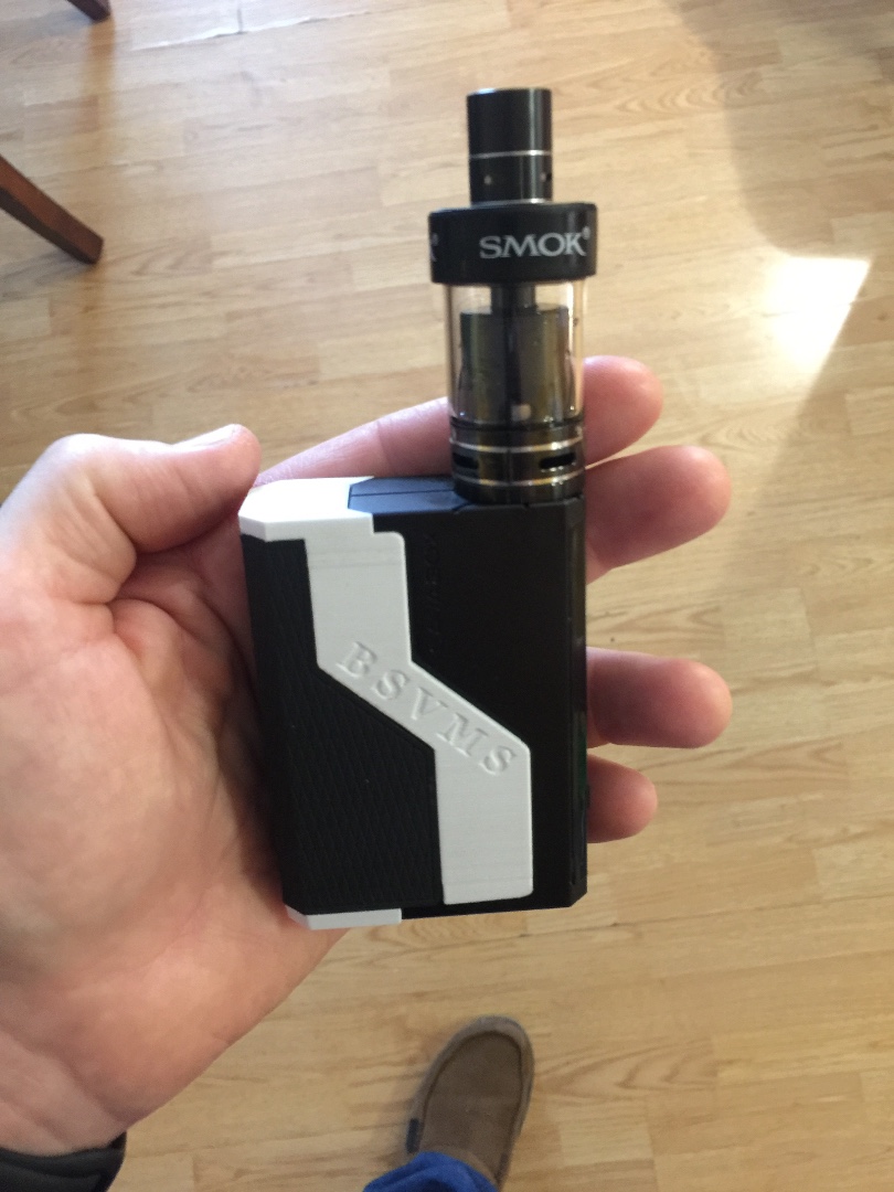

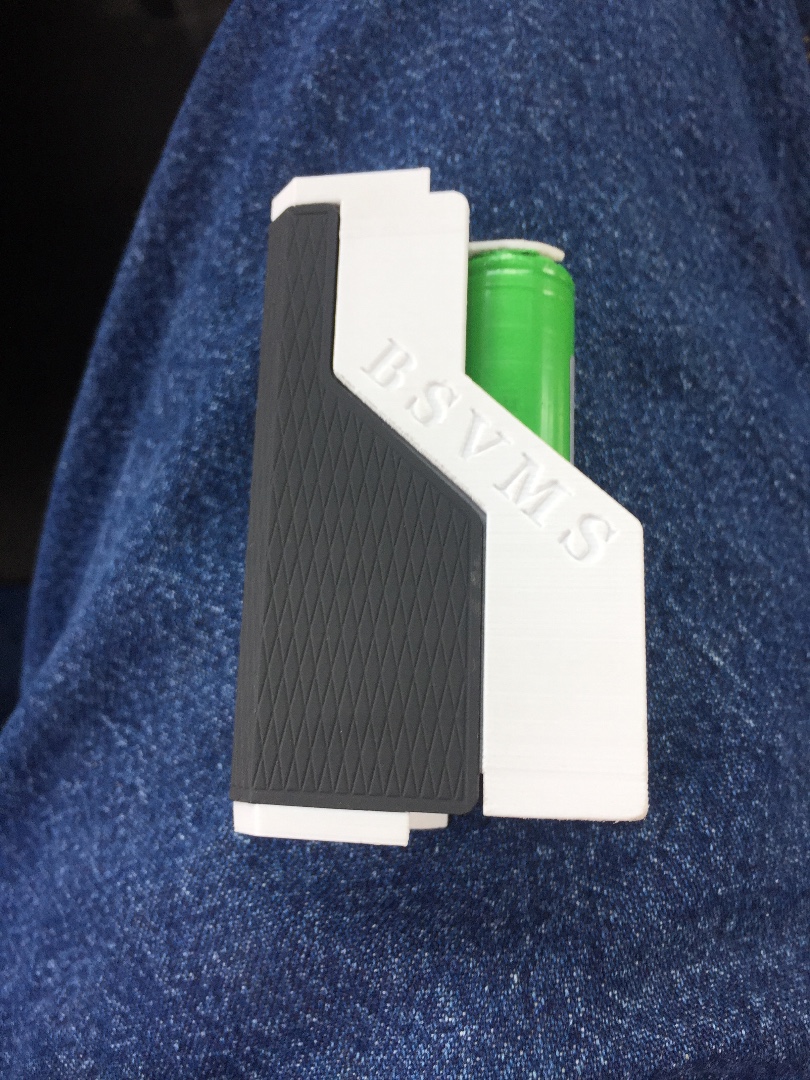

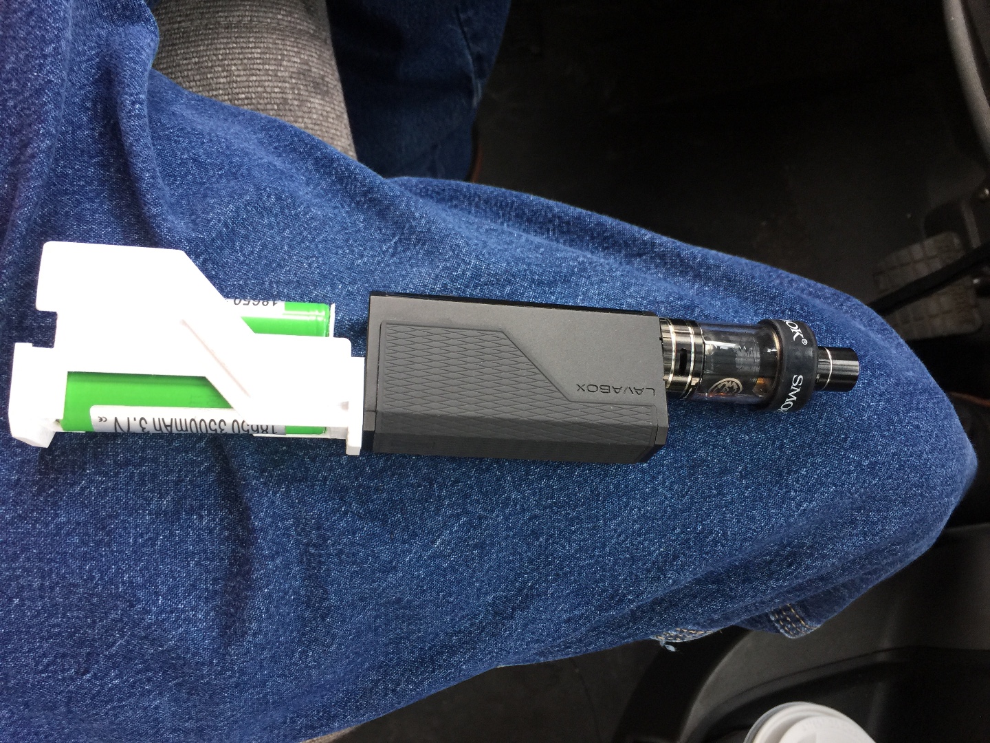

Wildman199 Posted May 3, 2017 Report Posted May 3, 2017 I have a plug and play battery extension for the Lava Box DNA75 made by BSVMS $40. I use 2 mxjo green 20 amp 3500 mah. I don't get the weak battery alert till battery is just about dead. One or two bars left on the indicator.
