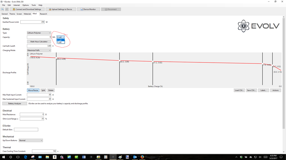

giz_60 Posted May 3, 2017 Report Posted May 3, 2017 Can you post a screen shot of the Mod tab in Escribe & one of the Device Monitor...

giz_60 Posted May 23, 2017 Report Posted May 23, 2017 2 hours ago, NoRm357 said: If that photo is from a Therion 166, it is looking for to many cells. Go into the 'Mod' tab in Escribe & make sure it is set for '2 Cell' & not '3 Cell'...then be sure to upload to device! 1
