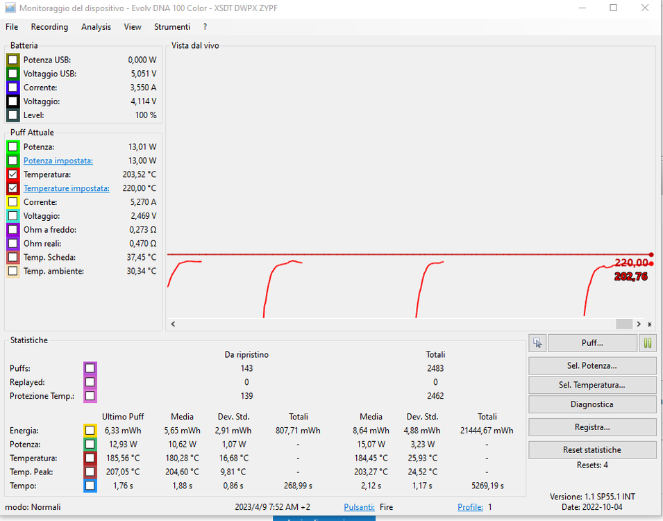

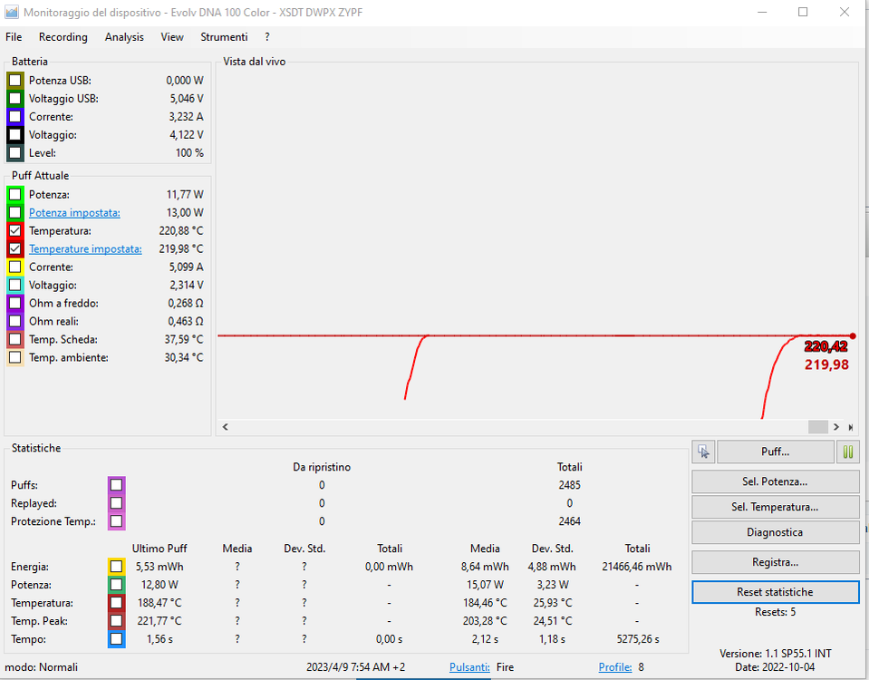

  2. Who can explain to me why in Replay mode the controlled temperature with the same watts and settings (13 watts reaches 220 C protection, only with Tc without replay, it reaches 200 C, set temperature 220 C) is 20 C higher than the classic Tc ?
