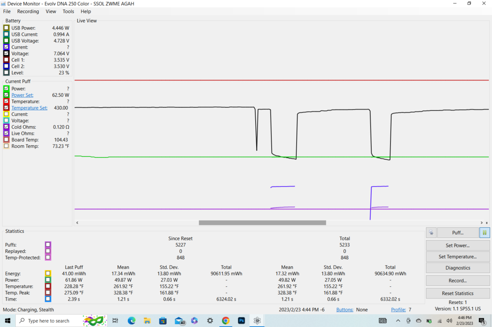

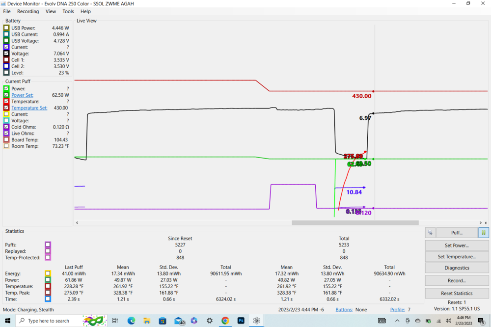

  12. here are the pictures after i got an identical tank just a new one with a fixed 510 pin, it is way more stable, and way faster time and idk if there would be any things that might help with showing what could be up with the ohms of the coil, first is watt with boost then with no boost, second is tc with no preheat
  13. it is showing up as a constant .111-.112 perfect not changing at all

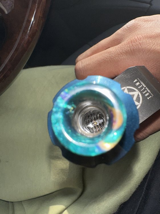

  16. and on top of that even weirder i have the exact same build just spaced, and yes evenly spaced, but it is showing on my mod as .11

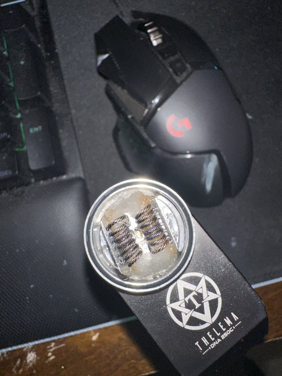

  18. that is per coil, and total is .2. But my mod is reading them as .11 so i really dont know why they say they are so low. ss316L has an 18.92% higher resistance than ss430 so it shouldn't make that much of a difference
  19. this is what steam engine says they should come to screws are all tight as possible coil is stable in the analyzer
