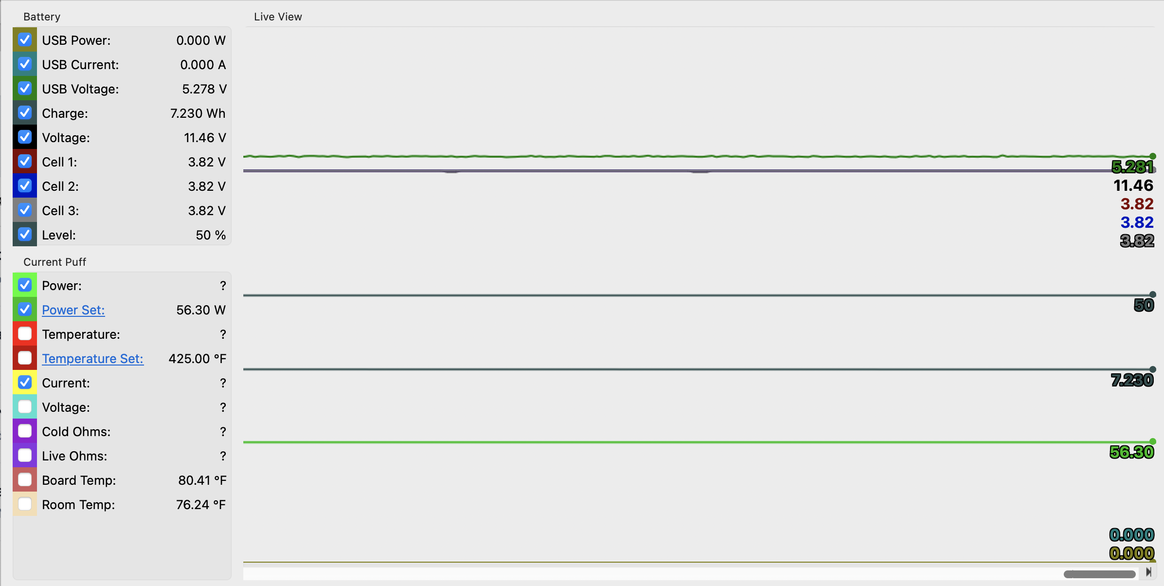

  6. Update: I downgraded to an earlier firmware version (from sp6 to sp5) and ACTUALLY something changed but still not working. Now from the total 0.0000 of usb power and usb current we are at 0.015 (max) W of USB Power and 0.002 A of USB Current but the charge is still dropping. Do you have more information about the Power managment chip or where to find the codes so i can search it online if its the problem? Also, is there a datasheet with electronic schematic that i can consult? Thanks!
  7. I did Device Manager -> Diagnostics -> Enable USB charging many times with no luck! I will try an older firmware. How do you suggest me to see if the BQ76925 chip doesnt work? Thank you!

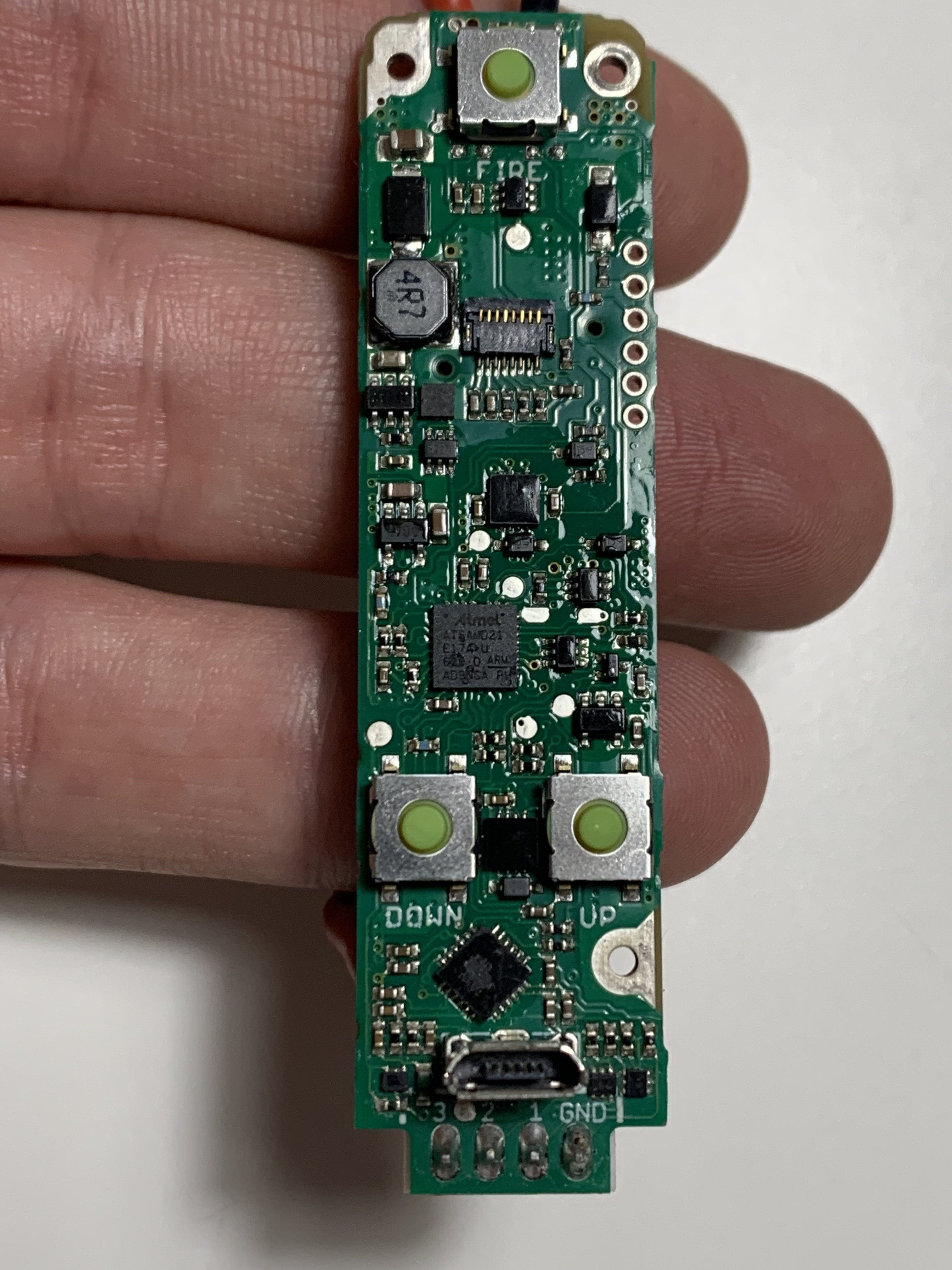

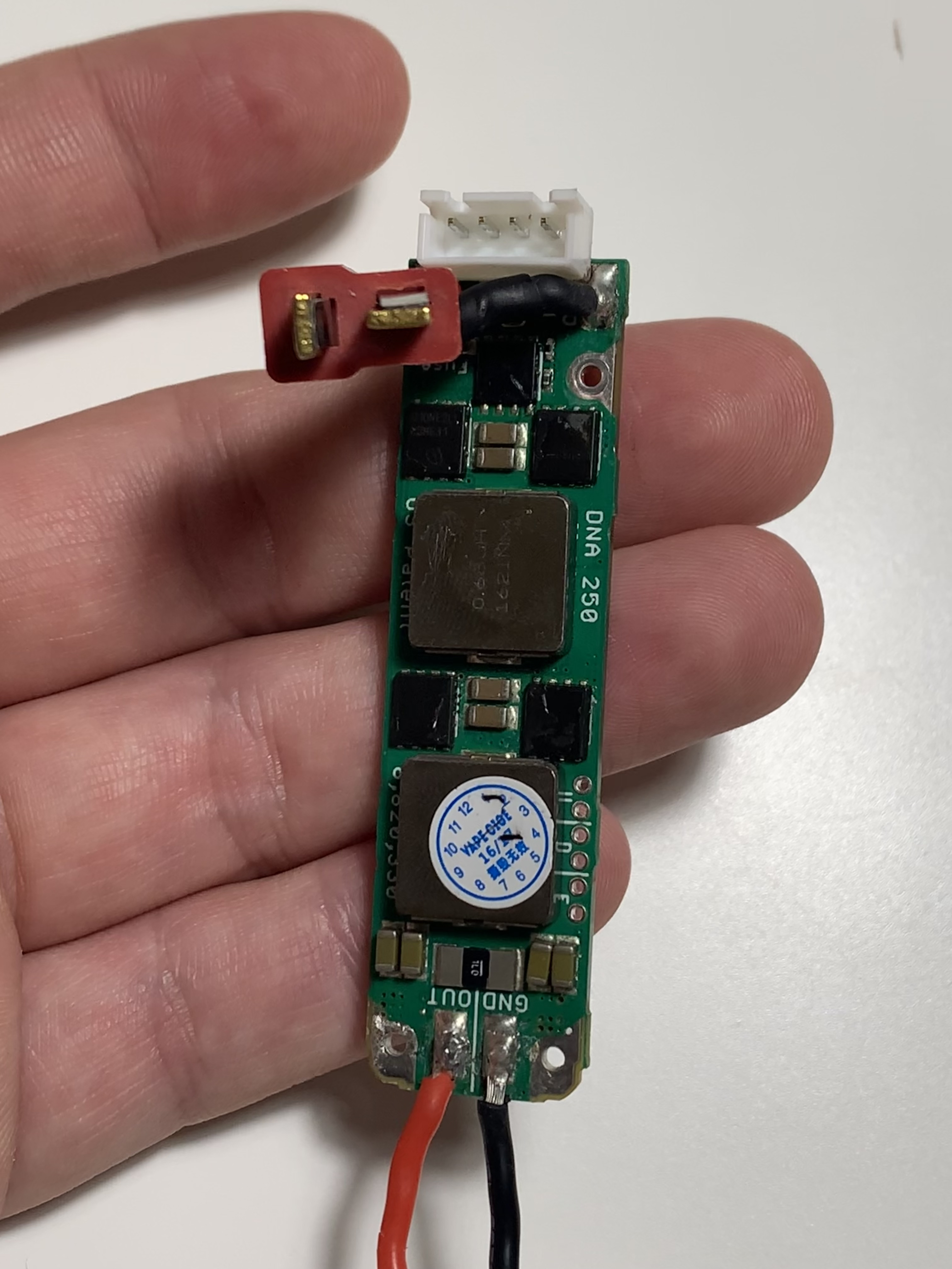

  8. Hello! Thank you both for your quick replies! I went into a shop and we have welded again the micro usb port but with no luck! The port connections are all good but the situation on device monitor is still the same and the battery still doesnt charge. I will attach the battery section on Mod. Using the multimeter tester, which part of the board do you recommend I check to see where the charge is interrupted? Thank you!
  9. Hello! My name is Riccardo and i have an old DNA250 board that i am trying to recover. The board i think is working ok, it is 5 years old but there are no problems in escribe. I bought a new lipo, 3S 11.1V 1300mAh and 14,43Wh but connecting it to he pc or to a power brick it is not charging. I assume the USB port works fine because eScribe connects to the DNA, and the T-Plug connections works too because the battery gets readed on too. I checked the Fuse continuity and it's 0.0 so the fuse is good. What can i test with the multimeter to see where is the problem? Many thanks in advance!
