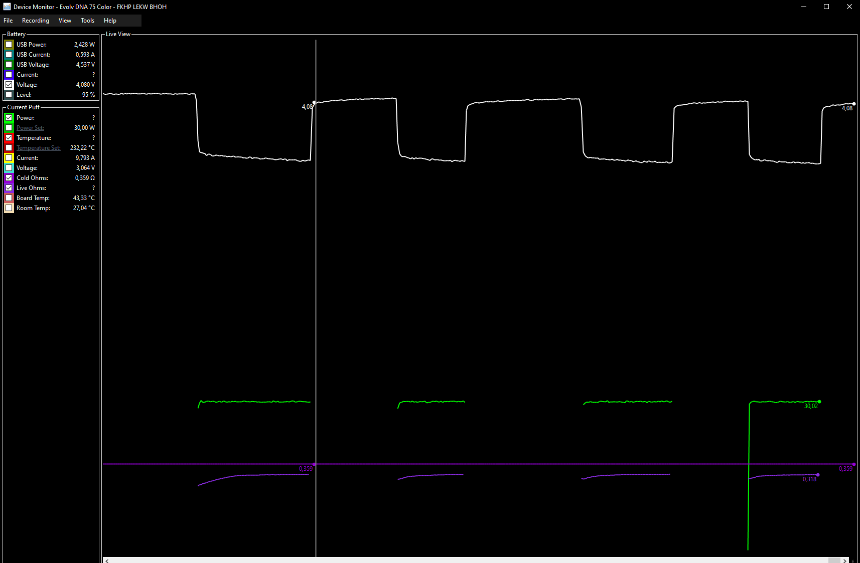

  1. Sorry for not getting back to you guys. The resistance was jumping in the atomizer analyzer but was stable but below measured when I fired the device as soon in my initial screenshots. So I took the Odin apart and noticed brown residue around the soldering on one connection. Since I didn't solder anything for years I went the easy route and ended up getting a Thelema Solo. That one reads stable resistance. Since I got a replacement now I will see if I can fix the odin issue if I resolder everything and clean the device. I figure there must have been some leakage through the 510 connector at some point. Thank you all very much for the assistance.
  2. Thank you very much for the in-depth reply. It is indeed SS316L, I tried normal round wire, superflat-quad and clapton. I spaced the coils but those I tried were all around between 0.3Ω and 0.4Ω so I will try a higher resistance build. As soon as the battery is low enough I will try the case analyzer and see what that does. The one thing that doesn't make sense to me is that the live ohms are super stable and it seems like TC would work perfectly if the manual measured value was the same. Setting the resistance manually does not help though. Thanks for all the info, I will try some more things.
  3. Hi everyone, first post here so I hope I am doing this right. I am running an Odin Mini 75C with a Juggerknot MR. The Odin is in use for a year now and works flawlessly, the Juggerknot is about two weeks old. At first it worked fine in TC but after about a week it stopped firing in TC. Since the issue is only with the Juggerknot MR I rebuild about 30 times, cleaned it multiple times and even got a replacement 510 kit from the awesome QP support. So the 510 pin, insulators and post were replaced. Since I can't find anything else I fired up escribe and did some testing which is why I am writing here, attached are two screenshots, one shows 3 measurements on a room temp coil. The room temp is showing 5-10°C above the actual room temp though. The other one is me firing in watts mode. As you can see the cold ohms reading is way above the live ohms. If I measure over an over there are jumps, sometimes of about .100 but the live ohms are always as shown in the picture. Live ohms are working as expected but for some reason the measured cold ohms reading is always way off. I searched for similar issues but couldn't find anything that helped. Do you guys have any idea what can be done to fix this?
