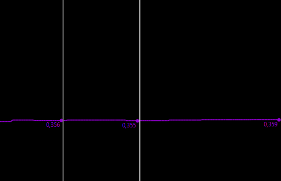

Since I can't find anything else I fired up escribe and did some testing which is why I am writing here, attached are two screenshots, one shows 3 measurements on a room temp coil.
The room temp is showing 5-10°C above the actual room temp though.
The other one is me firing in watts mode.
As you can see the cold ohms reading is way above the live ohms.
If I measure over an over there are jumps, sometimes of about .100 but the live ohms are always as shown in the picture.
Live ohms are working as expected but for some reason the measured cold ohms reading is always way off.
