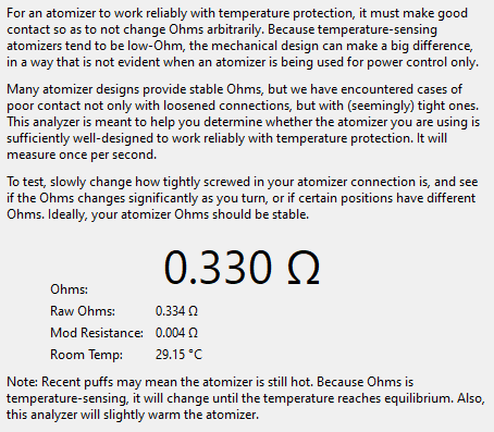

So I tried the factory default setting, interestingly enough when vaping in SS316 profile, it will not display the temperature protect message if the wattage is set below 40w (which is not enough to heat 0.3 ohm coils). This happens regardless of what temperature is set from 400 to 480f. With Replay, same situation regardless if atomizer is tightly screwed or a little loose. -

Hey folks, I'm trying to troubleshoot a rather strange situation I'm getting within Replay mode and the default SS316 profile installed on my Lost Vape Thelema 250c. When running firing in Titanium or Wattage mode, the mod fires as normal with a pleasant vape. The same can also be said within the Replay profile itself. Mod: Lost Vape Thelema 250c Service Pack: 1.1 SP45 INT Atomizer: Vandy Vape Pyro V2 Ohms: 0.33Ω Coil Material: SS316 Clapton (24ga + 32ga) Build: Dual coil (also tried a spaced build as well) However, hitting the 'save puff' button, is where the fun really begins. I am prompted with a check atomizer warning at the top of my screen while the bright green 'Playing' text is displayed on my screen. When I cancel out of saving the puff, the vape returns to normal. Can't seem to recall if I had this issue on replay with kanthal builds and sadly don't have any wire laying around to test it again. I figure okay, its a weird hiccup, so I move on to the SS316 profile and start fiddling around with my settings as shared below. Power: 75w Temp: 232c Preheat: 90w Punch: 5 Now I'm prompted with a temperature protected error despite being able to move back to Wattage or Replay mode and being able to fire the vape as normal. I decide to migrate my settings over to the other profiles such as Nickel and Titanium both of which are set for temperature control by default. Oddly enough these settings function as normal in both instances. From here, I figure okay there might be something really wrong with my build so I start doing some checks in the Atomizer Analyzer. Though I do see changes in the ohm reading after a 180 degrees rotation, I'd argue the change in ohm reading is negligible at best. Am I doing something wrong here, or are there any settings I can fiddle around with to get the most of out my 250c, given Replay is pretty much the selling point of this chip?
