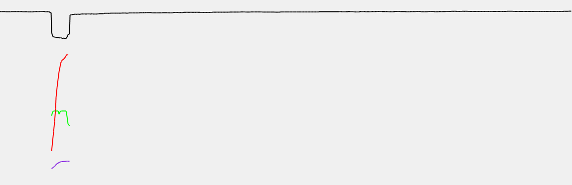

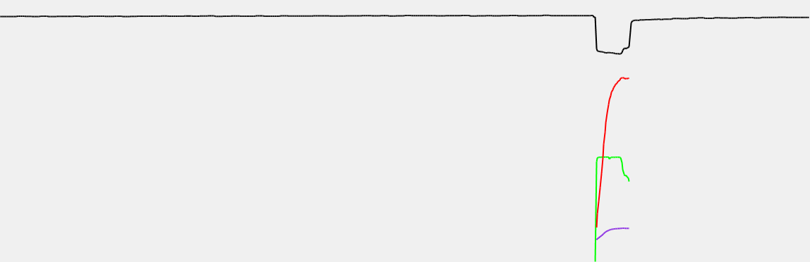

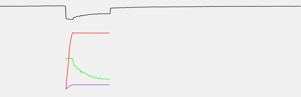

There, I figured out paint. Totally forgot about the snipping tool. You can see from the device monitor that it gives me max wattage regardless of what its set to.

I fail at paint, lol

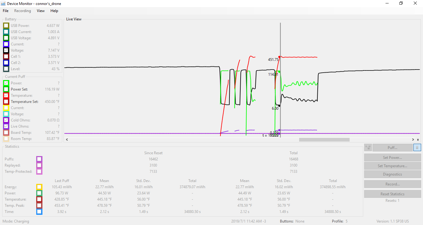

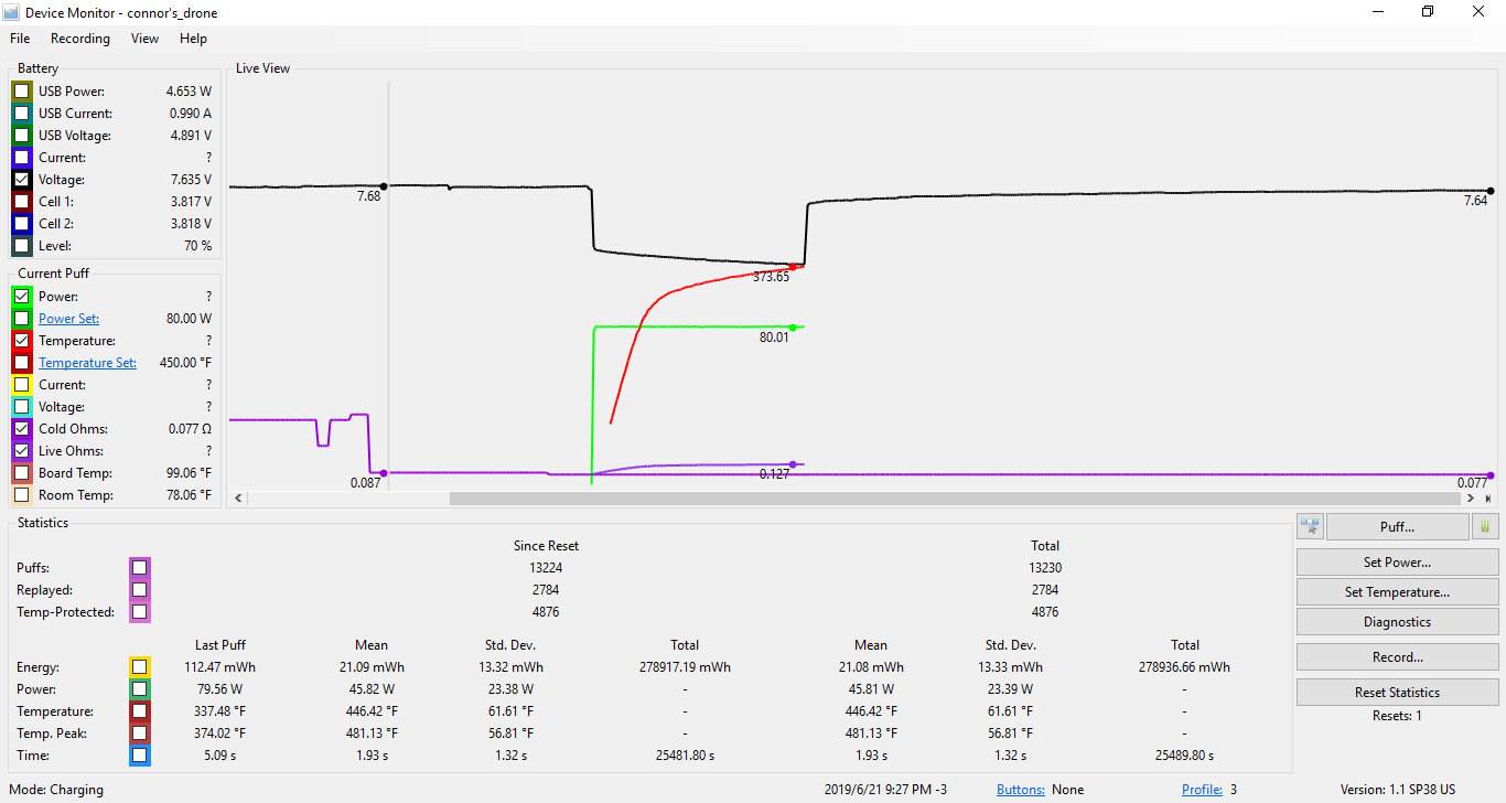

Im getting good results with ss430, fwiw. The following device monitor grabs are from aforementioned nifethal claptons, after adjusting the preheat and power as you suggested.

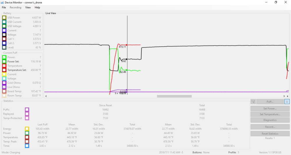

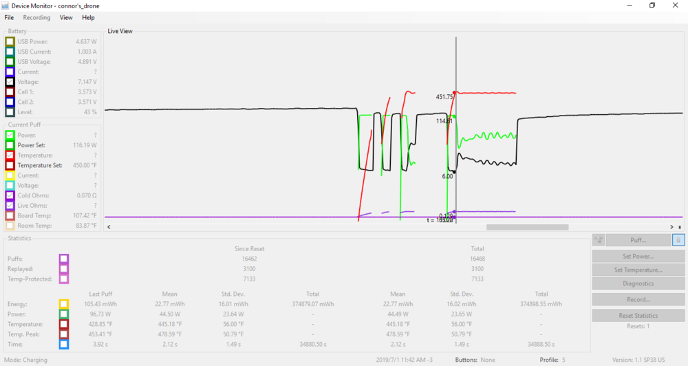

any idea where I could find good information about claptons and TC? I generated a custom .csv for the aforementioned nife48/ss316l clapton, but looking now, the values seem to be identical to the plain jane, exclusively nife .csv. *sigh* even after three months of perusing this forum and others, im still coming up with more questions than answers. Here are screen shots. I appreciate your help.
