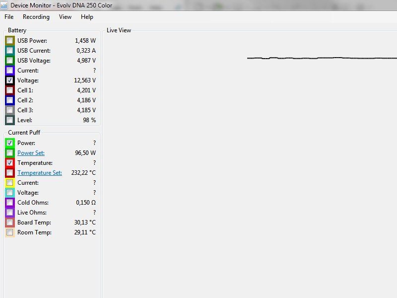

  4. Hi here is info on batteries, the problem as I written above, happens only with batteries that are fully or almost fully charged. Thanks for any help.
  5. I tried couple of times, but nothing... Does this happens to you only with fully charged batteries? Now mine are at 55% and when I put them out and back in, device wakes up instantly.
