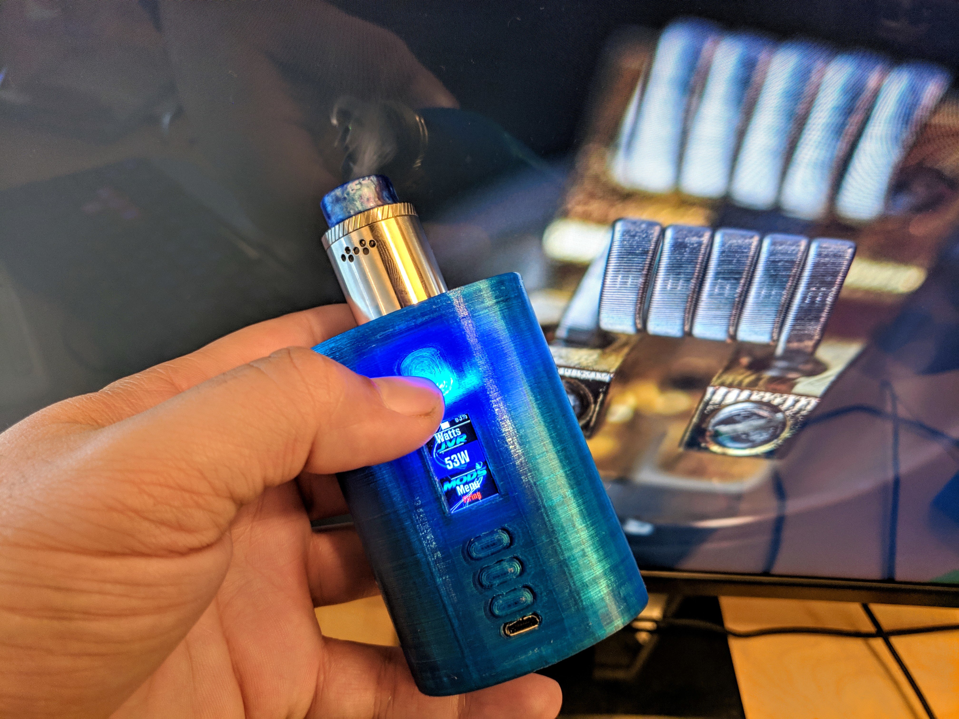

  2. So Fasttech has been out of the 510 you recommended to replace the SXK mod with. I finally broke the delrin nut on it and need to find one that works. I got the mod maker v6 but it's too thin since it's a low profile. Instead of waiting I just decided to finish my design of my own DNA 250c squonk mod that I had been putting off completing. But I would still like to repair the SXK mod. Also the sxk chip I took out of the mod I swapped the DNA 250c into screen went out completely and unfortunately as close as the DNA 250c screen is, it does not work for the sxk chipset. I guess my next thing is to see if sxk will send me another screen. I'd be better off just buying another mod if they want to charge me for one since the mod is still only like $38. Anyways let me know if you know of any other 510 connectors I can cut to the threads like the one you recommended. I appreciate how helpful you have been. Below is a picture of the protoype 3d printed mod I made.
  3. So mostly finished the design for my prototype DNA 250c squonk mod. There are a few things that need to be worked out on the final prints still, but for now I believe that I have a working prototype. I am going to assemble it this afternoon. I ordered a MM 510 v6 and it has the same neck that you showed me with the threads that will work on the SXK neck. The delrin washer finally broke on me with it so that device is out of commission until the new 510 gets here in the mail. I've looked everywhere to try, and find some type of elbow adapter like the one that SXK made for their boxer style mod. However there is nobody who even carries anything remotely similar. So I guess for now as you can see it will have to be pulled back the way the VTC device is stock. I did manage to make an insert tray with its own dedicated drain on it so that it can push the squonk bottle up against the back and separate it from the chipset.

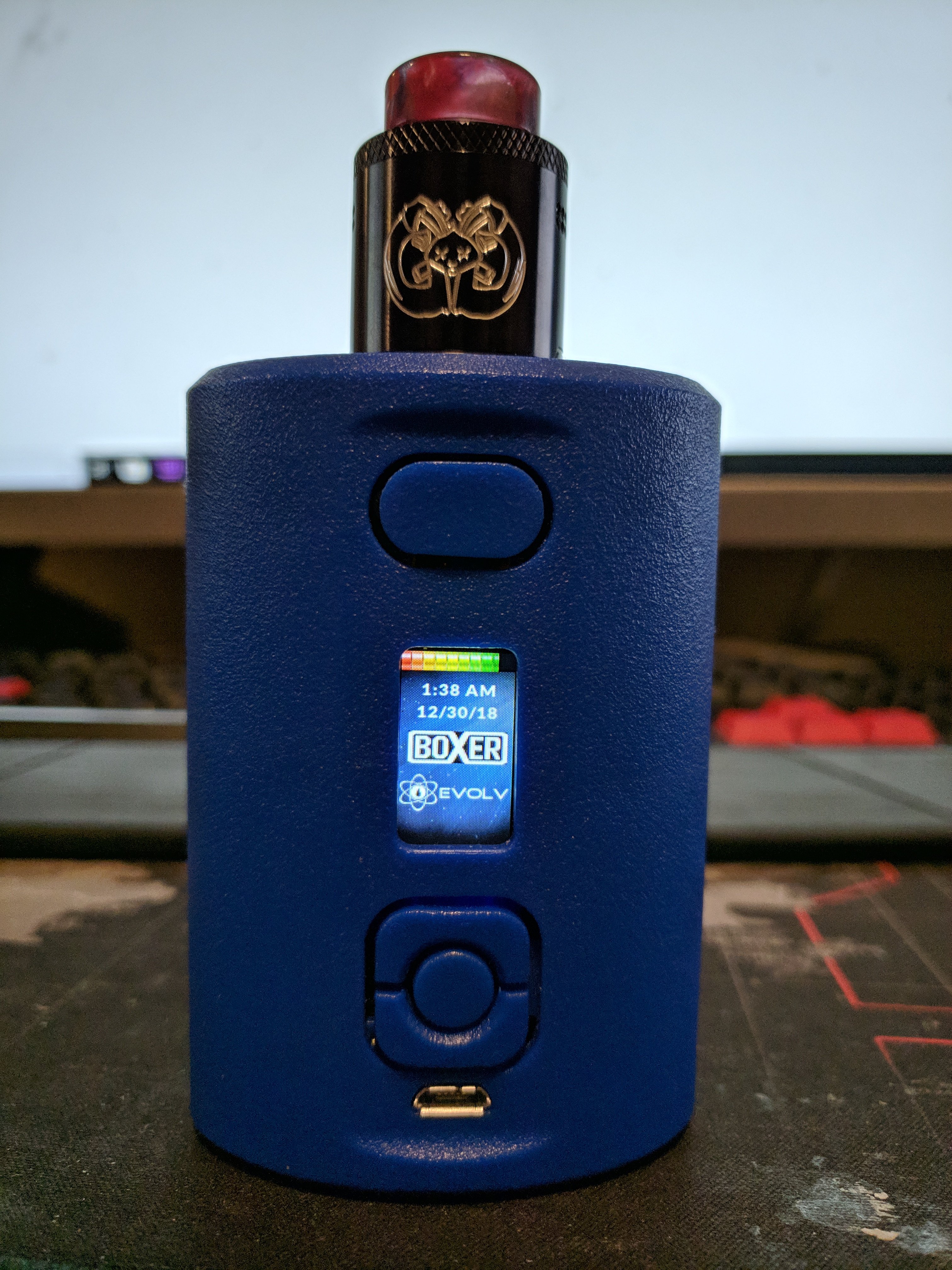

  4. Just gotta say how impressed I am with your work @AMDtrucking. It inspired me to start designing again. I used your pictures for the Boxer mod to swap in my own chip into the SXK body. Not as pretty but it gets the job done. . I am currently working on my own enclosures for the DNA 250c and I have two functional prints done but the quality of my FDM printers leaves more to be desired. But they are still usable and acceptable. I will most likely source out a sls print service to get the final prints made. Though FDM printing will allow me to prototype just fine and build a functional mod to test. I am probably a few weeks out for this one. The button sizes are different on the current one as this is the first print that I did and dry fitted everything to ensure it would be usable.
