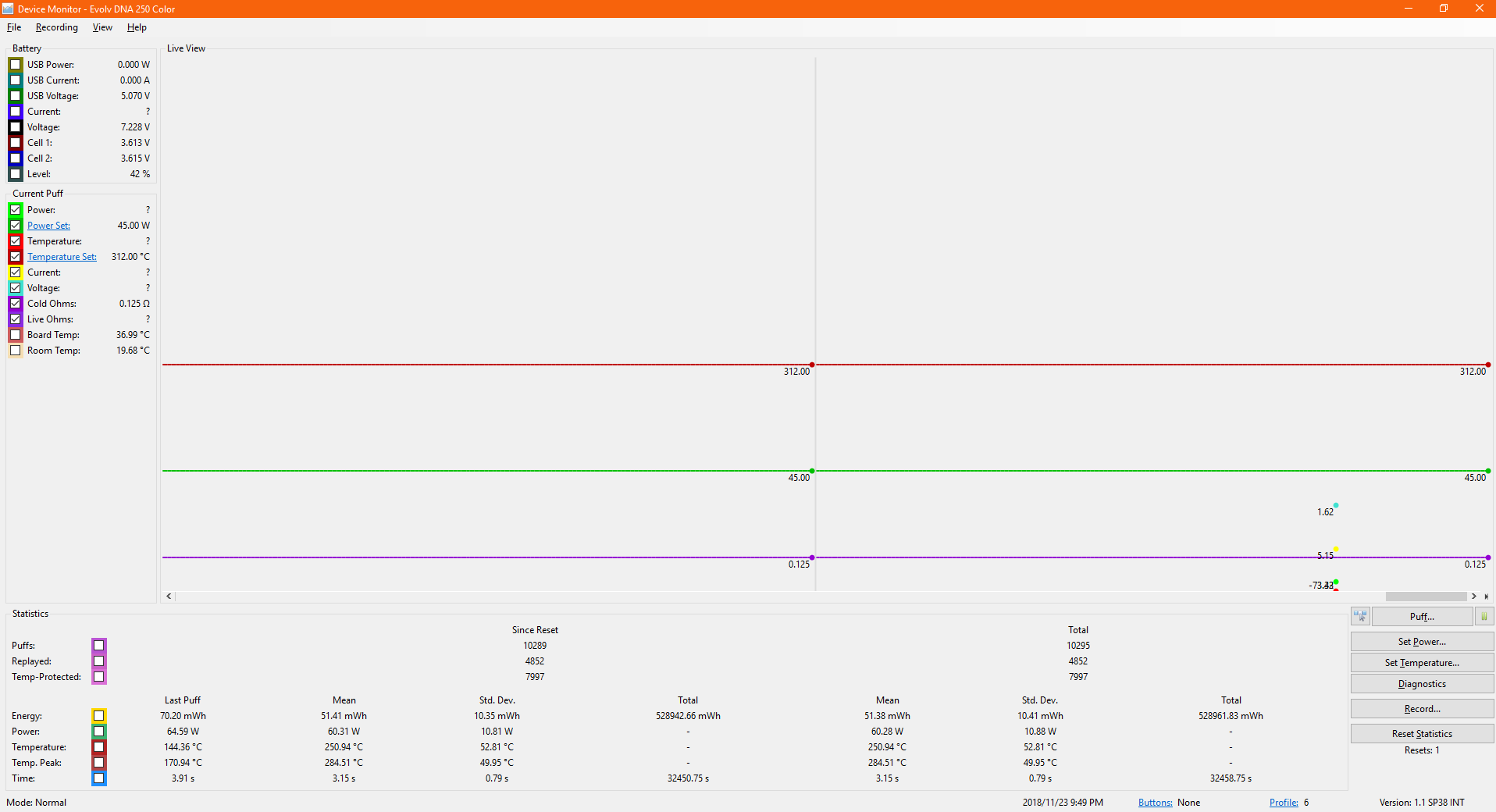

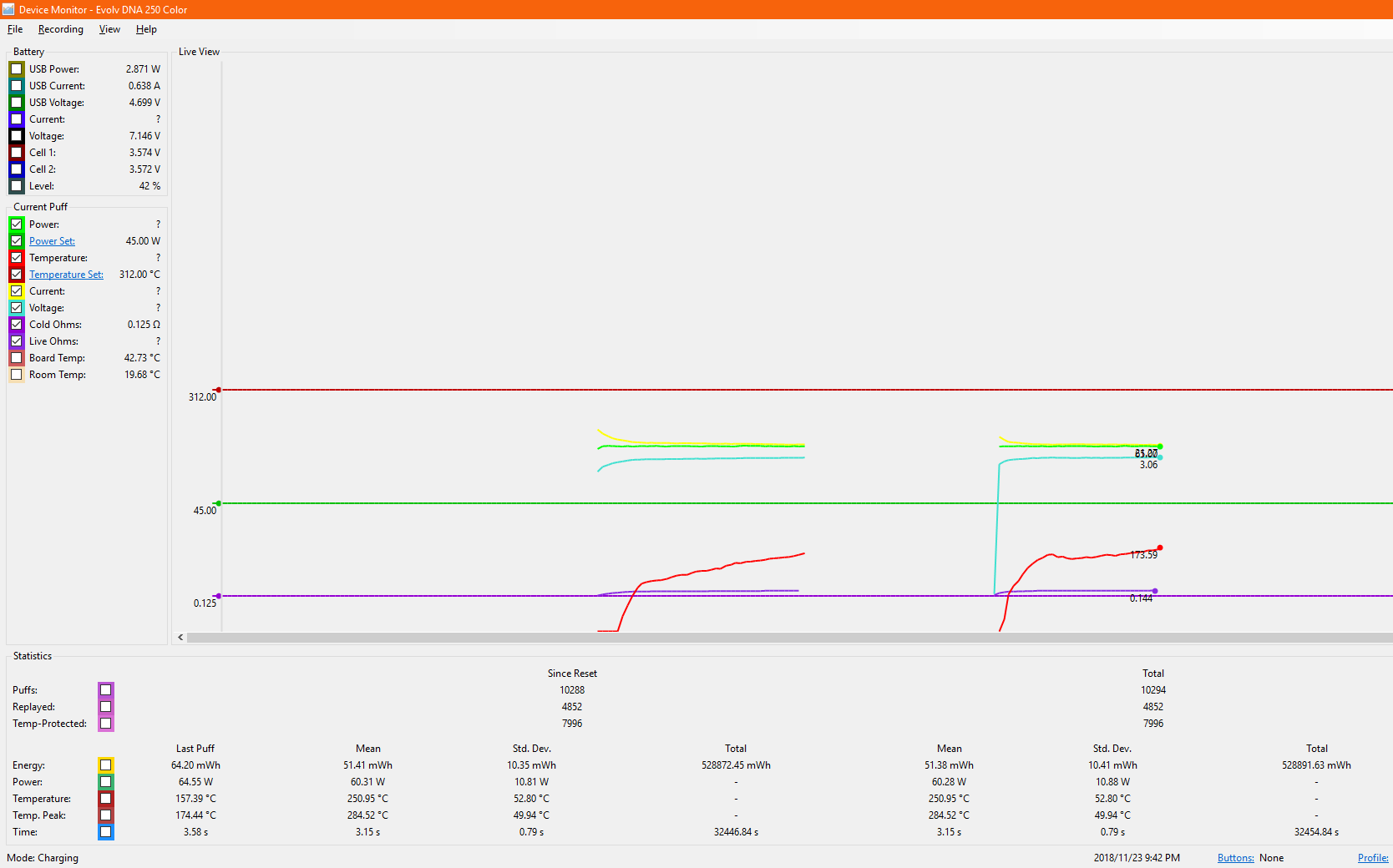

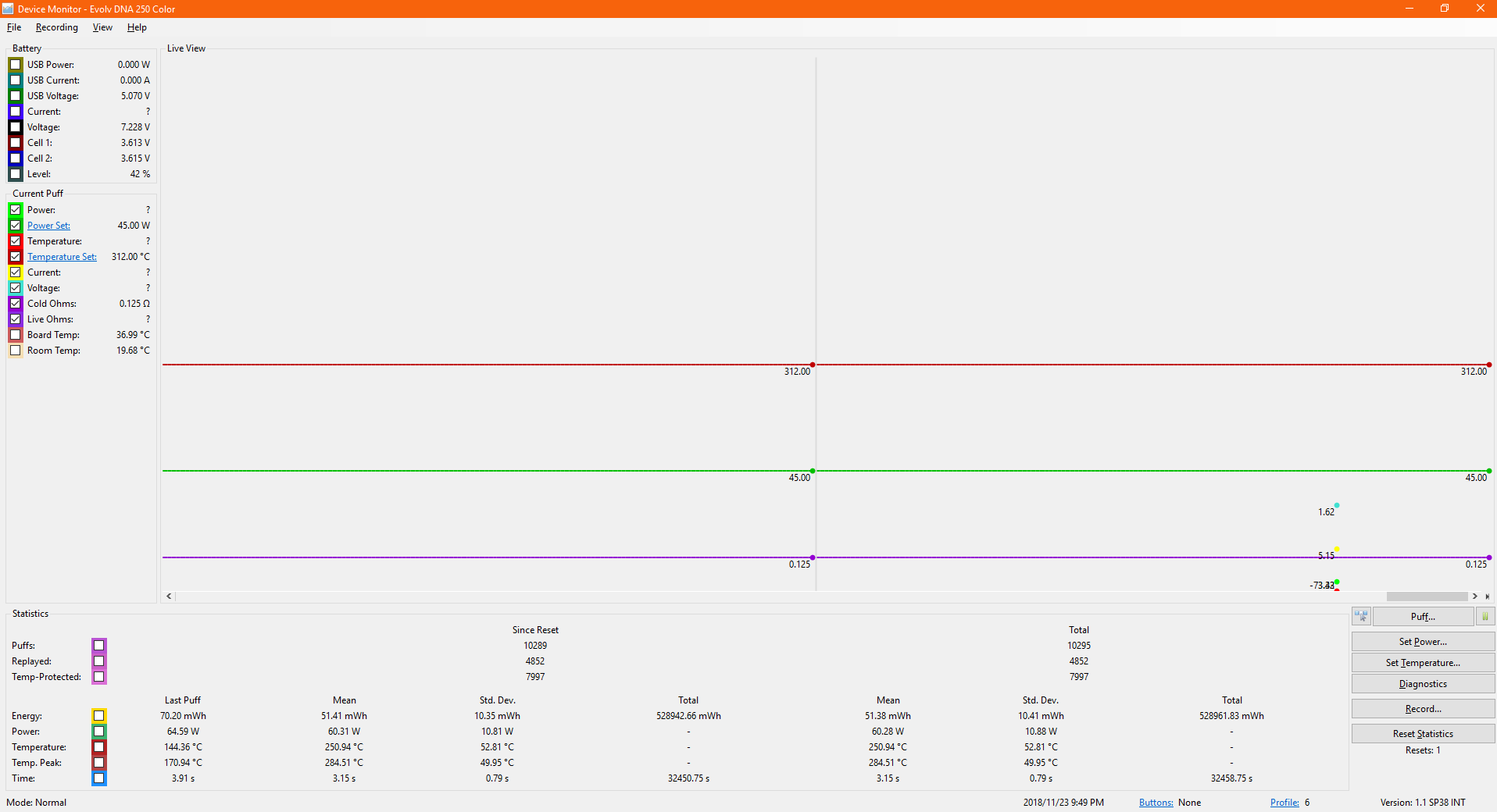

  1. Sure, This is a normal puff This is a "temp protect" puff which is happening all the time now. I have to use wattage mode.
  2. Well, after using the other posted firmware I had no issues. Yet today as soon as I change my coil, it starts to happen again. No reason behind it. Tank can be full of juice or nearly empty. Be charging or not. I have no idea what causes it and it's really annoying as I paid (what I consider) a lot of money for this and I have to use it in wattage mode going forward. Here is a normal puff Here is "temp protect" Doesn't show me anything I can work off.
