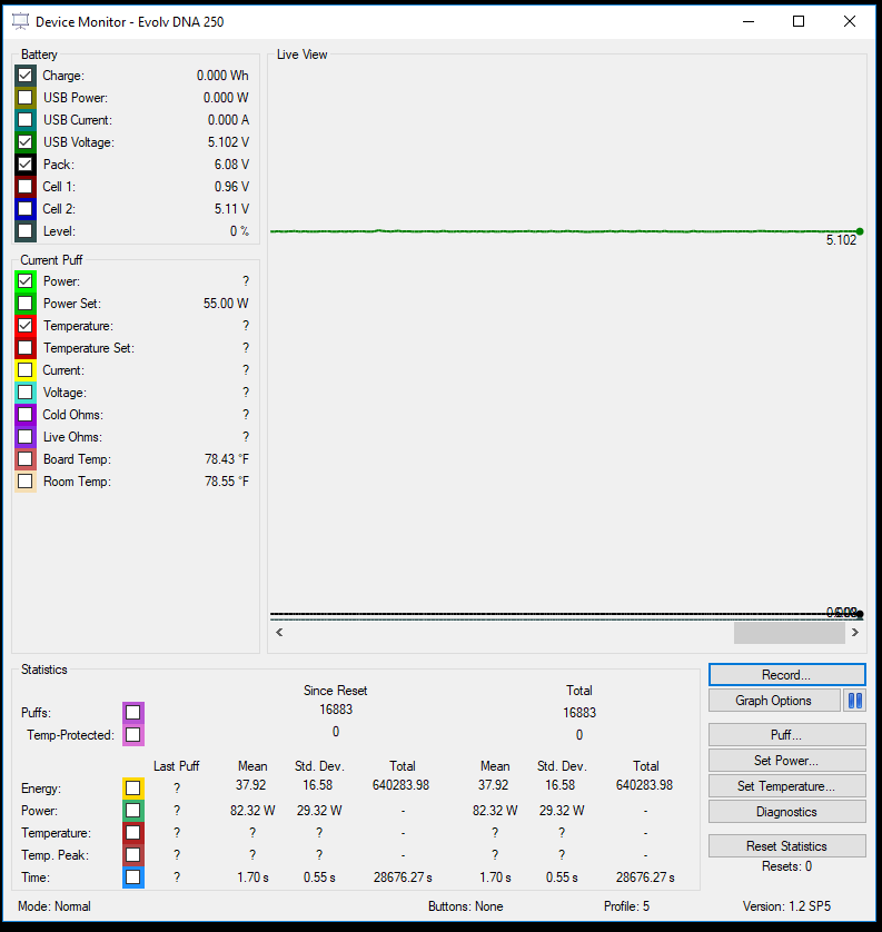

Getting the same error. Tried new batteries and nothing.
I changed the settings of the Battery to "Power Supply", when doing so, and disconnecting the appliance from power source, the vape puffs as usual, the only difference is I do not see the battery percentage and batteries do not charge (I can change the battery percentage from Diagnostics, just will just be a esthetic change). Set it back to Lithium Polymer, 2 cells, and again, "Check Battery" error.
Do not want to use it set to "power supply" as I am not sure if it will be dangerous, if it will harm the batteries, appliance, etc.
