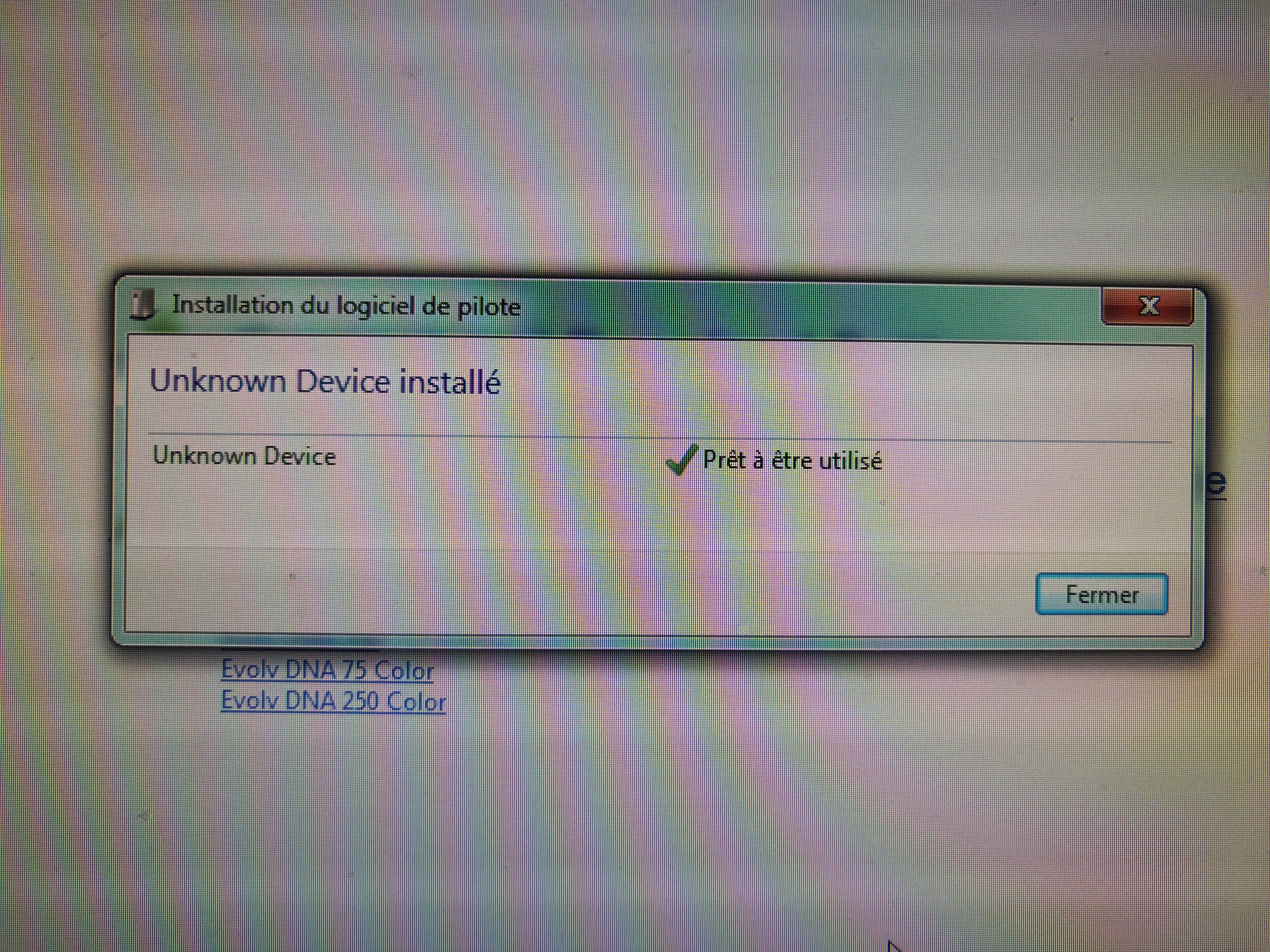

  1. I made a ticket after posting my last update, i'll wait their advices now. I'll post news later, maybe it will help some people.
  2. I have now connected my mod to escibe, tried again many factory reset and new parameters, still not working. I tried to set the battery manually, make some clock reset in monitor etc but still nothing. My mod is still stuck on 4% battery with check battery message (with or without battery), still on clock error, still not recognizing the tank so unable to fire (0.00 Ohm tank or not). Fire button now functioning to turn on/off the mod but it's not working anyway, so when i gon in the menu of the mod (manually or by monitor) i can see error clock everywhere (can be seen on photo). On monitor, i have a text on the bottom of the screen : "BAD" Which sounds like "BAD NEWS"
  3. How frustrating when it crashes at 90% when sending parameters to chipset
