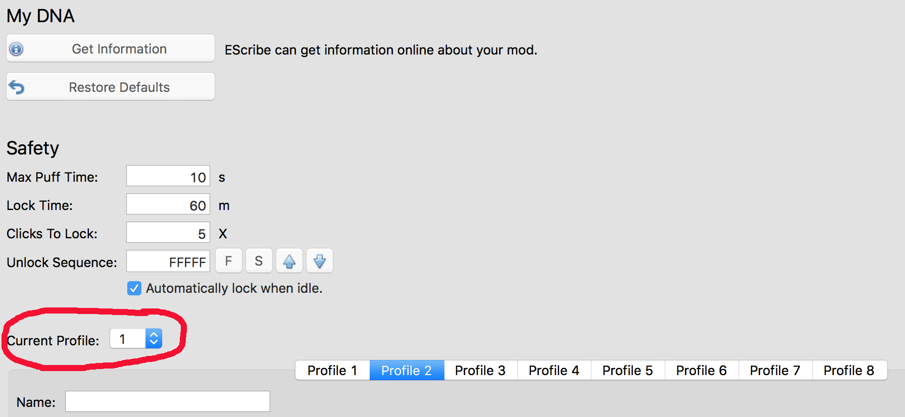

  2. What is the purpose of "Current Profile" in EScribe for the DNA75 Color? I don't recall seeing it for other DNA devices. Is it necessary, and if so, what is it's purpose? With my other DNA devices, it doesn't ask for a current profile and I just change the settings for each of the profiles, regardless of the profile the mod is currently in. It seems to be redundant, and I don't know if I should change it, or simply ignore it and adjust all profiles regardless of what profile my mod is currently in. Thank you!
