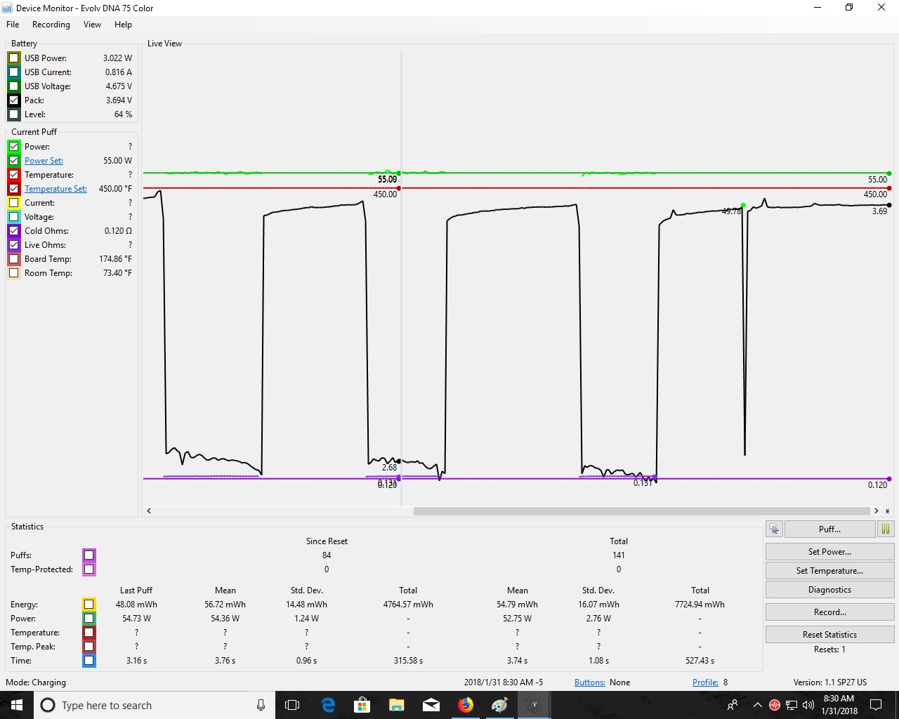

    6

  3. Ok, so after talking to 3 different companies and you guys I got the retailer to answer and all they said was take a video lol gingervaper has answered me and said this - Yes, from that graph it is showing the sag on that battery is extremely great. Your losing a full Volt (3.7 down to 2.68) You can make sure the +/- contacts are expanded so that that battery is fitting tight, but the biggest culprit here is going to be the 0.12 ohms build….. its just way to low for a single battery. I would strongly recommend a 0.4 - 0.60 single coil build with this chipset and

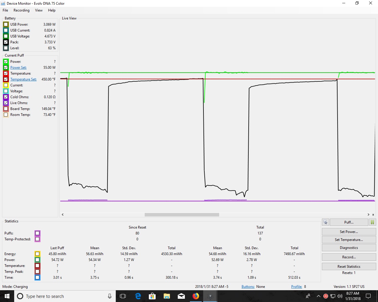

  6. Hello everyone, New to dna devices and squonking in general but I bought this expensive Boxer dna75 and Im just learning it aside from everything being wonderful and me loving it I get the check battery warning at 65% and below at 55 watts now im using a single Ijoy 3000mah 3.7v 20700 and Ive seen numerous issues with this on here after searching for a fix with this one but never really got anywhere I was thinking it could just be the mod but why sell such an expensive mod that can only last 15 big puffs before its at 65% and weak battery? I will post my diagnostics when the weak battery warni
