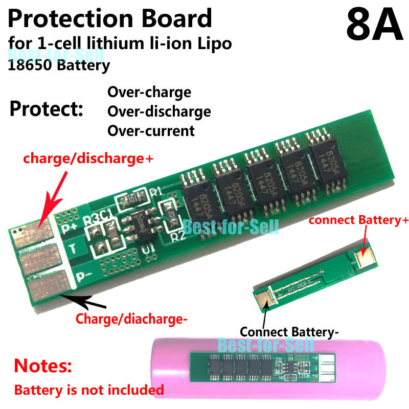

Solution C - Individually Protect Each CELL with a 1S BMS, AND use a 3S BMS together. It sounds ridiculous, I guess. But somehow I think it will work, but not as great or wouldn't be recommended.
