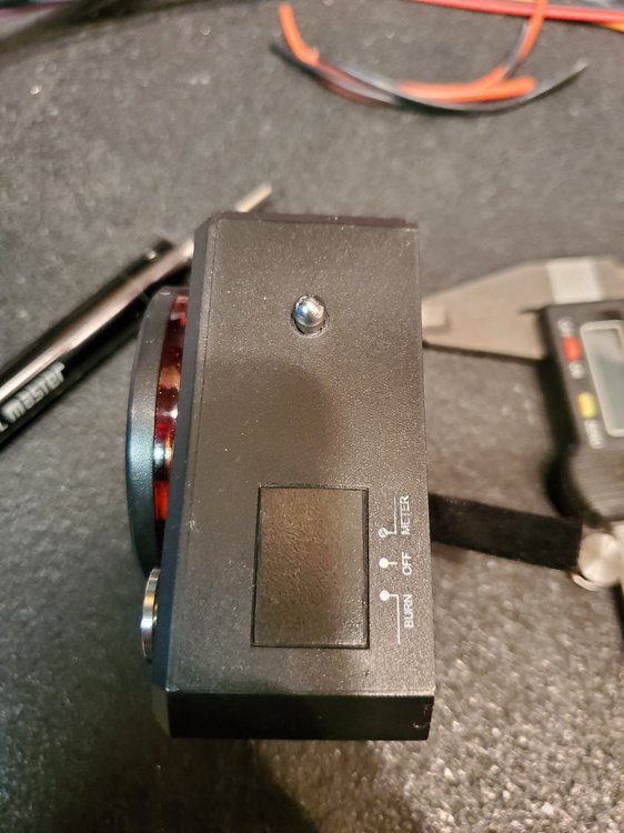

  1. I recently converted my Coilmaster 521 TAB to a DNA75C board. I'm using a horizontal layout theme which works well but was wondering if anyone knows of or has created a theme specifically for an OHM reader/coil tester? Any input is appreciated!
