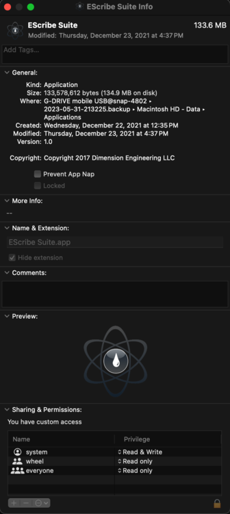

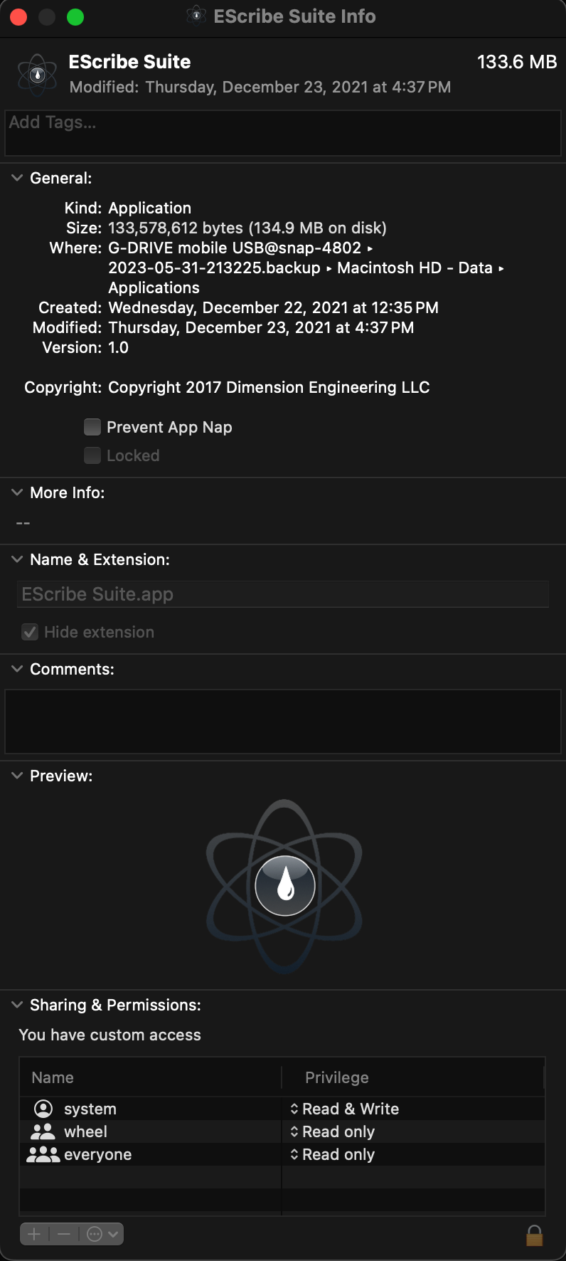

	Sorry, I'm guessing you want screenshot with the no compatible devices found and photo of the mod itself? Here's those let me know if it was something different. A few new things, using the international version finally got me the EScribe window and I can adjust settings/themes clicking device monitor from there same error. Keep thinking it needs me to link my mod to my account? Haven't tried download or upload again since download didn't work. The last pic showed up when I installed EScribe but wasn't sure it was part of it. Apple says it is for something called HID to allow an online site to interact with various controls buttons etc. on my computer, is stored in login items but I took it off just in case. Maybe that's why it can't detect mod? Oldest version #1 of EScribe I have backed up is from 12/22/21.
