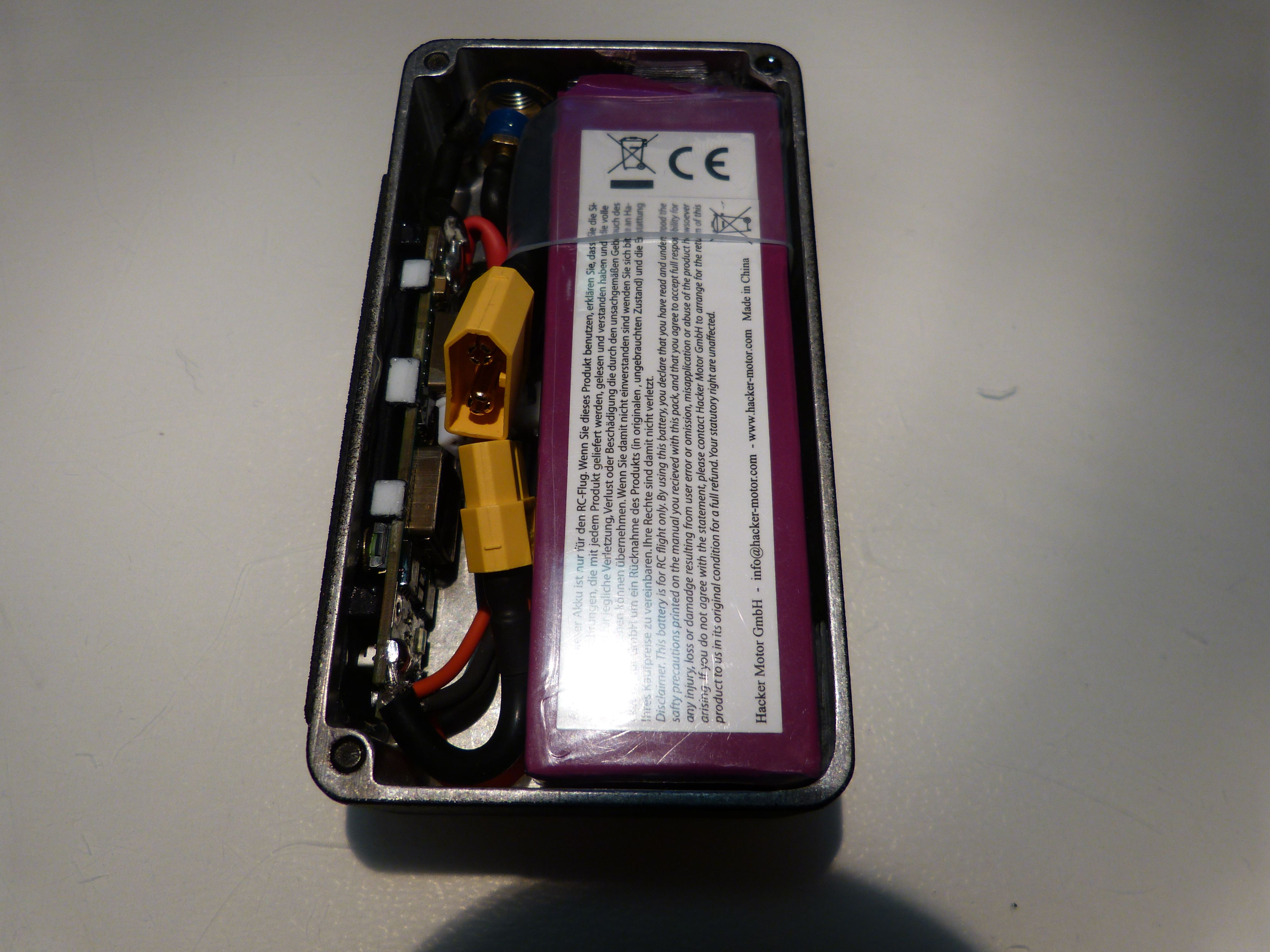

  1. Hi Guys, I´m Patrick from Germany and I want to show you what I´ve done with the help of Mamu´s Faceplate. For me it is an easy Way to mount everything. The Lipo that I´ve used is a 3S 2400mAh 20C and it works well.The Box is Hammond 1590BBk Greetings from Germany

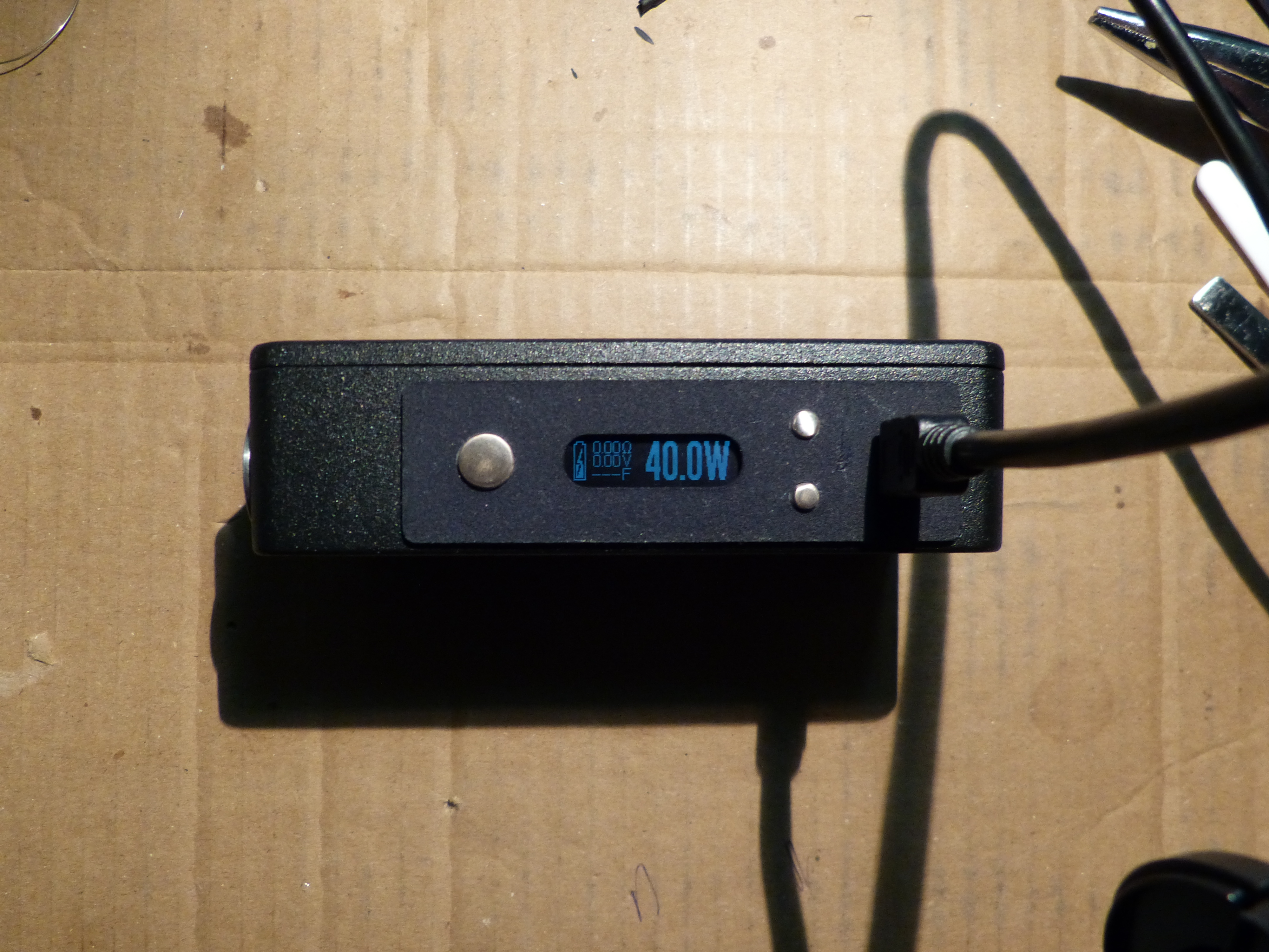

  2. Yeah, that was successfull. Thanks to justchil for support, you are a great Guy. By the Way , we created a good Toturial.

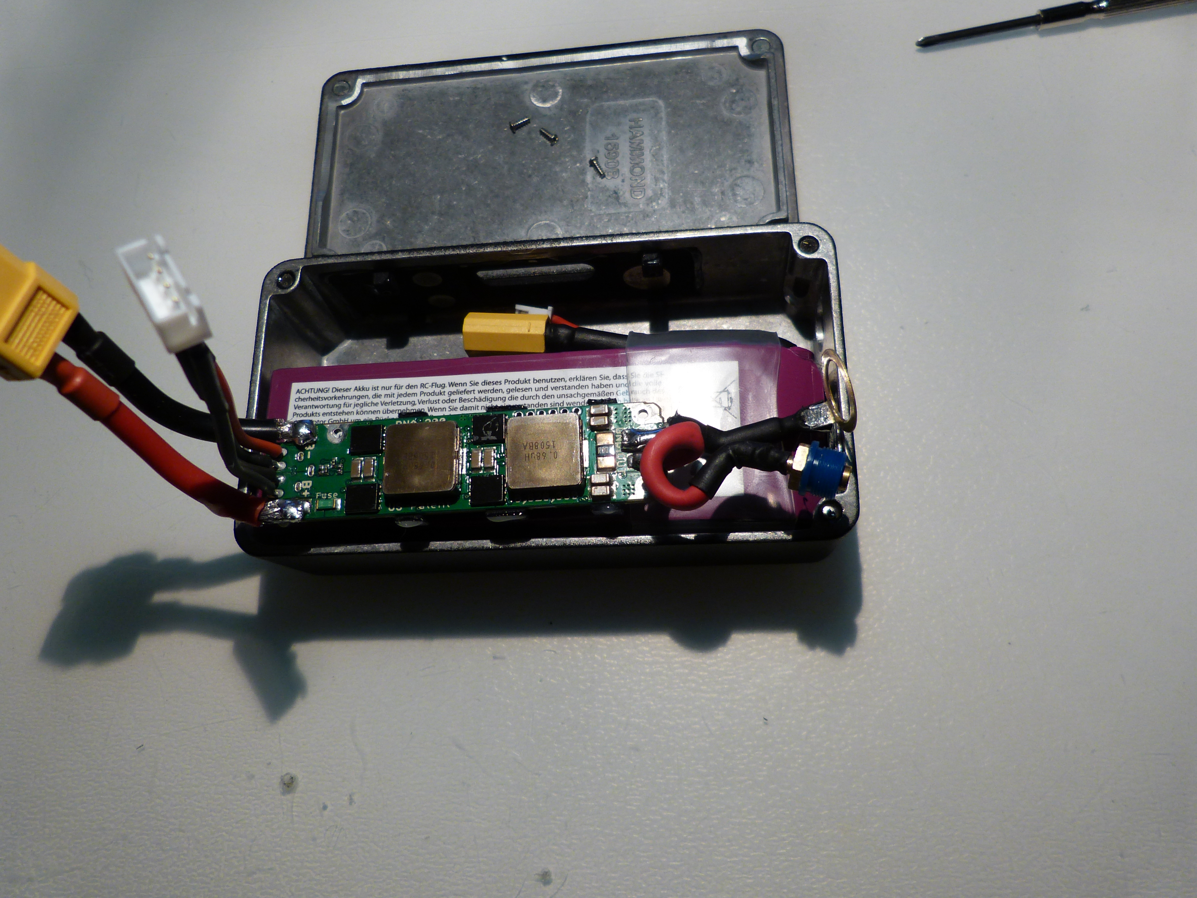

  5. I think that there is something I´m not able to see. I controlled everything and Doubleckecked it. Seems to be more complicated.
  6. The solderPad of the Fuse is OK. Or did I understand wrong?

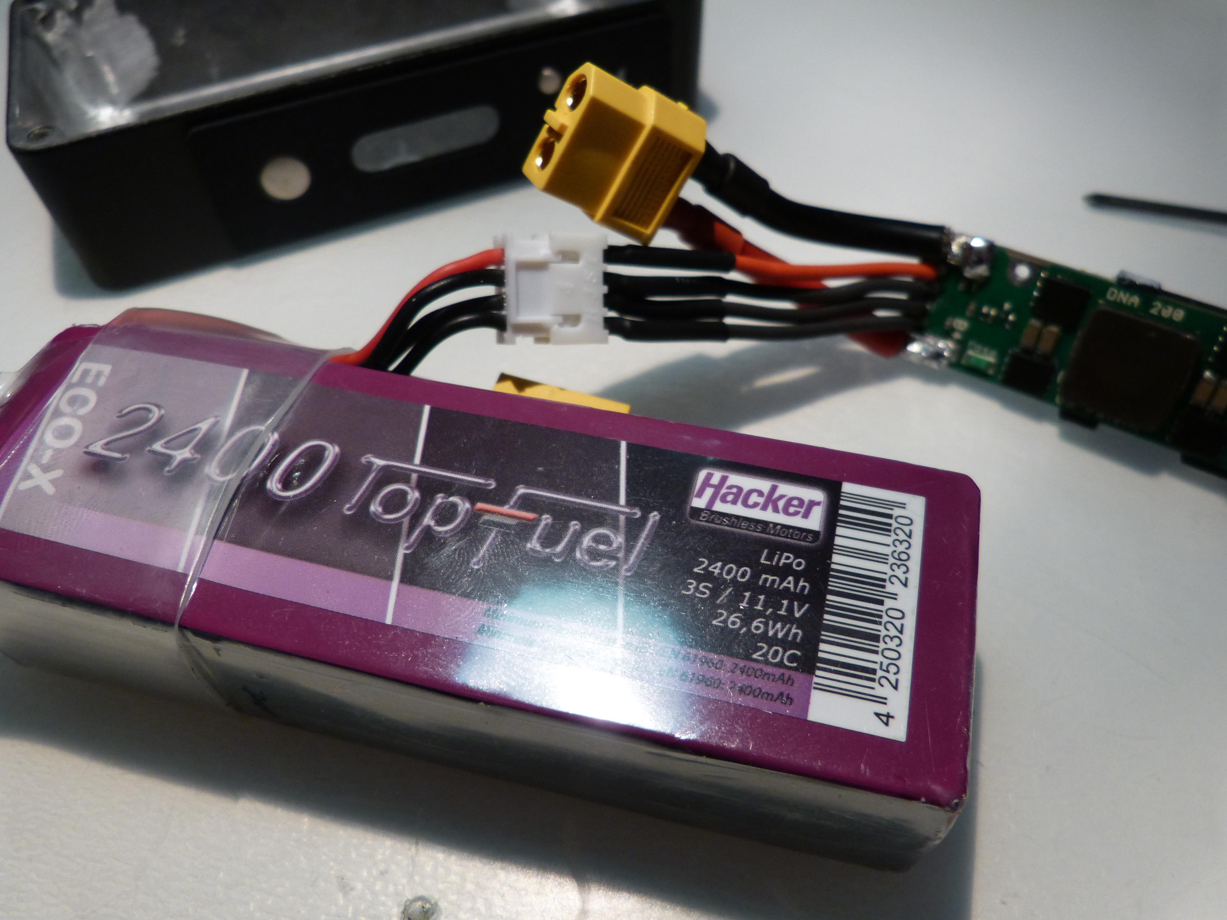

  7. I just followed the colours of the Lipo-Pack. There is one Red and Three Black ones. When I messure between the Red and the last Black one, I have the full 3S power.
