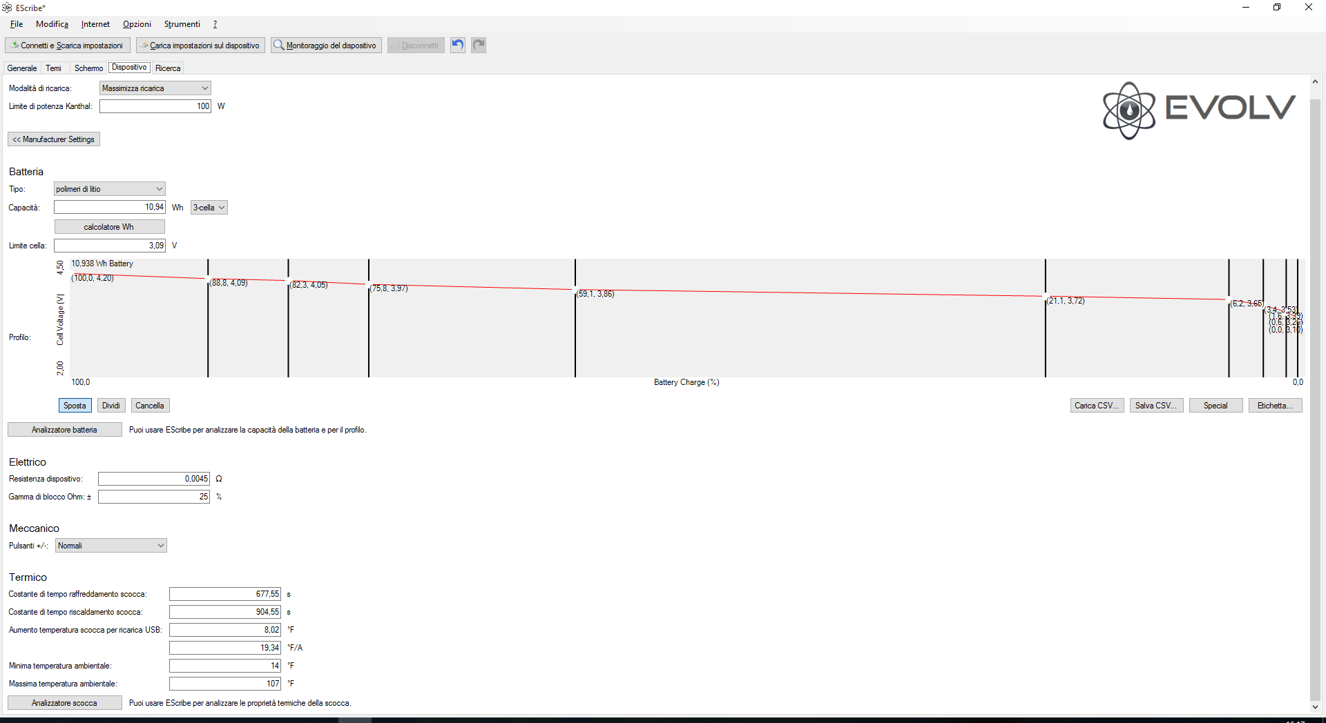

  1. I measured mod resistance shorting 510 thread with a huge copper wire, it results 0.004/0.005 ohm, i set 0.045 ohm in mod resistance, according to previous posts it should be fine. It should be safe due to the fact atomizer resistance isn't considered here and it will always be over 0,001 ohm. However I finally ran case analyzer and battery analyzer and these are Hcigar VT200 results, do you think are they fine? I attached battery profile, just rename it from .txt to .csv Moreover, I see that using very low resistance coils like I did will take in troubles in TC mode. I used 29AWG nickel200 because it's really hard to make a proper coil and insert the cotton with 30 or 32AWG Then yesterday I made a ribbon wire with 32AWG nickel and 29AWG kanthal DNA200 reads 2 parallel 7/8 wraps coil as 0.151ohm I calculated the right temperature curve using steam engine Like so I have no trouble with TC I really hope I helped somebodyLabo_Hcigar_VT200_Battery.txt
