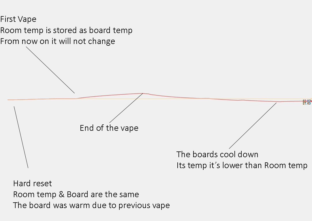

Hi, I have a Vt200, I noticed that room temperature reading is always wrong. Right now room temperature is 62,6 °F, I'm sure the box has the same temperature, it's been 2 hours that I'm not using it.  When I attach it to Escribe to monitor the Temp I can see that the board temp is fluctuating (it raises when I hold it in my hand), the room temp instead is always the same (73,88 °F)  So there must be a problem and ohm analyzer can't correct ohm reading @ 70°F the right way.  Any help?  EDIT: After a Hard Reboot from Escribe the Room temp started fluctuating, but it's always too high 78,73 °F vs 62,6 °F, could you add a programmable delta correction?  EDIT2: After the first vape after the hard reboot room temperature stops fluctuationg and remains the same, maybe a firmware bug? I'm on latest firmware with Escribe 1.034  EDIT3: The only way to make it work is to do a Hard reboot, soft one doesn't help. BTW Delta correction will be helpfull.
