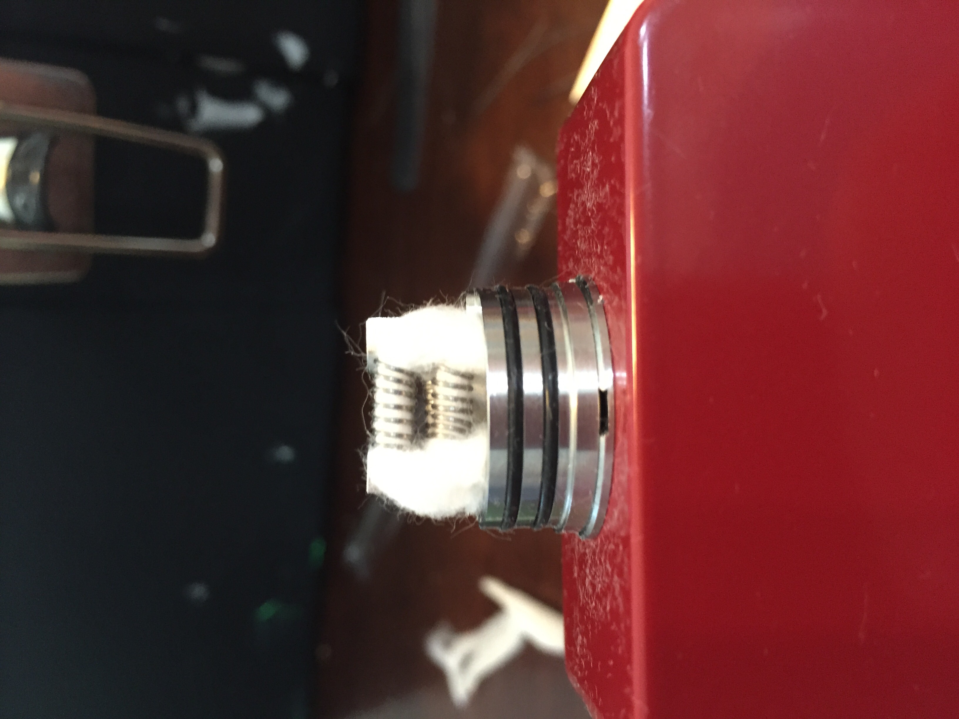

  2. How's the Velocity with temp control builds and this DNA200? Is it one of your favorites? I'm getting ready to get an RDA or two that will be used mostly for NI200 and Titanium Gr. 1, and I'm trying to decide which ones, leaning towards the Velocity, Dot Mod Petri, and derringer. But I haven't decided which one I'll get for sure and which one I'd place second in case I can manage to buy a second one. It's a nice looking box by the way, and its yours, and I think anyone having a DNA 200, and especially have 2 of them, is special [/QUOTE] Thanks! I love the velocity. It has been my go to RDA. Running quad Ti in it right now. The derringer is good for temp control also. It's my number 2 right now.
  3. I just threw this build in my velocity. Amazing! Mine came out to .08 on a 2.3mm post. Not as good looking as yours.

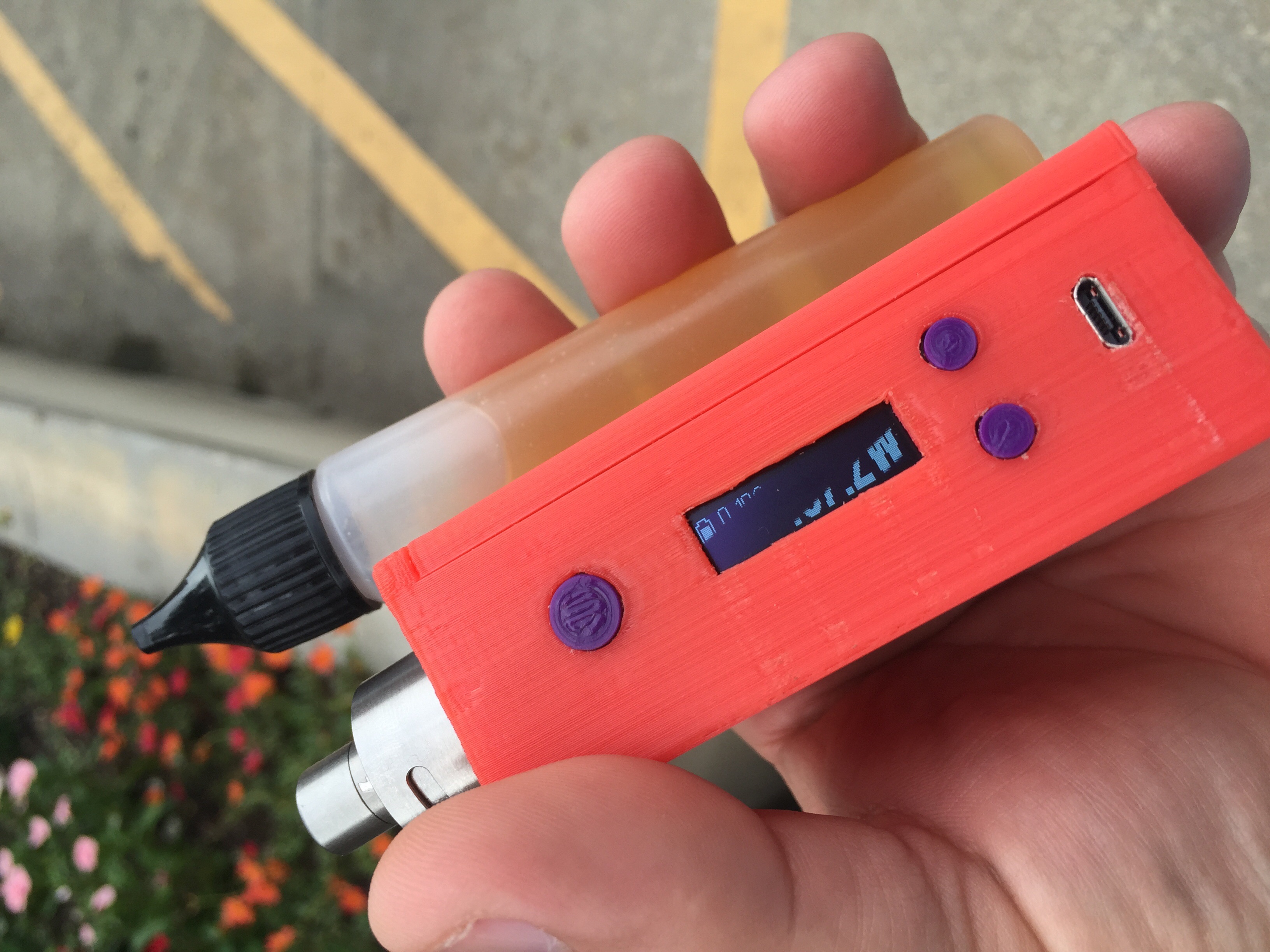

  4. My 2nd box. Nothing special.

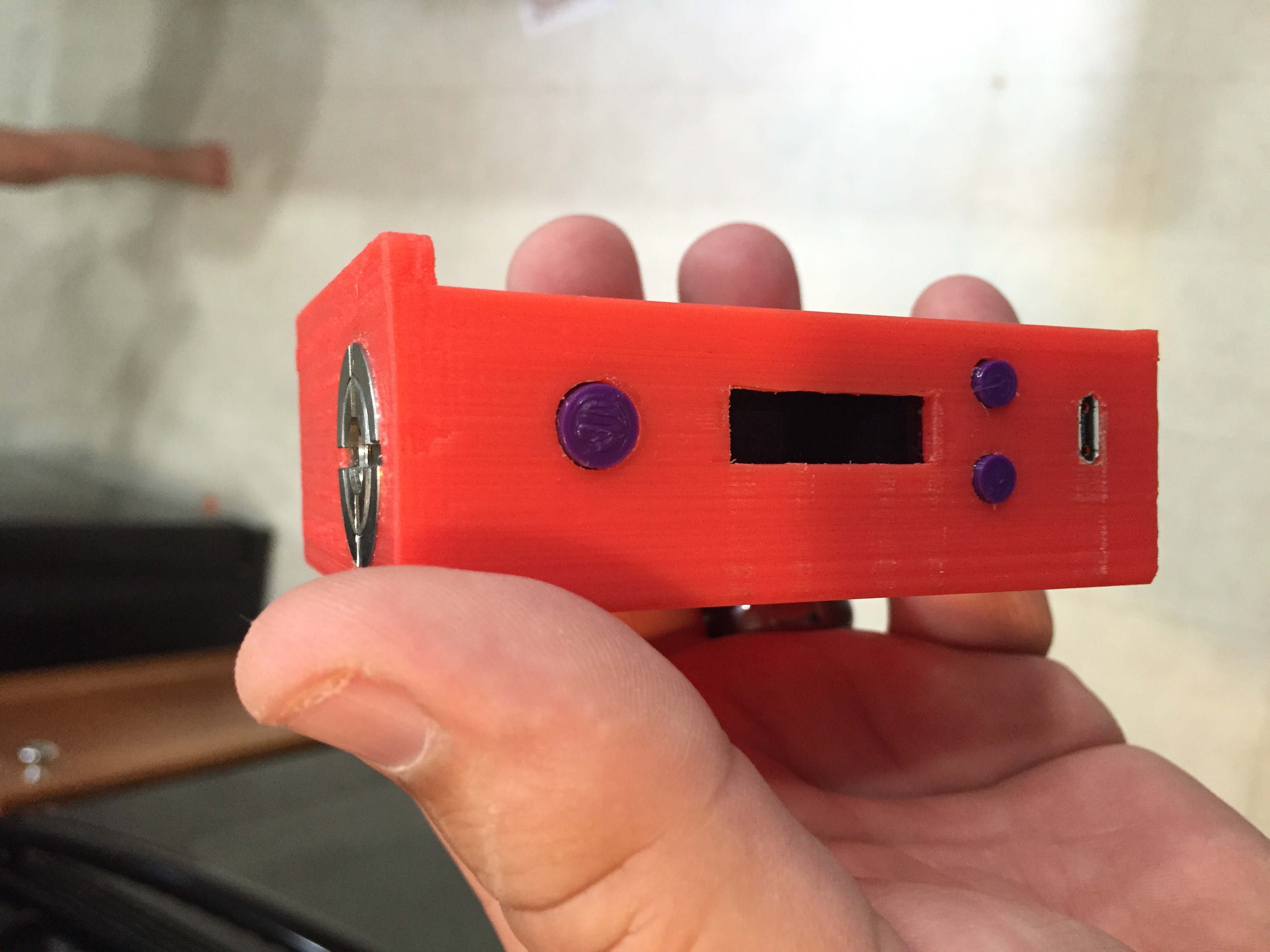

  8. I'm feeling pretty inferior with my printer now. My case took about 7 hours total to print.

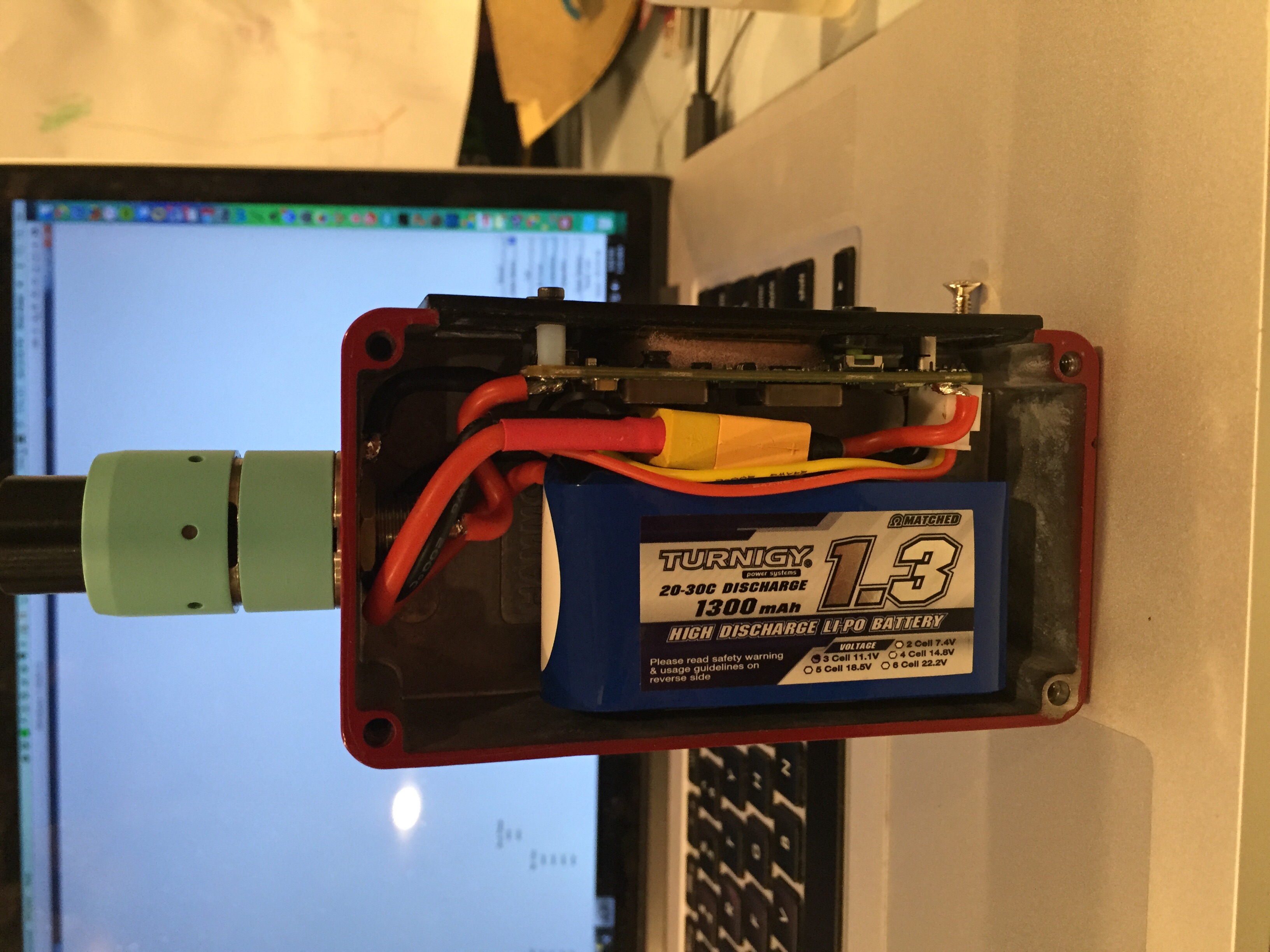

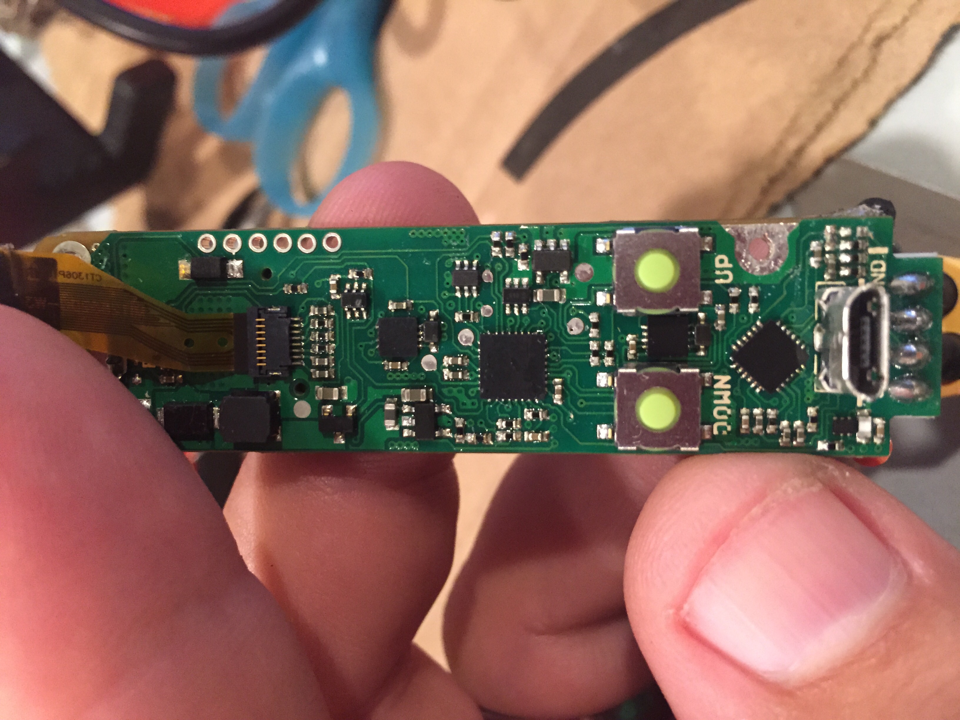

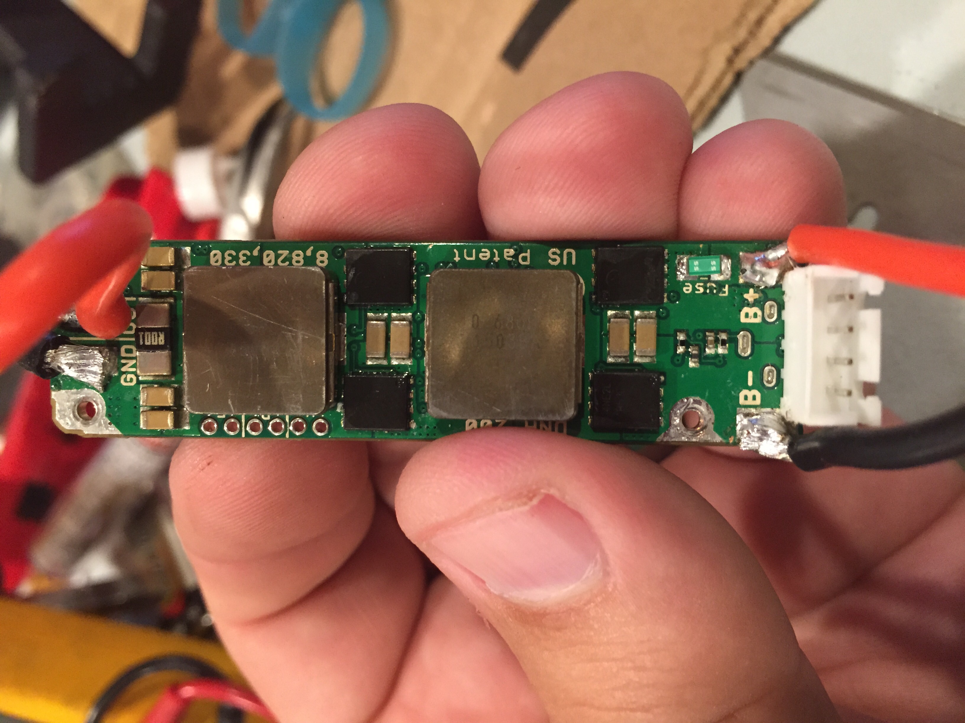

  10. From reviewing my own pics I think there is a component missing on the board around the balance connectors ground.
  11. Pack is reading 11.54 All 3 cells reading 3.845 Not reading any shorts across the balance connector on board Validated continuity from b+ to the far side of the fuse See attached pics Thanks again! Rick
  12. Thanks. I'll get all the info together and get it posted. I'm thinking something board side. Hope I didn't knick something. I did test the pack and balance connector and everything looked good.
  13. I am attempting to use a Turnigy 1300mah 20c pack. When I connected the first pack the fuse blew and the monitor read 0 volts on the first cell. I thought it was a bad pack. Got a new pack(same model) and replaced the fuse. This time it didn't blow. It still shows 0 volts on cell 1. No charge happening. It will power on the pack as long as the fire button is held. Once I let it go it shuts off. On usb I get a check battery if I try to fire. Please advice. Thanks, Rick

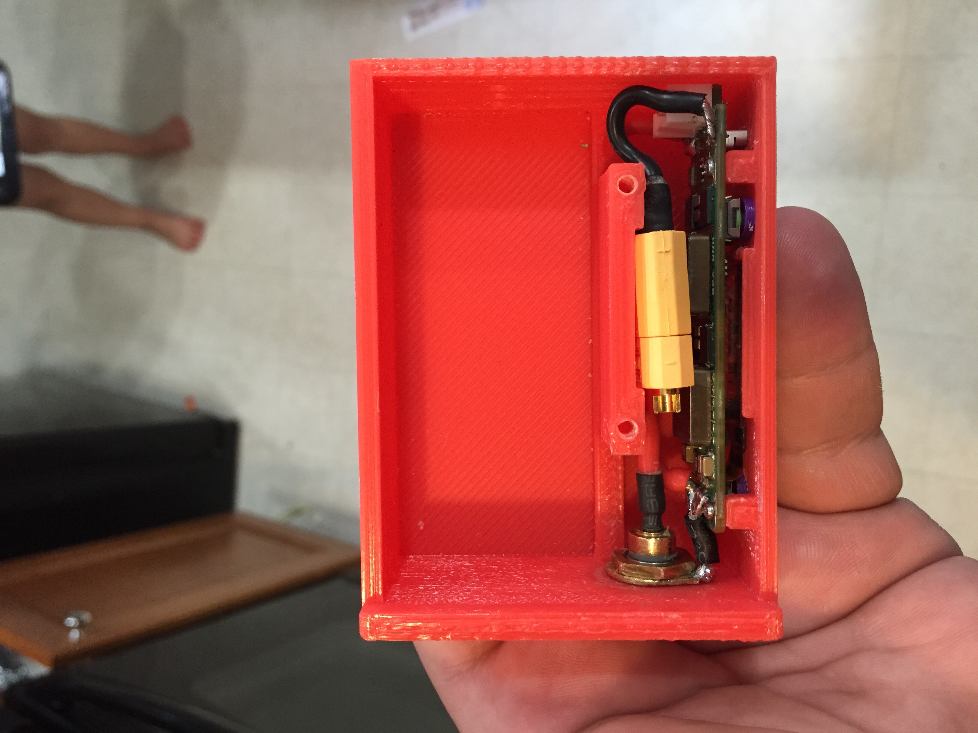

  14. Here is my first prototype. Still waiting on my lipo.
