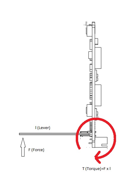

I am applying T=F x l rotating torque on the socket using the plug as a lever as I described above This unfortunate move can be described as flexing or rotating or moving upward or prying or whatever. But this is it: To rule out the option that an upward torque of given magnitude applied on the socket causes the problem we got a very simple solution: Please confirm that a fully functional board tethered via a fully functional USB can and always should read resistance via Atomizer Analyzer when the fuse is blown. If this is the case, than it is my cable(s). If not, it is the socket. There are no more options.
Well, I think you don't get it. All of the cable reads/charges the board just fine when it is not flexed. The stronger cable does make the Atomizer Analizer working when flexed, weaker ones just disturb it. Please think of the earphone cable. It is just that in my case the effect of the flexing is happening on the board: some circuit is getting closed that is normaly shouldn't. It has nothing to do with the cable as such. If anything, it is more likely the socket itself that can short out or something. If the cable was damaged there was no proper readout/charging when not flexed.
Hi John, Thank you for your detailed answer, However, I fear that you missed my point. I havenât got any concerns about the built current/leakage/polarisation protection on the board as long as designed functions/connections concerned. Neither with charging or USB current per se. I do have serious concerns about some alternative current path that was never intended to exist. In my case, an otherwise open circuit can be closed by flexing the USB socket a bit (via the mail plug) In other word, the USB socket acts like a push button switch or more properly a flex button switch switching power on a specific circuit that unlikely to be powered up this way. The effect is the same as probably all of us experienced with our earphone cords. When one of the wires inside got broken the stereo headphone became mono. Should you have found the right spot and the proper amount of flexing required you could temporarily close the open circuit and get the stereo back. In real life I have experienced the following: 1., Battery attached (both power and charger connectors) fuse blown, USB not attached: The thing is dead.Note: Apparently your logic circuits are hooked to power in behind the fuse which makes sense. 2., Battery attached (both power and charger connectors) fuse blown, USB plugged: She looks OK and even charging happily. Device Monitor: doesnât show any strange things save for the missing cold ohm. Atomizer Analyzer: couldnât find anything, gives a big question mark. Note: Apparently your logic circuit(s) couldn't (or not supposed to) power up atomizer for checking its resistance. 3., Battery attached (both power and charger connectors) fuse blown, USB plugged and slightly flexed: Device Monitor: mostly the same with occasional error message here and there, still no cold ohm Atomizer Analyzer: finding and measuring the atomizer as per normal. Note: It doesn't work with all of my cables but with the one I have used. Some cable just gives error message when flexed. Bottom line: I can switch the power on for the Atomizer Analyzer by simply flexing the USB and closing some circuit that you more likely didnât design to be closed this way. Or at least I hope so, and it is not that you referred as normal to My humble request: I would greatly appreciate if you could have a close look on the Atomizer Analyzer function both hardware and software side (if needed) and explain me which circuit can possibly get closed by flexing my plug.And let me repeat myself: it is not an easy trick. Unfortunately it is my high end default bypass cable that can do the trick, my other cables are apparently weaker than the case/bard/socket combo and a simple error message is the max they can get. But either way, the 3 different readouts above with the corresponding current events are modulated via slightly flexing/ not flexing the USB port. And it shouldn't happen. Thank you in advance

Yep. That is the normal way. But as I have mentioned in the linked post there is a specific position of the USB when it bypasses protection: I have pushed the plug slighly upward accidentaly and this little tension moved something inside powering up the whole board the way it shouldn't have.
